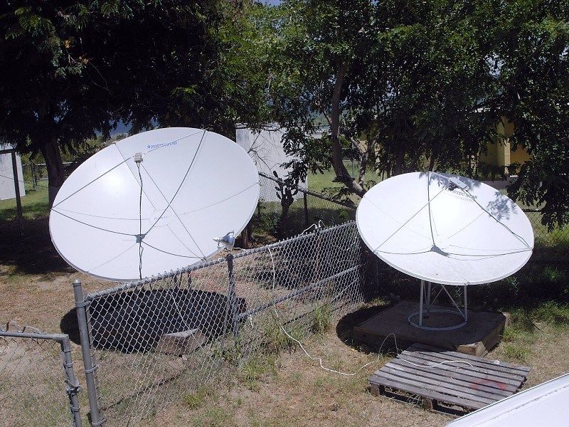

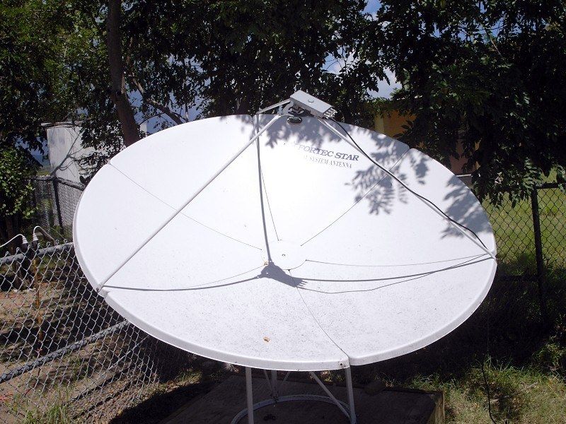

1 8ft prime focus dish pointed to the 101* (I receive all the channels I subscribe to)
1 6ft prime focus dish for the 95* (To receive the Filipino channels D* offers)
I am using a Invacom QPH-031 Quad Polar LNB on this dish (http://www.invacom.com/products/qph_031.htm)

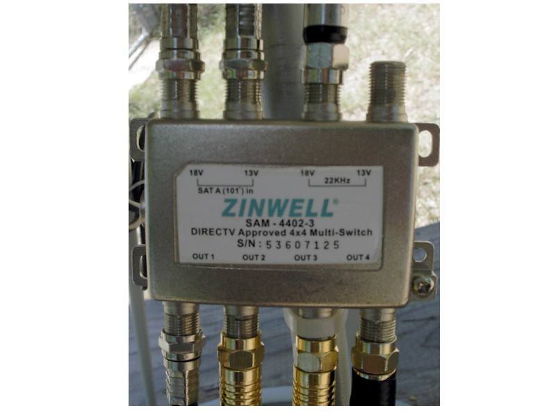

1 Zinwell 4X4 multiswitch model SAM-4402-3 (http://www.zintech.com.tw/Product/LNBF/Switch.html)
1 D10-300 receiver that has already been programmed for the 101* and 95* (My wife sent it to me from my house in the states where we receive the Filipino channels also)
Does anyone know, with my current setup, should I be able to receive the signals from 95*? I was looking at it's footprint and I am located barely outside it's 40dbW Ku Horizontal Beam and between it's 44dbW and 46dbW Ku North American and Puerto Rico Beam (http://www.panamsat.com/global_network/galaxy3c_ku.asp)
Is the 6ft dish to small for the 95*?
Does anyone know which two ports on the Invacom LNB are for Linear polarity? Currently I am using the first from from the left when standing in front of the dish and the LNB ports are facing down.

It seems to me, though, like the 6 foot dish is plenty big enough. Don't they use a 36" dish for that satellite?

Don't know which one but this might help.
  • invacom-test-report.pdf
that did help with making sure i am on the right connector. the LNB i have i borrowed from a friend and the plastic case was missing.

You may need a bigger dish, or get a separate one for the 95. Then you would have three dish's.
However, the maps are just estimates with their spotbeam locations. If you show up "just outside" the spotbeam, you may still be a few miles from it, and not get anything.
I hope this helps you.
