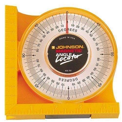

G10 can be found easy. The problem is we get anxious and do stupid stuff which causes us to move the dish right past it. It happened to me too when I was putting up my G-10 dish. I thought I knew better and wound up way off. So I reset my elevation placing a yard stick from the bottom lip of the dish to the top on the lnbf. Then I put my inclinometer on the yard stick and set my elevation angle exactly to what my satellite calculation program on my computer said. Then I slow moved the dishes azmuith and bang it was there.
The moral of the story is when you get lost... reset everything back to static and go from there. Hope this helps :)
Great tip! I went to Amazon and found this angle locator:
Amazon.com: Johnson Level & Tool 700 Magnetic Angle Locator: Home Improvement
And guess who wrote the first customer review!
Excellent tool
We use this for satellite dish installation, and we are very please with its quality and durability. It is not like the cheap imported models. This is much more precise and the scale if very easy to read. We highly recommend it to all of our dish installers. For the price and quality, it is a 5 stars no doubt.Best regards
Sadoun Satellite Sales
