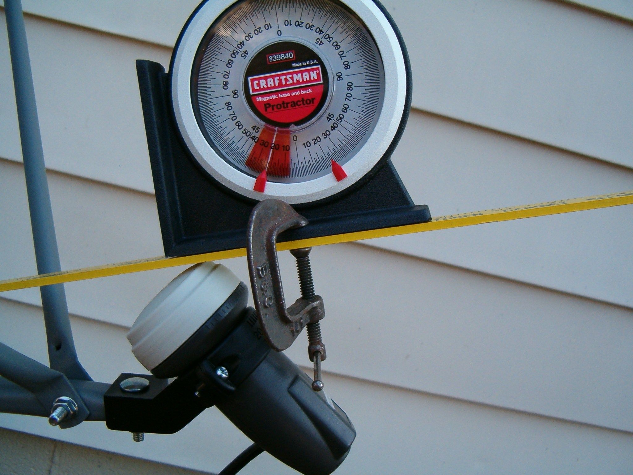

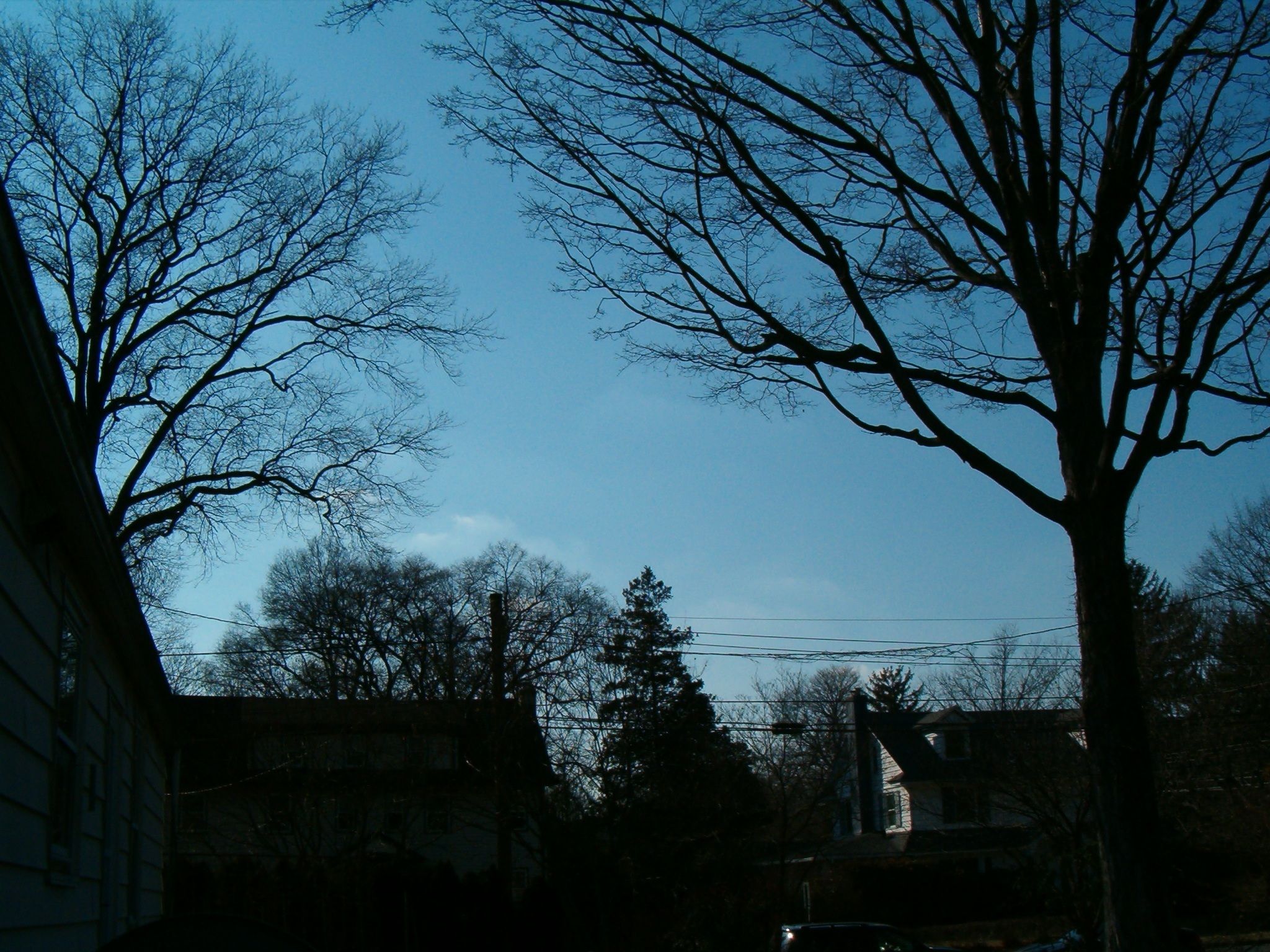

Finally figured out a spot where I could see G10. The first picture shows what I was dealing with, a big ole oak tree across the street and a big maple in the neighbor's yard on the right. That little patch of clear sky in the middle is where G10 is. With my homemade inclinometer I figured out that those trees in the distance in the middle of the picture were low enough that I could see over them.
I ended up buying the Sears Craftsman angle finder in the pictures. What I like about this one is the little red markers that slide around to mark the angle you want. The elevation indicators on the dish just aren't accurate enough. Without one of these angle finders you're flying blind, IMO.

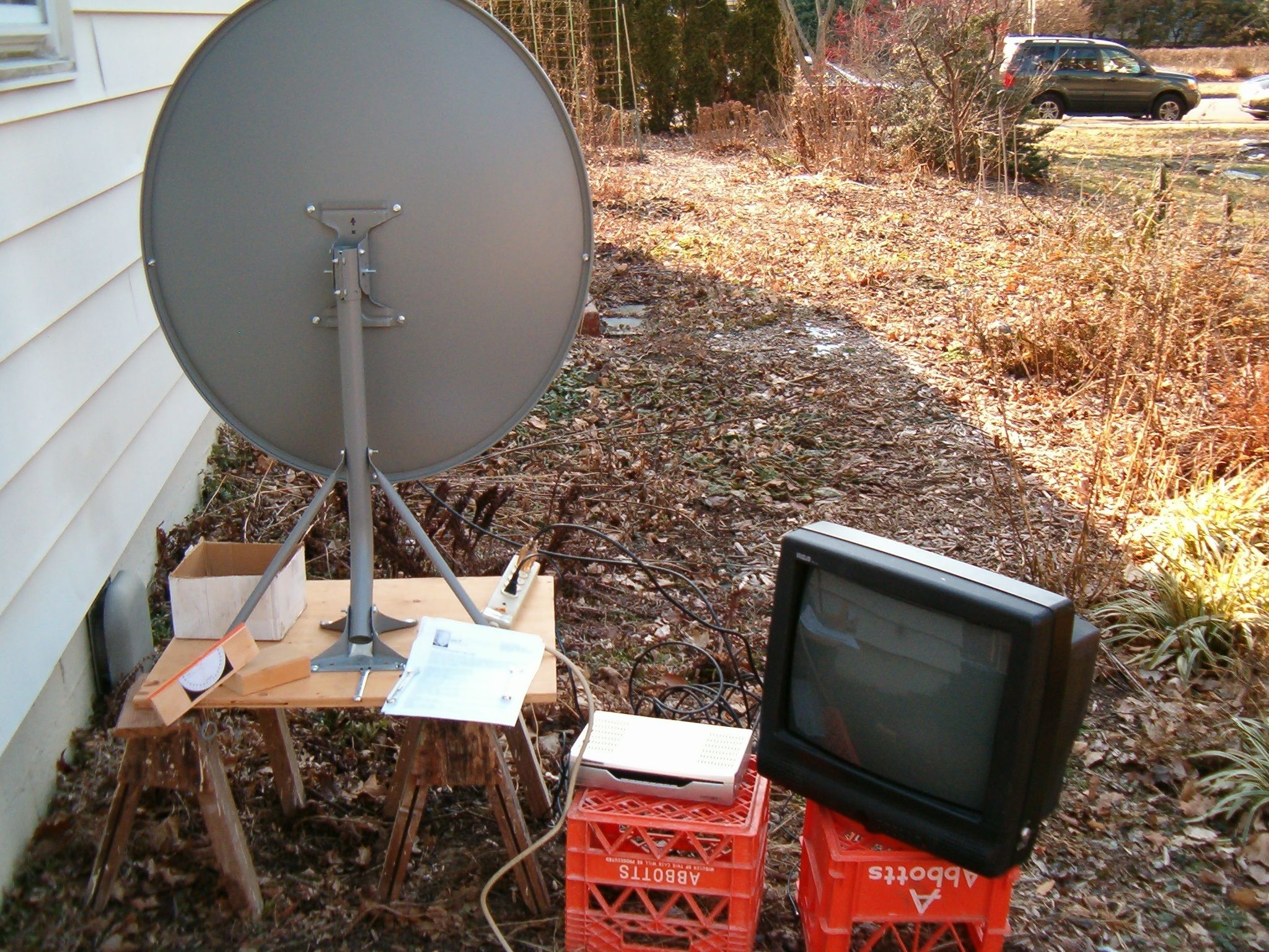

The last picture shows my lashup setup on the ground. Since I was right next to a window I passed the cable into the house and actually watched sat TV in a warm place for the first time.

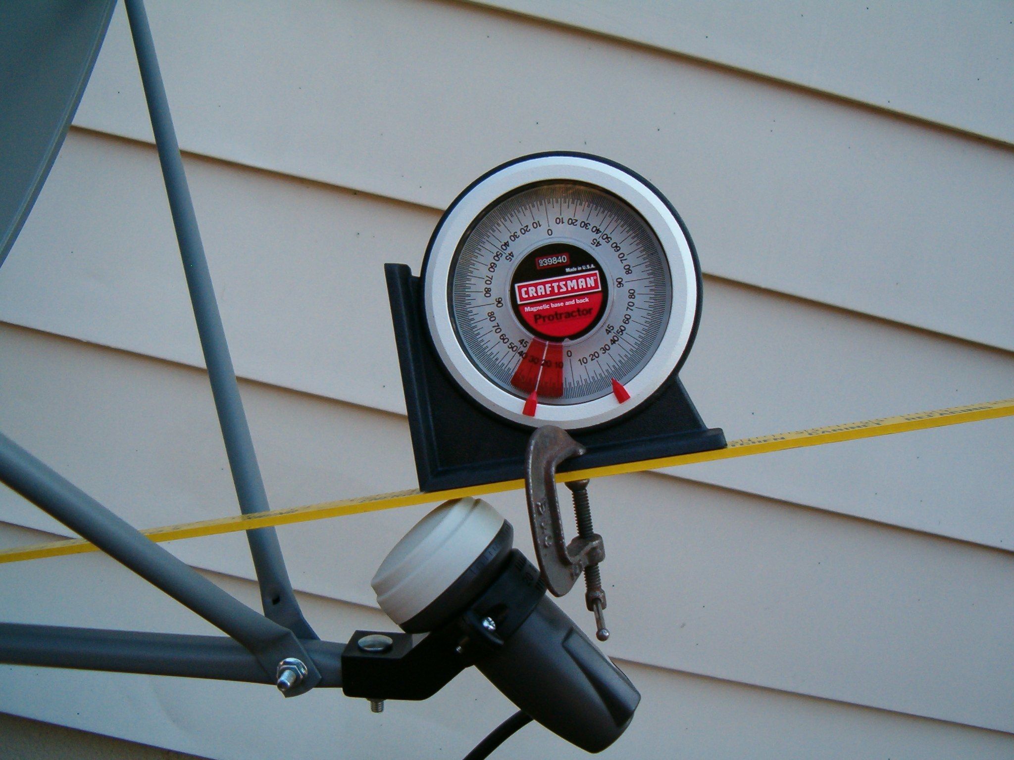

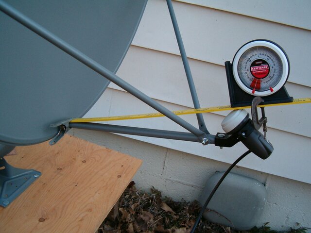

... So I reset my elevation placing a yard stick from the bottom lip of the dish to the top on the lnbf.
Then I put my inclinometer on the yard stick and set my elevation angle exactly to what my satellite calculation program on my computer said.
Then I slow moved the dishes azmuith and bang it was there.

By using my method it will get you pretty close in the ballpark. The markings on my G10 dish are off so I can't go by them. That method worked well for me. It gives you the approx 22 deg offset.
I see what your saying and are correct that certain variables can give you false readings, although it should get you closer than just sliding the dish up & dn and back & forth. :) So I guess I should ammend my instructions that you may have to slide the elevation up or down also a little bit to lock on bird. The LNB dish combo I used it was close enough to get the quality meter singing.:up

When I first tried this (on G25 yesterday) I didn't remember the description of the method correctly and put a straight edge across the reflector from top to bottom. That didn't work AT ALL and I realized that gave a totally different angle than what was on the elevation marks. Next I ran the straight edge from the top of the dish down to the LNB and that worked and for some strange reason gives the same angle as you get when you go from the bottom of the dish to the LNB. Today when I was trying to get G10 the dish was mounted on plywood up on sawhorses which I didn't make much of an attempt to get really level (I did put a piece of wood on one side to shim it up to where it looked approximately right) - the point being that there was no reason to think that the elevation marks on the dish were even close to being right. So using this yard stick and protractor method will get you close enough to get signal, which is most of the battle. You still have to tweak it from there, in tiny little increments. For the elevation I just leaned on the dish a little up or down to see which way to adjust it - it was just a tiny little adjustment needed from where I had set the elevation originally.
The way I have used an inclinometer, is by using the offset degrees of the dish (Azure Shine 90cm is 24.6°) subtracted from my desired elevation and using that number for the front of the rim of the dish. So if I wanted 33° elevation I would take 33°-24.6°=8.4°. On my inclinometer, vertical reads 90°, so 90°-8.4°=81.6°. I set the red marker to 81.5°, stick it to the front/side of the rim (using the magnet) and I am ready to set my elevation.

WescoPC's description is very clear, and should get you right on the money.
If someone would add a picture of how to hang the inclinometer to the edge of the rim to demonstrate it's position, I'm sure it would help everyone.
Note: this only works on dishes that don't skew.
