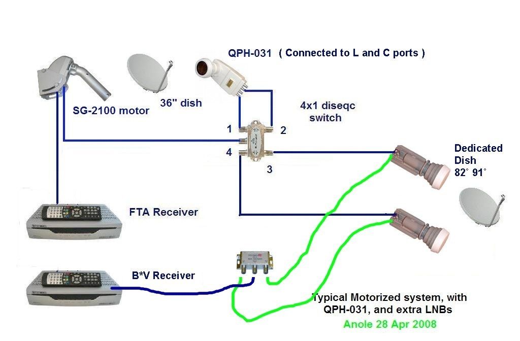

Hey! Thanks for your help! Please check out my modification of Anole's original drawing. Does this look right?
In your diagram the BEV receiver will only be able to exclusively use the 82/91 dish when the FTA receiver is in standby mode. That is assuming the BEV receiver could switch the DiSEqC ports to find the right LNBs. Otherwise it can only use the same polarity signal that the FTA receiver is using when it is on. So even if the FTA receiver was using the 82 or 91 port you would only get 1/2 the transponders.
Ideally (meaning more $$) you would have 2 dual output LNBs on your 82/91 dish and run that into a 4x4 multiswitch. One port on the 4x4 going to the BEV and one going to the DiSEqC switch. This way the BEV receiver would have a full time, separate connection with no dependency on the FTA unit. The FTA receiver would still be able to use the 82/91 dish, even though there is nothing really on them in the clear. Though if you scan them occasionally you might find something temporary.
A cheaper option if you have dual output LNBs is to just run one output from each 82/91 LNB to a BEV compatible switch like the SW21 maybe, and then on to the BEV receiver. It really depends on what your 82/91 dish&lnb setup is.
If you list the exact 82/91 dish / lnb combo you're planning on using we could tell you better if it would be something you could hook to your FTA setup or not.

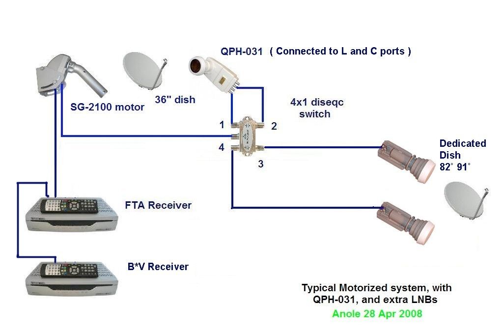

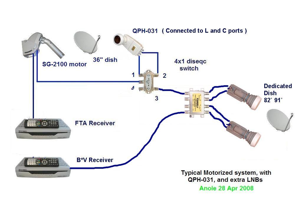

See the two attached (poor) modifications to your modified diagram. Showing with a 4x4 multiswitch or with a 2x1 Dish style switch.

Is there anything special I need to know about the 4 x 4 multiswitch?
Bell recievers do not control 22kHz switches so a 4 X 4 won't work. Leave the Bell on the bell dish and run the FTA box with the qph 031. If you want to listen to the very few radio channels that bell leaves unscambled on your FTA box motor to the sat and use the C port on the qph.

Sorry, I misunderstood drawing no 1 in reply by Gillam. His schematic has a multiswitch in the layout. I'll stick to drawing number two for setup. BExpress separate dish.
That multiswitch layout was for a 4x4 switch that your system supports. I was assuming BEV is using dish legacy or dish pro hardware and you would be able to use a dish 4x4 equivalent. dpp44 for example or 3x3 dp33.
Regardless if the BEV won't switch 22khz and the FTA doesn't switch BEV/dish 21khz, you can't really interconnect them with a multiswitch. Just use the 2nd diagram with dual output LNBs.
Again, we could give you more specific if we knew the exact dish / LNB setup, but basically it is easier to just leave them separate. I'm not even finding any radio/music channels on BEV at the moment so it seems there is no point to interconnect right now. Maybe when Christmas gets into full swing we'll see something again.
