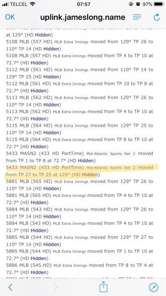

I was checked at Dish uplink report, and i found this important info, apparently MASN2 channel is available on 129W, transponder 25.
Please tell me if i'm wrong with this info.
I looked further into that and it would appear to be there. If you receive it it will be on channel 412-23.

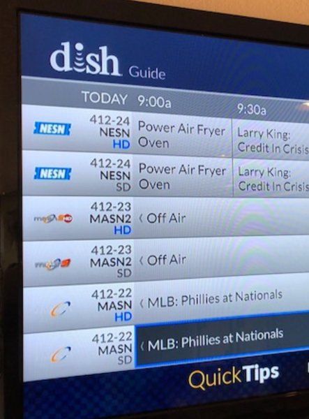

I have a friend in Houston, and he got a picture of his channel guide, and both channels was there.
Look..
Hi crodules, actually i have my dish service in Sacramento, CA.
Do you think NESN and MASN channels are not available here?
Look..
Yes, I have the same channels in my guide, but I have had Multi-Sport for well over a year. There were posts earlier this year from people who had recently added Multi-Sport, complaining that they were not getting those channels. It is unclear whether this is a case where you have to be grandfathered to get those channels outside of their markets, or if it was just some technical glitch. (Or, for that matter, it is unclear whether that technical glitch ever got resolved, since we have not seen any other complaints about not getting those channels recently.)
