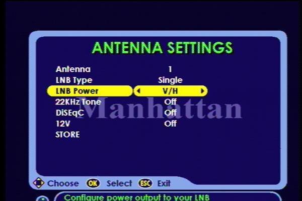

Hey Brian, I have an older 36" dish with 3ABN stamped on it. Can I have more than one lnb to it? Also, did you find anything out on turning on the power for the lnb on the manhattan?

I have attached a JPEG showing the correct setting for the LNB Power: H/V. If you are still not receiving power to your meter or voltage tester, the receiver will require repair or replacement. We are not aware of anyone providing repair services for the Manhattan products as the original company went bankrupt about 6 years ago and parts are no longer available.
