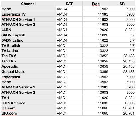

I've added a picture of a spread sheet showing some of the channels that I picked up with the power scan on the fortec. What is strange to me is that I never got a level or quality signal on either of the receivers and the only way that I found the channels was to do the power scan on the fortec. Iceberg said that I should be getting a maxed out signal on 3abn; I have a 99 quality signal for the 3abn channels so I don't know what the problem is. When I switch over to the Manhattan it won't pick anything up. Unplug it and plug the fortec back in and all the channels are there.

The channel frequencies that you scanned in with the Fortec appears to be 100MHz off. This makes me think that either you have either an Universal type LNBF (maybe a UL1?) or the LO type has been selected in the Fortec Star to be Universal type with the LNBF frequency is set to 9750/10600.
1. Is the LNBF is a GEOSATpro SL1 (Standard type) and not a GEOSATpro UL1 (Universal type)? (Look at the LNBF label)
2. What is the LNB LO Frequency setting for the Fortec Star?
Do not use the frequencies that you scanned in with the Fortec Star. They are NOT correct. Please use the frequencies in the thread that I provided last evening.
