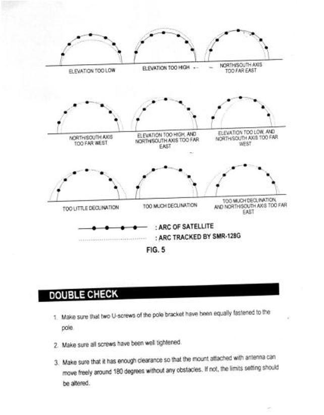

Please follow the picture below so you track the arc correctly.
It takes training, but you will get there by time.
very helpful info indeed :)
printed that one out
