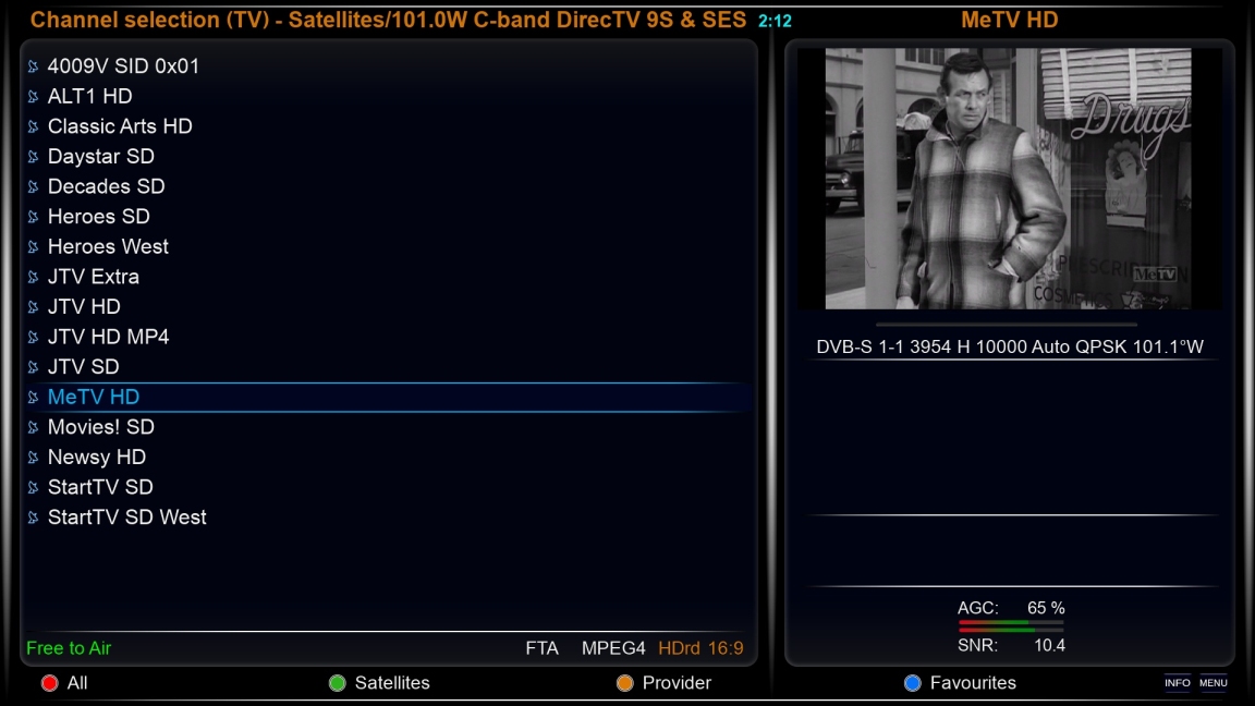

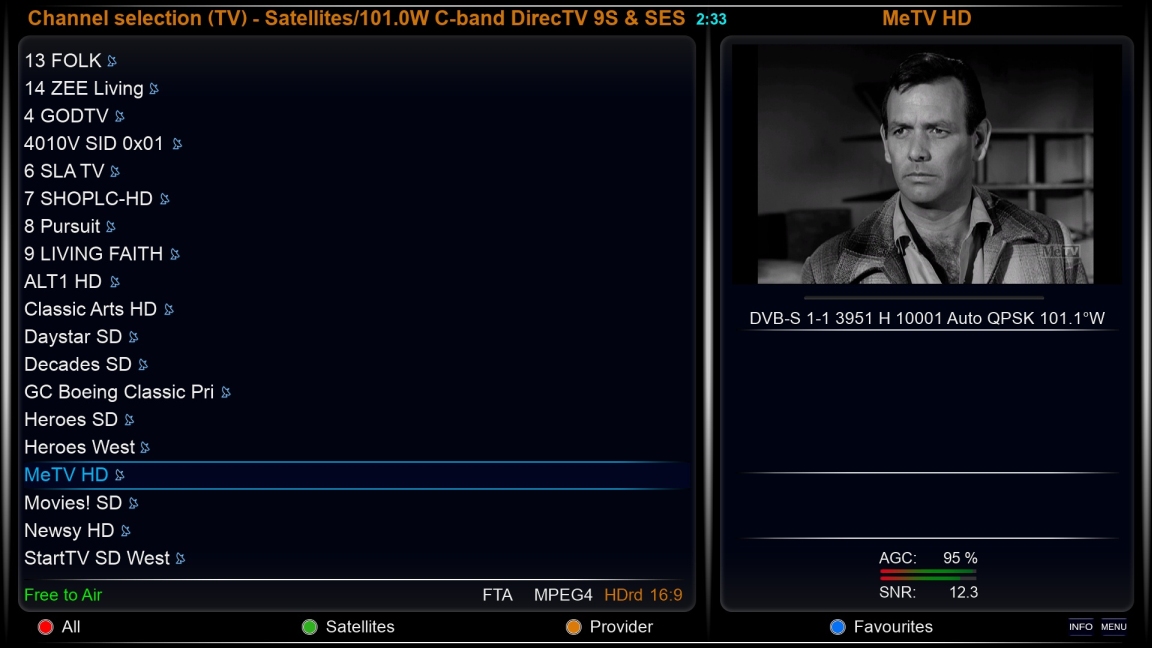

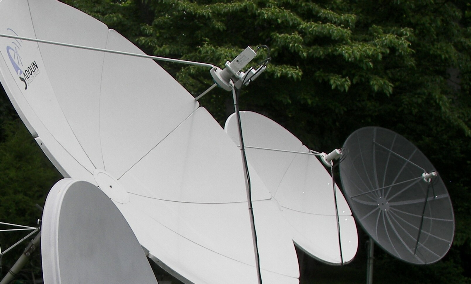

Attached is a picture of some of my dishes and two screen captures I just made, one from each of my Edision os mio 4K receivers. The 8ft picture is from the Sadoun 8ft 9 section dish with a dual ortho feed. The 10ft picture is from a 10ft Channel Master mesh dish I'm still working on that has replaced the 6ft Sadoun dish in the picture. I took the Titanium C2WPLL lnbf from the 6ft dish and put it on the Channel Master.
All my Amiko receivers from the oldest to the new Mini 4K UHD S2X also play MeTV without any problems when switched to one of the C-band dishes.
