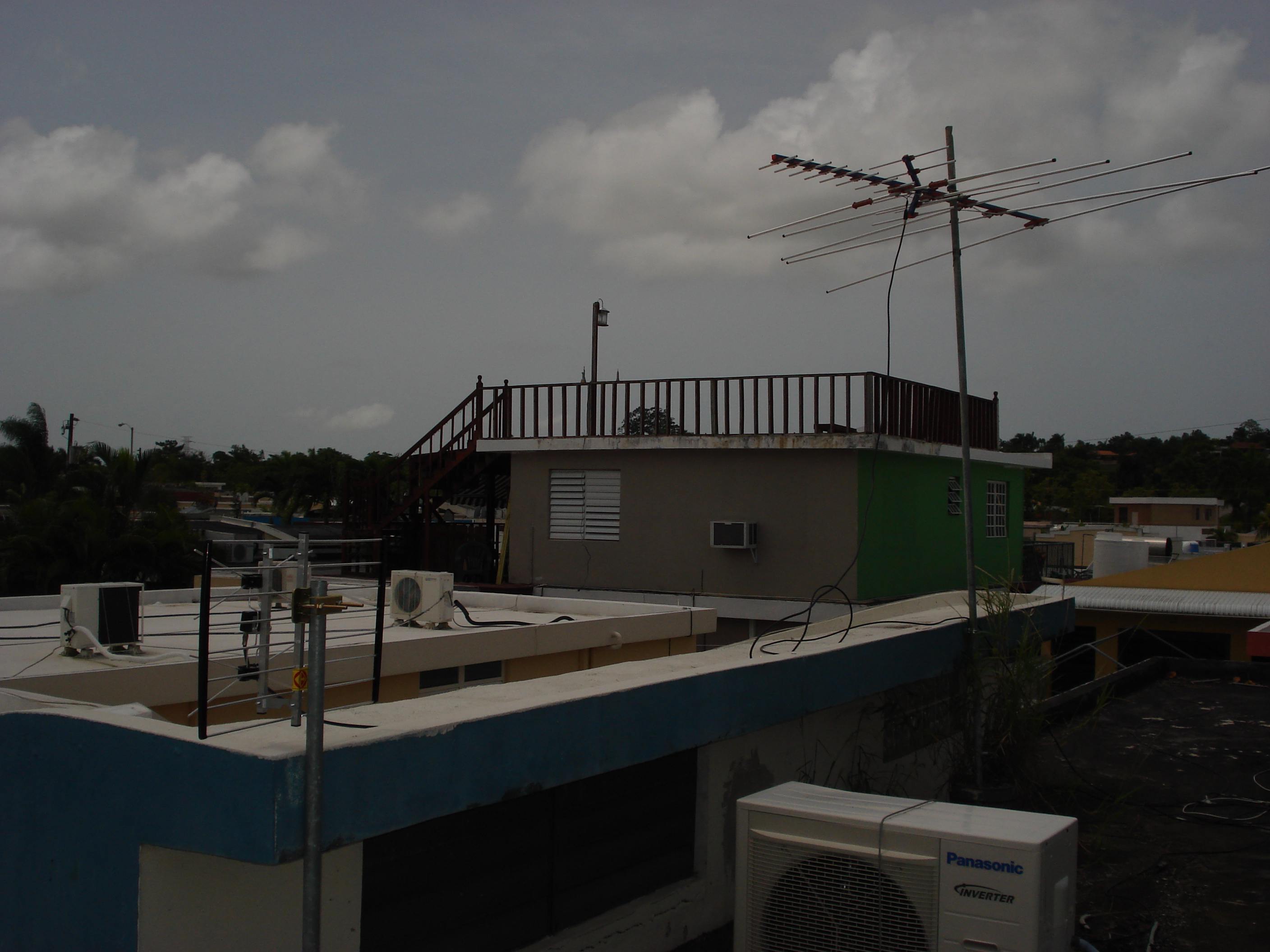

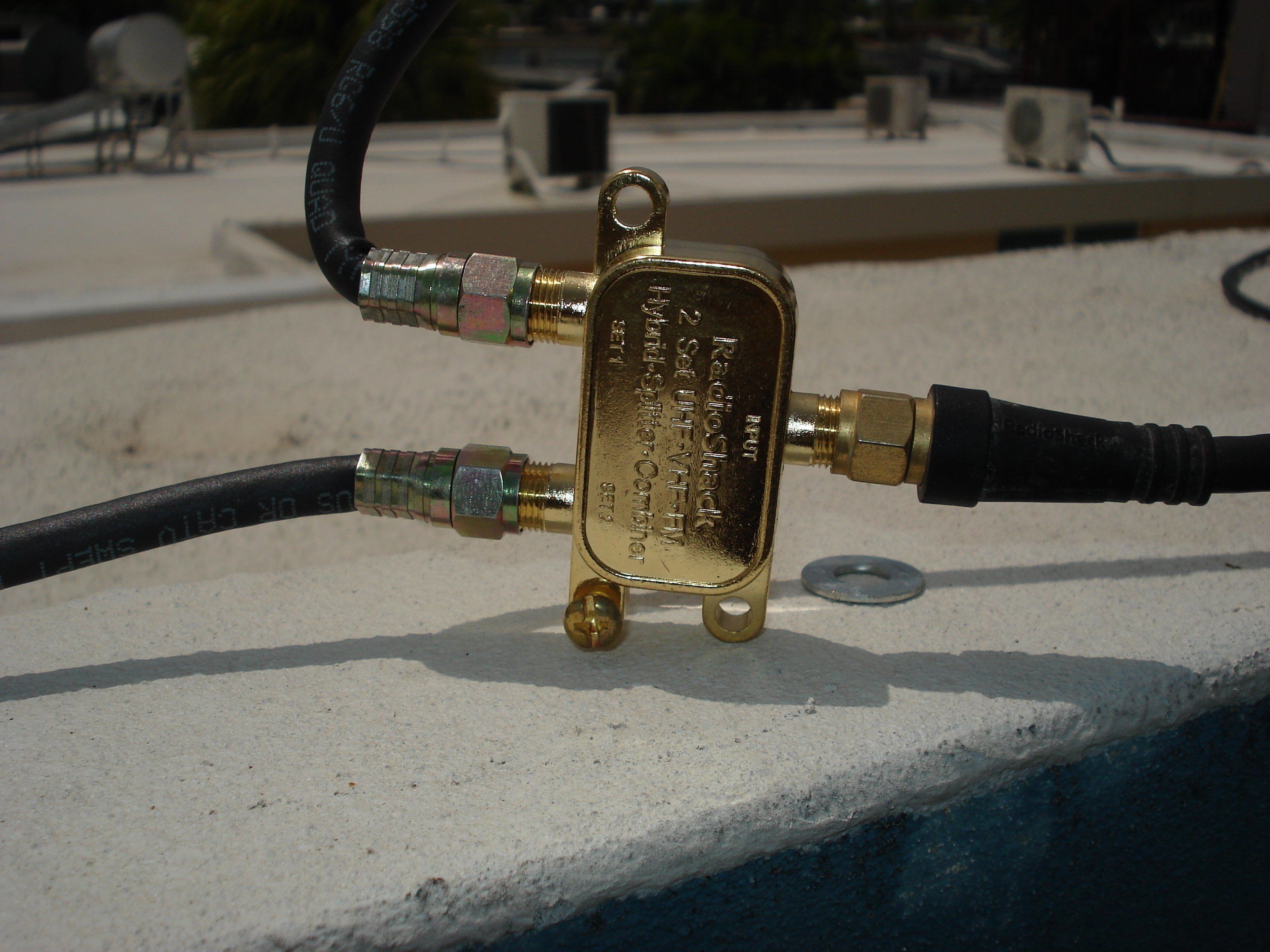

this is what i did with a 6 dollar splitter and 1 vhf/uhf antenna and 1 uhf antena works fine for me here in Puerto Rico almost all tv stations are south except the ABC afiliate wich is west. aprox 120.00 total

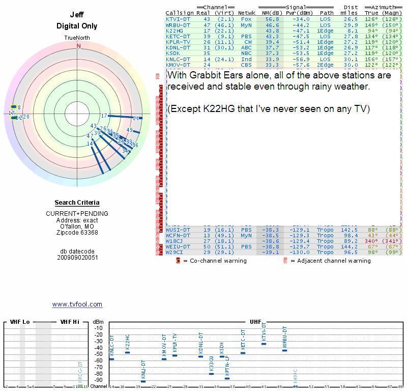

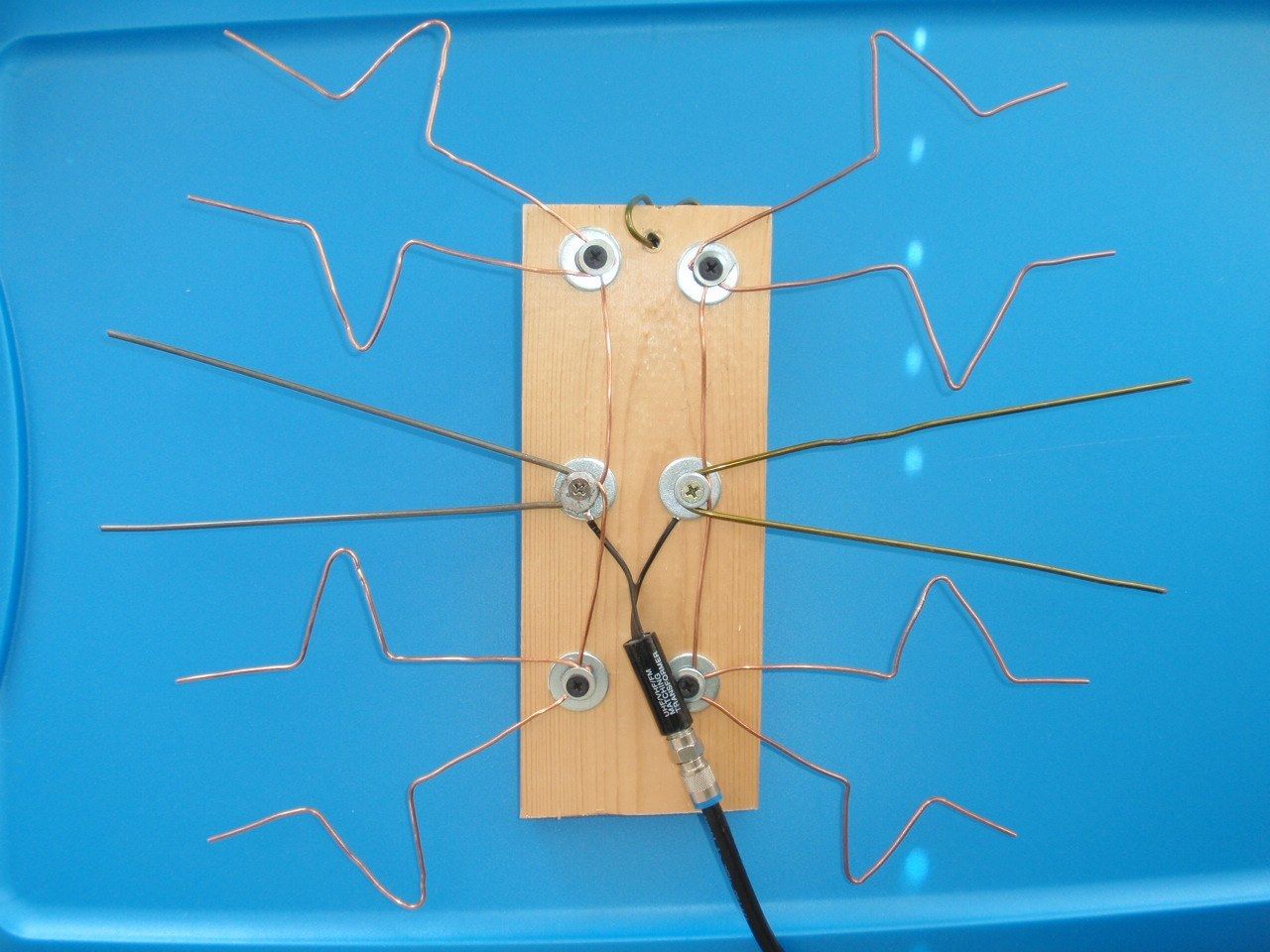

I believe you can get what you want with this homemade antenna:
GrabBit Ears
I tried this setup since my wife hated the coathangar antenna. I only spent about 45 minutes on it, so the signal coud improve (I'm guessing). I went down about 10% signal over the coathangar method that I had tuned the best I could get it.
The main reason the 'grabbit ears' are going to stay is that I was able to make it small and light enough to hang on the back side of my blinds so they are virtually unnoticable. Thanks Jeff! Maybe I'll experiment when I get some time and try to get a better signal.
Your welcome, bebop! One of the great things is the small size. I was originally thinking of truckers and RV'ers because it is so small and light. (That's why I made the one on the back of a clipboard - so it would have a stable back and would hang on any vehicle window.

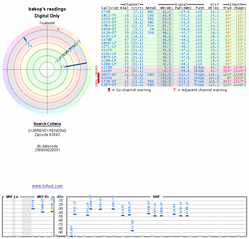

Would you post or send me your TVfool for reference?
What are your signal readings?
I could make mine lighter and better looking if I took 15 minutes, a white clip board and some nuts and bolts.
I made the youtube coat-hangar antenna with a 2x4 at 32".

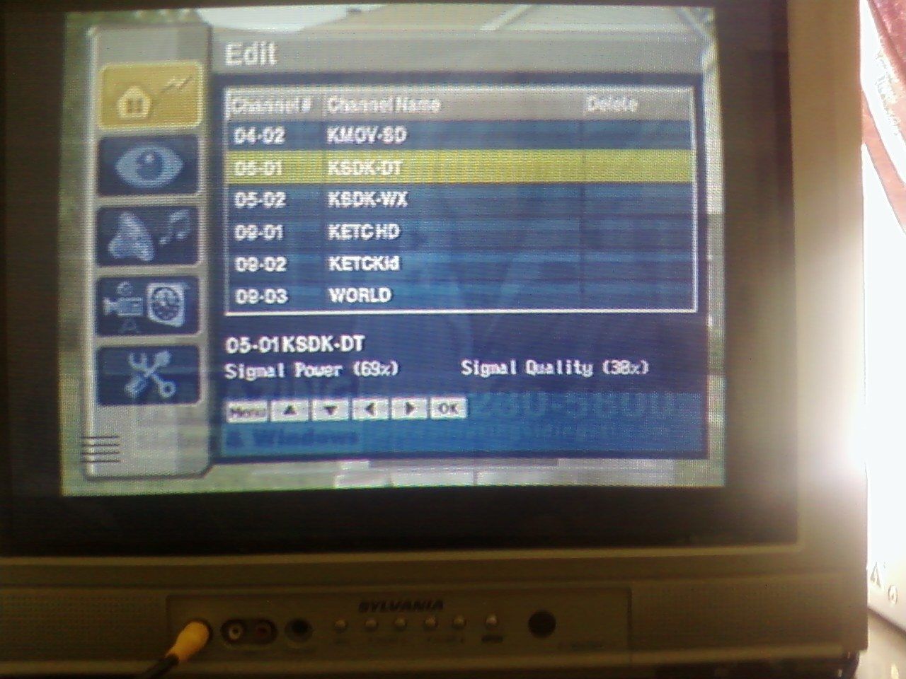

Signals are upper 60's to lower 80's when I checked last night. Here's today's signals:
  • Channel 2, 4, 9 & 12 are in the low 70's
  • Channel 6 is no signal :(
  • Channel 7 is 94
  • Channel 39 is in the low 60's and cutting in and out (and I never watch it).
I attached my TV Fool readout and a shot of the antenna I made. I drilled a hole in the top and instead put a string in it and hung it on the window with a suction-cup.

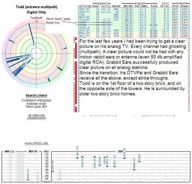

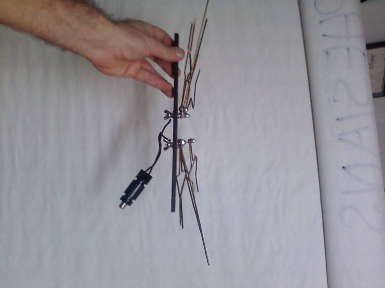

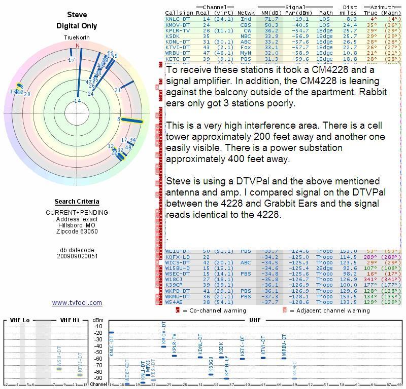

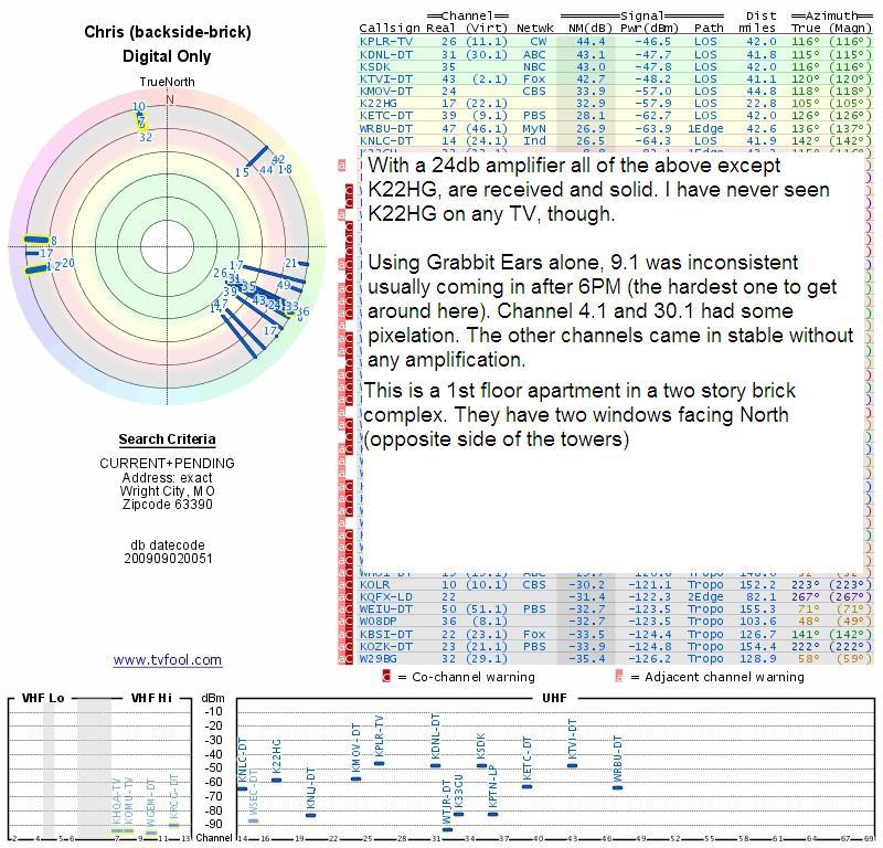

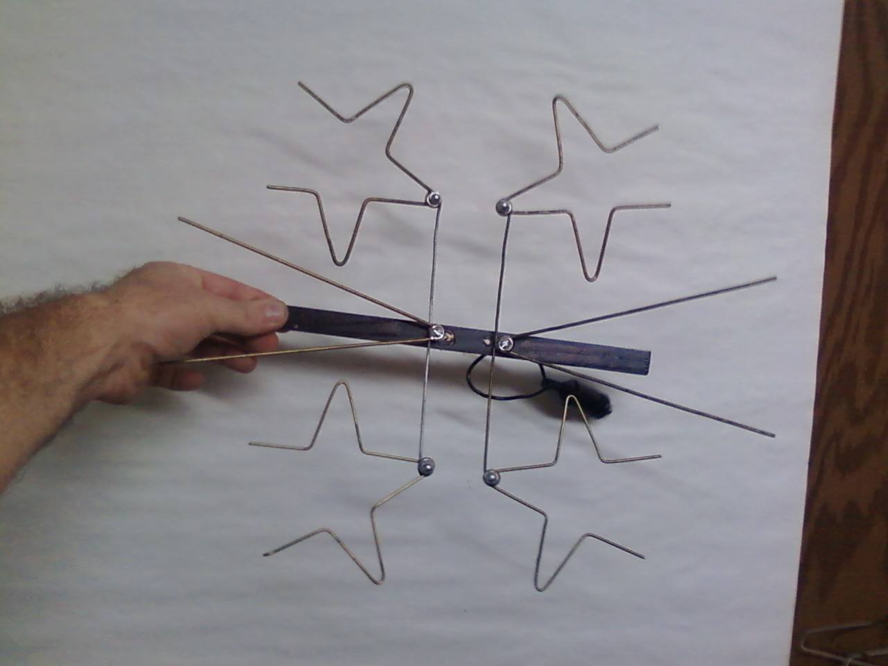

I've started to compare some TVfool projections for a some antennae that are out there and I've changed my mind on you needing an amplifier. The performance of Grabbit Ears out of coathangers far surpasses what you are getting. (I didn't need the amplifier, I used it to see what difference it made. It is in use on the one below that is over 40 miles out.)
Nothing is certain with signal (hot spots, cold spots) but I think you should get all your greens and maybe some yellows.
I have attached 4 tvfools and comments (you'll see when they're full size). I also attached two more pictures of Grabbit Ears. The side view is the way they usually end up (with the bowties slighty raised from the plane of the fractals). They do work completely flat, though. When I put them on sticky paper, I make them flat and they work the same.
