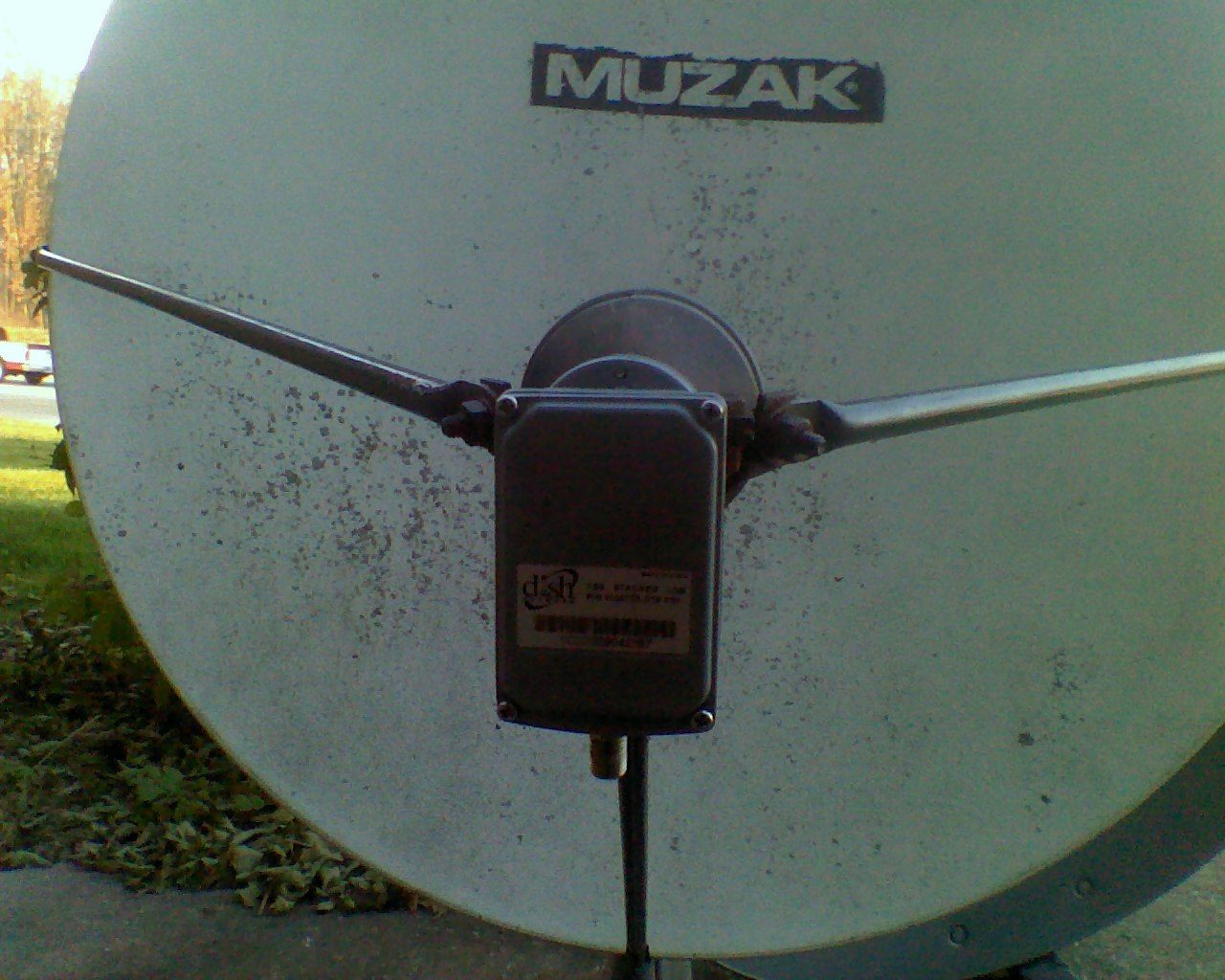

Need info on this dish.

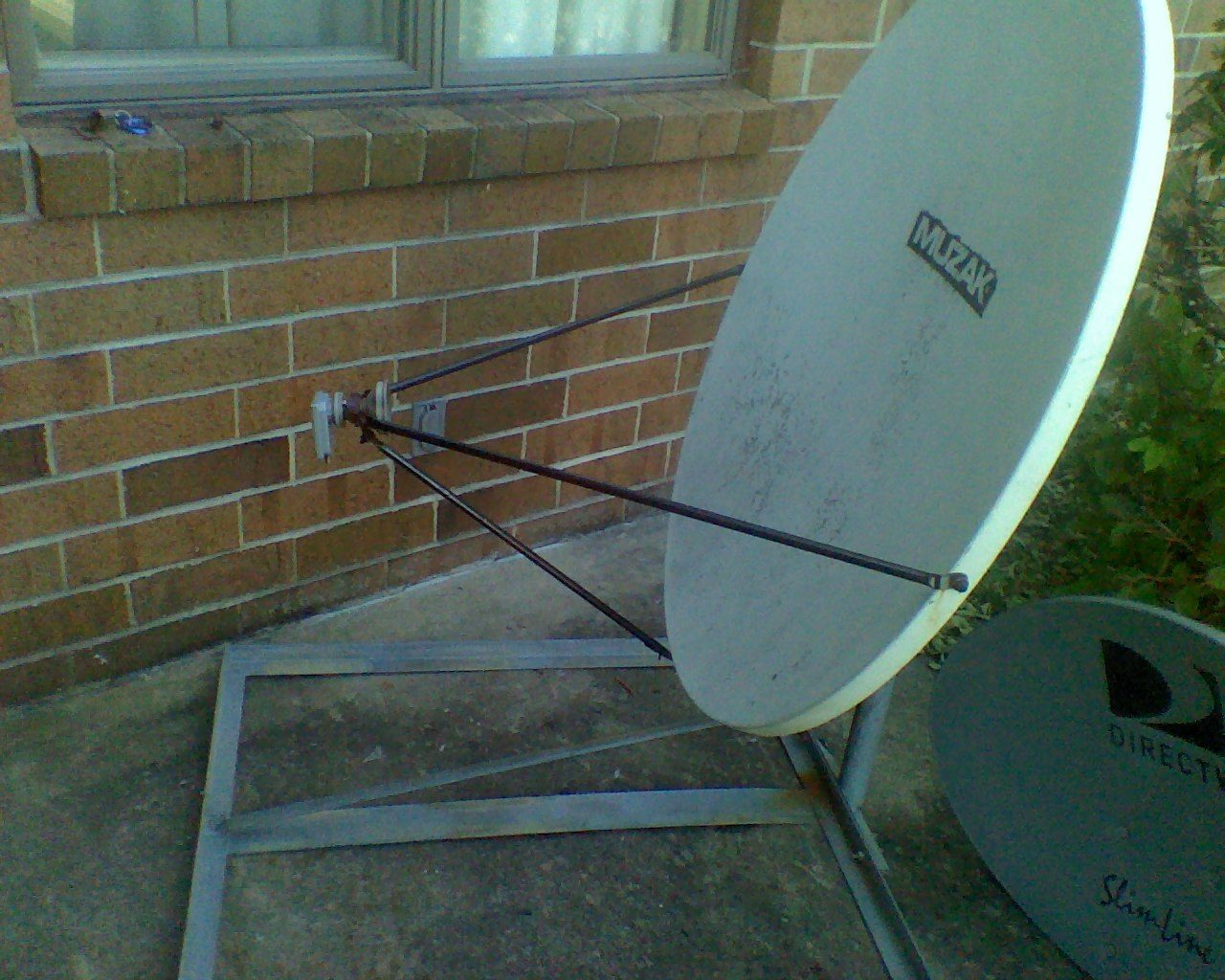

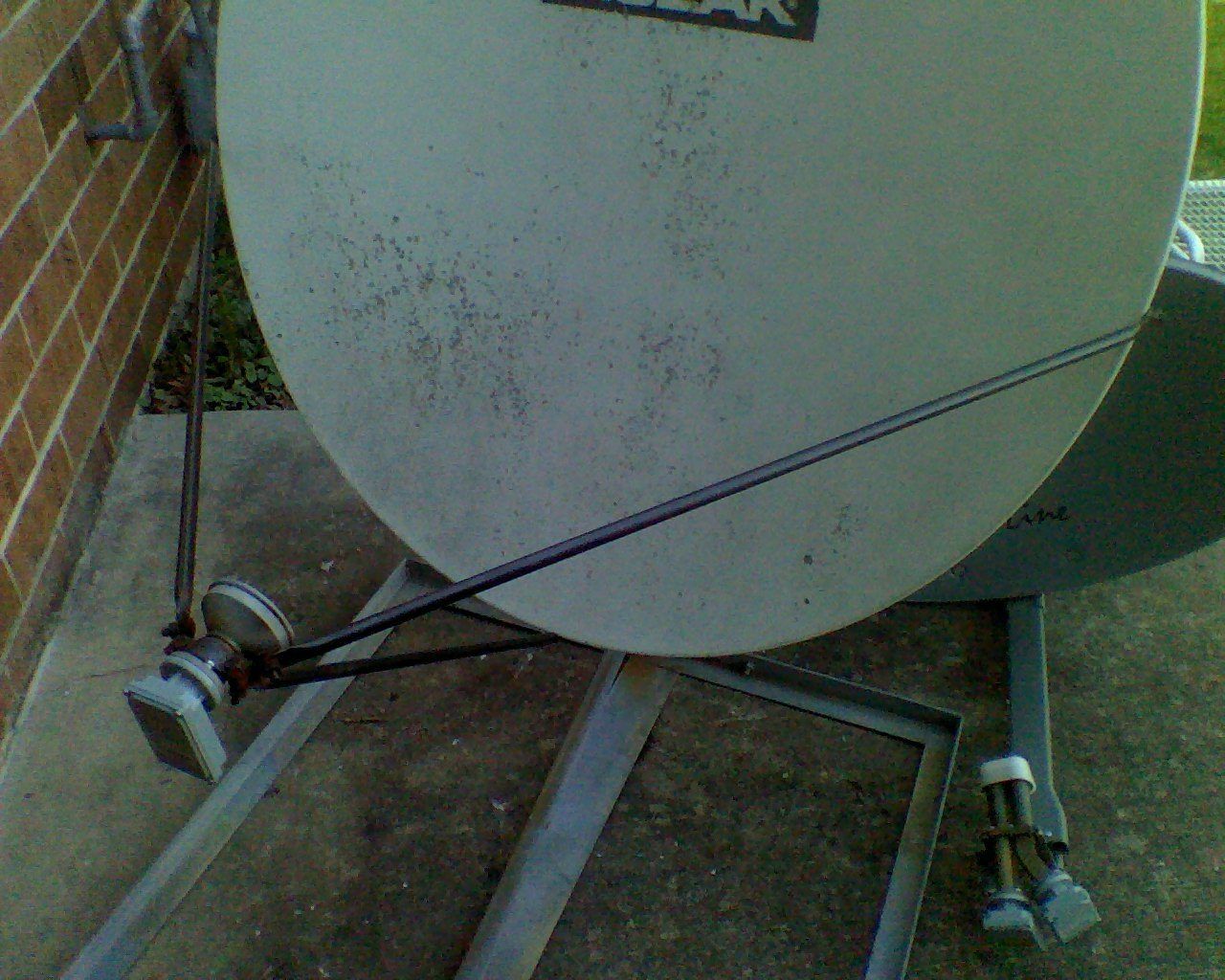

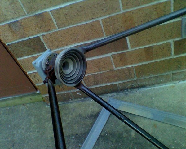

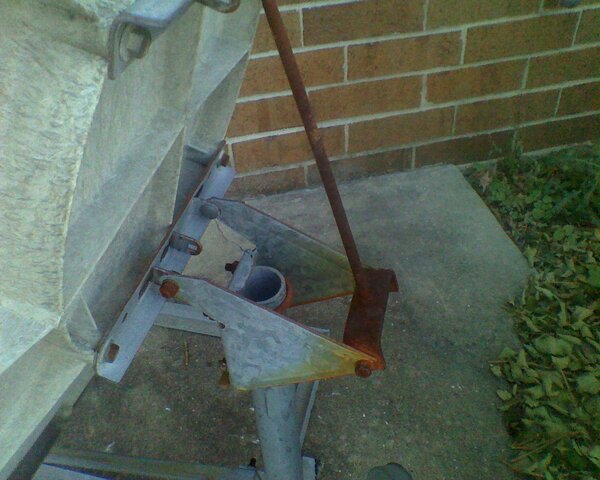

here are some more pics.

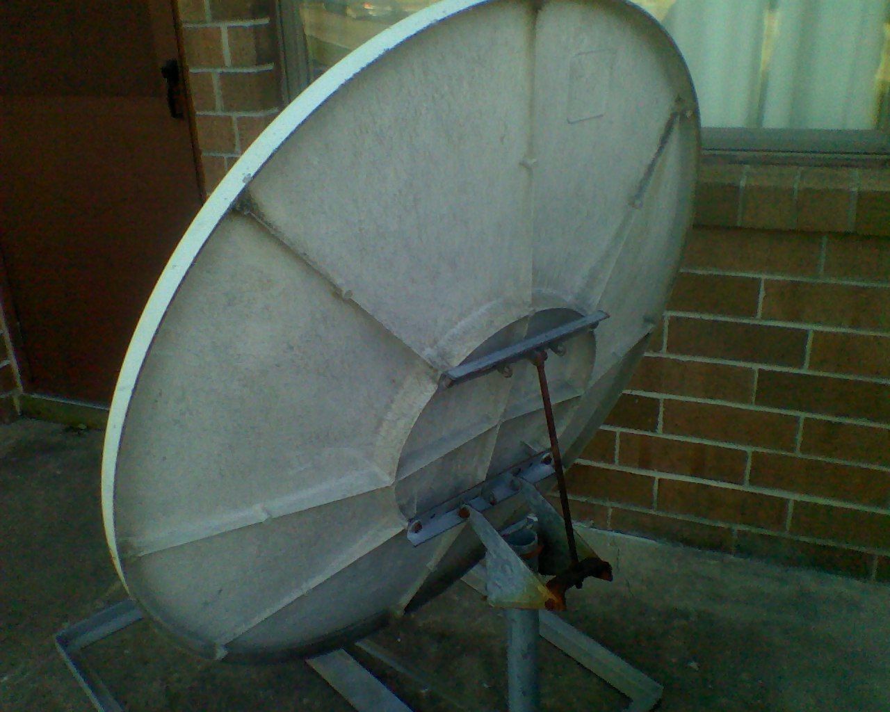

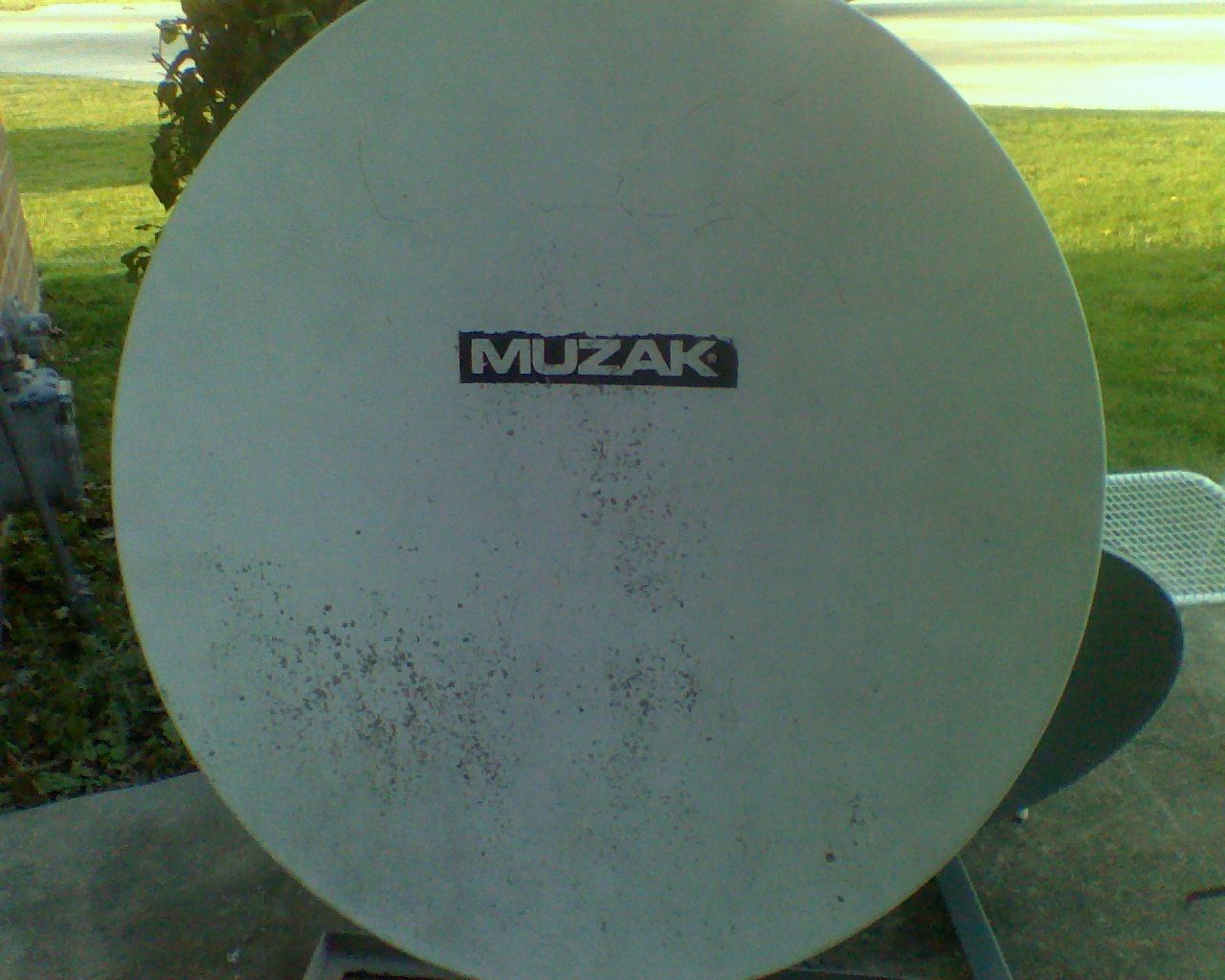

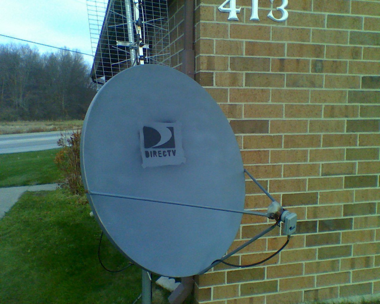

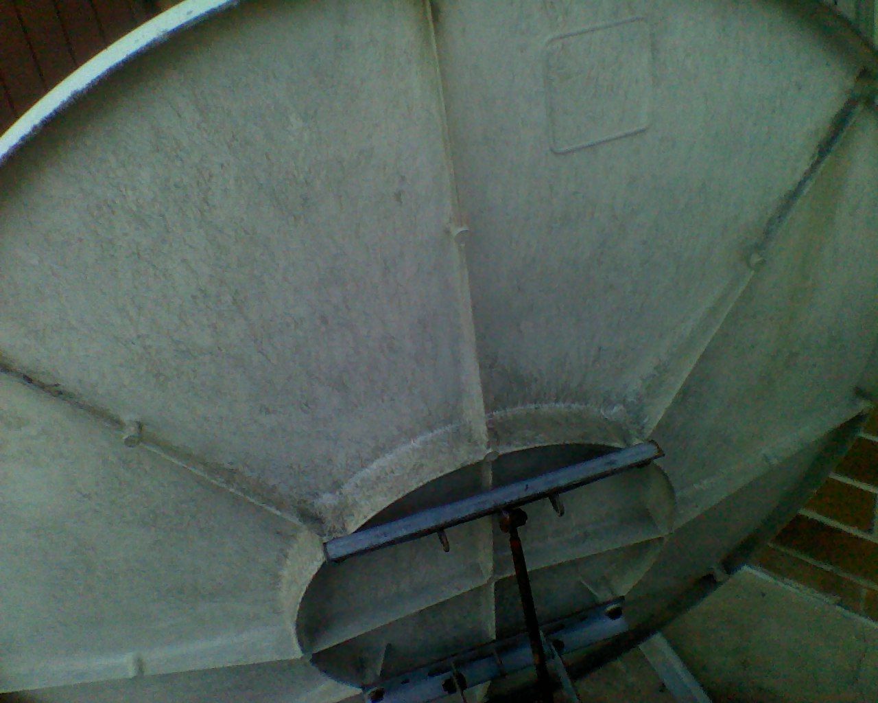

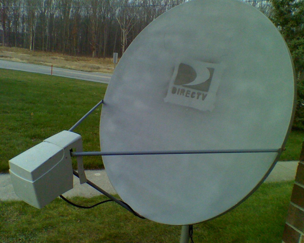

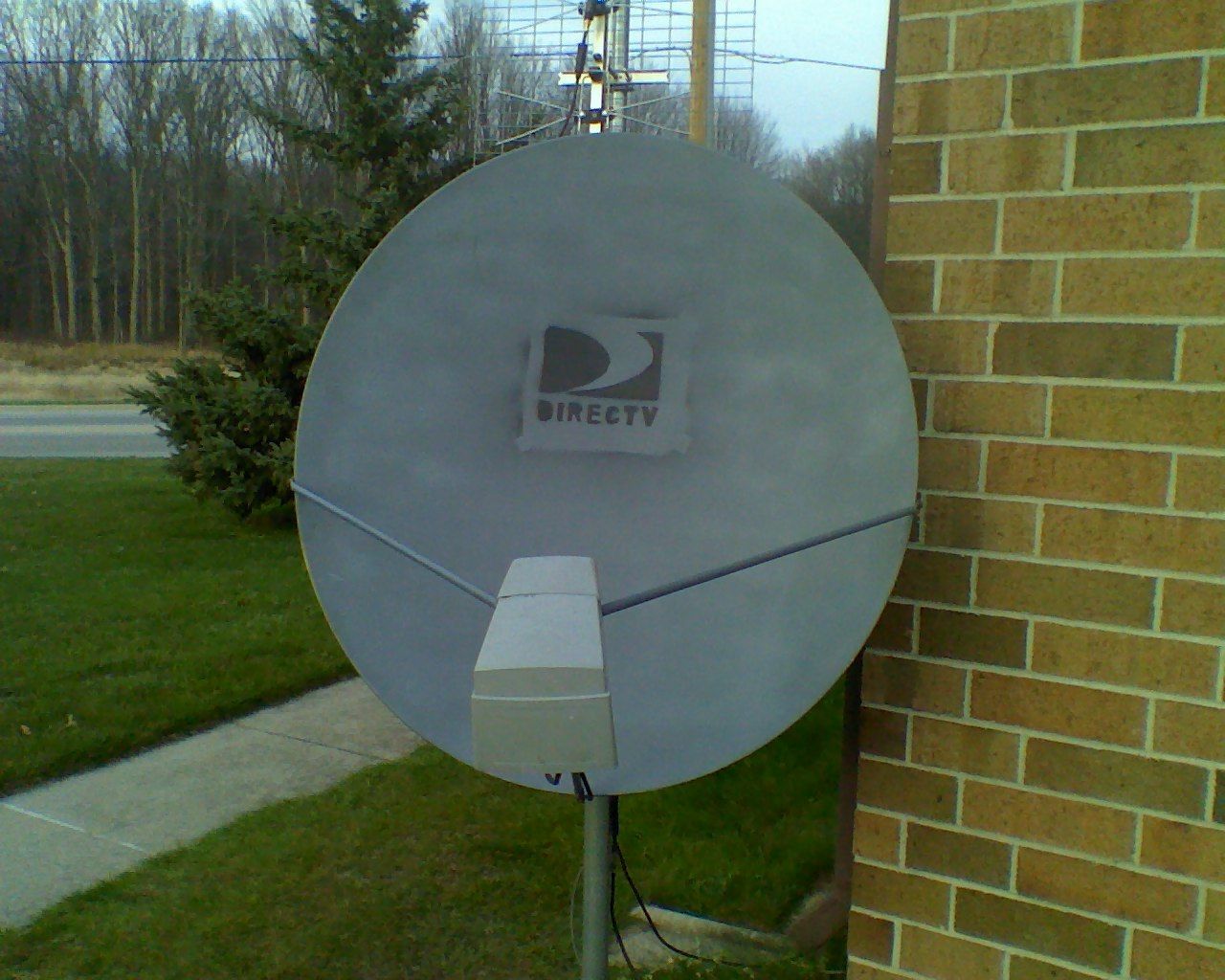

What is the best way to clean up this dish? I want to paint the dish a dull gray like the ones they use on directv dishes any recommend ideas? With this dish how do I set the elevation on this there is no markings on how to set it to the correct elevation?

I just get some kudzit or some good detergent and a pot-scrubber (the plastic kind, you know) and give it a light scrub and rinse. Might take two rounds if its really gunky, then I just get some krylon spray paint and have at it. I get the kind that says "For outdoor furniture and plastics". One can usually will do a 1m dish for me, might take another one if you spray the backside too.
Guess you're going to find the first satellite "blind". I'd probably use a cheap signal meter to get it close to some satellite, then blind scan to determine the satellite. Look it up at dishpointer.com and note it's elevation. Then place a straight edge vertical across the face of the dish. Take the perpendicular of that and determine the offset angle by noting the difference compared to the dishpointer.com elevation.
Maybe put an indicator on the dish that will move along the side of the mount where you could mark a elevation scale.
Another 'tool' that may calculate the offset to get you close could be Parabola Calculator 2.0
Click WIFI Calculations for offset dish calculations.

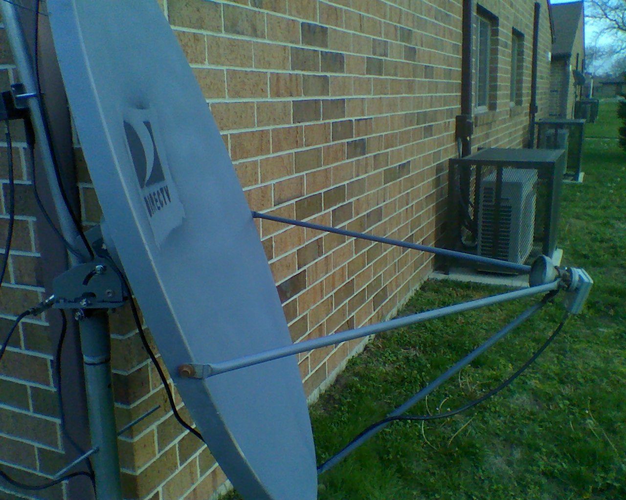

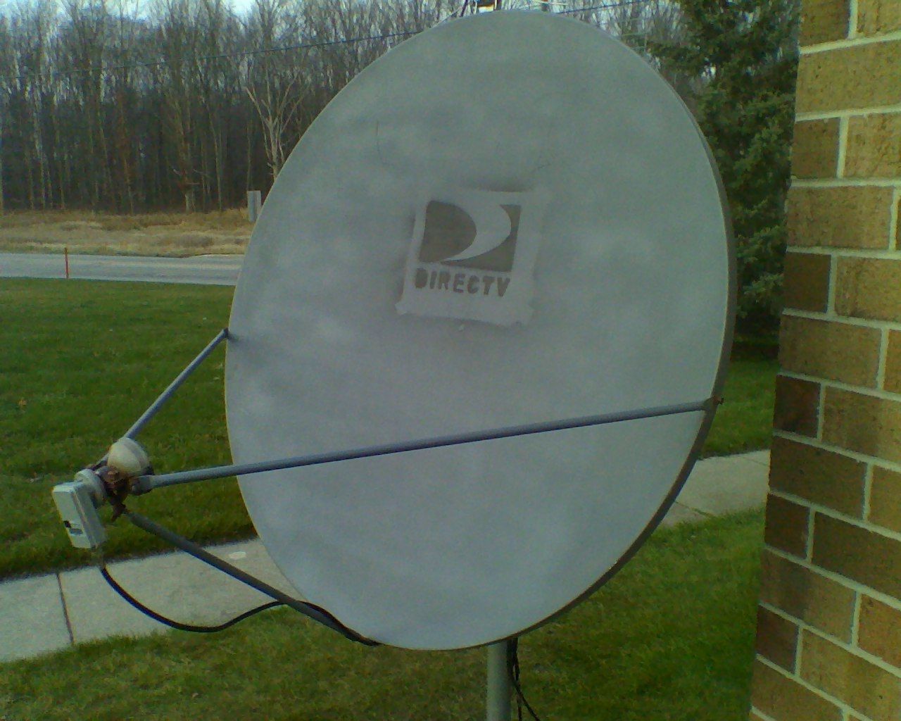

I used a 99-cent can of flat gray primer.

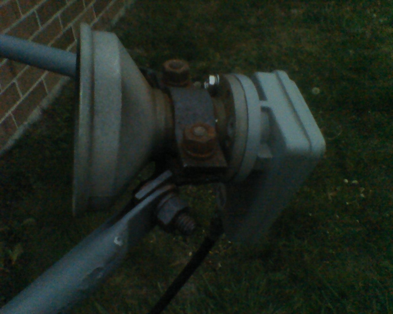

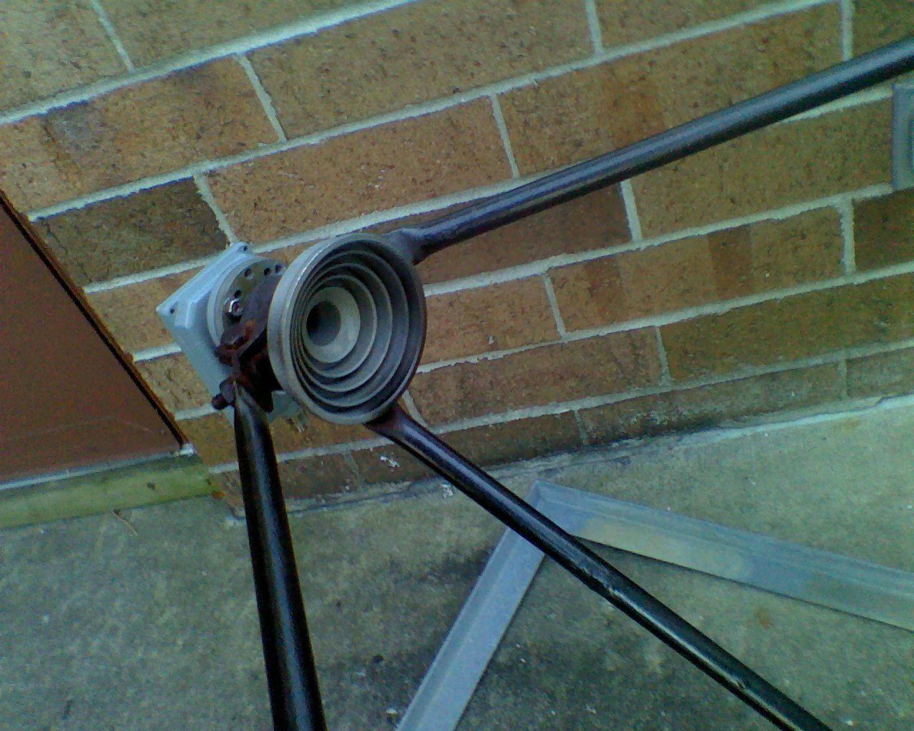

Tap my avatar, then look at the LNB support arms on the dish.
They are conduit with about three or four LIGHT coats.
The plastic-specific paint may be better, but I'm cheap.
Yea, dish looks like Prodelin to me, too.

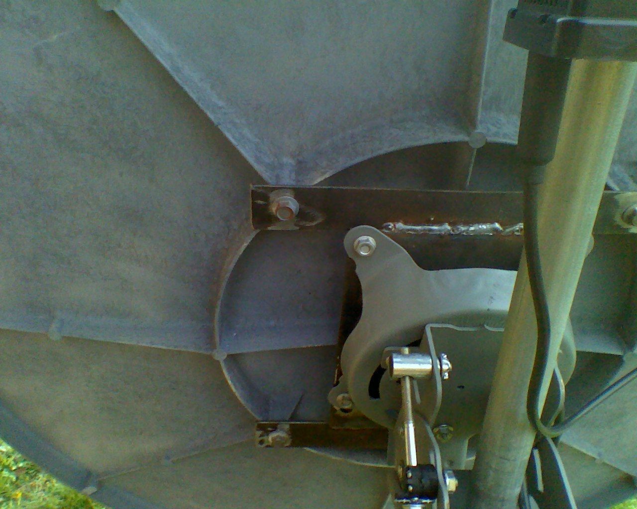

I like the bracket that I got to bolted up to the dish and it looks pretty neat.
