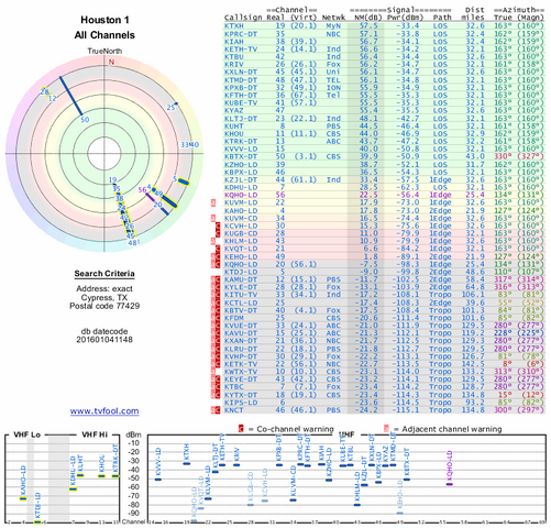

Any recommendations on a good OTA antenna I can get? I think you may have viewed my tvfool report, and I want to add that I am in a slightly wooded area.

Here's his TV Fool report:
This actually looks really good, all those green colored stations that state LOS, should come in with a half way decent fixed antenna outside, they're all in the same direction except KVVV. There's like 19 stations there and with whatever sub stations they carry, you'll probably end up getting around 40-50 channels or so. If you don't speak Spanish, the TEL [Telemundo] ones won't do you much good, but you still have Fox, CBS, PBS, ION, ABC, NBC, etc, pretty nice.
I don't know what to suggest for an antenna, the ones I use would be way over kill for the short distance you are from your towers, but I'm sure someone that knows antennas on here good will comment.

What is the benefit of a multi directional signal?
Multi-directional refers to the pickup pattern as opposed to a different kind of signal. Many TV antennas that work at 30+ miles are more or less unidirectional (uni is Latin for one) and perform best in a 20 degree or so range in the direction that they are pointed. An omnidirectional (omni is Latin for "all") antenna doesn't have a directional nature.
There's that second CBS station (KBTX) that comes from the opposite direction that you might be able to pick up with an omni. Since you already have a CBS station (KHOU) at the 163 degree slot, it probably isn't necessary.
The danger of an omnidirectional antenna is noted in the tvfool chart by the a (adjacent) or C (same frequency) on the left. Both risk interfering with stations in the 163 slot.

Use a compass to aim it to the S.S.E.as shown on the radar map from the TVFool report .
