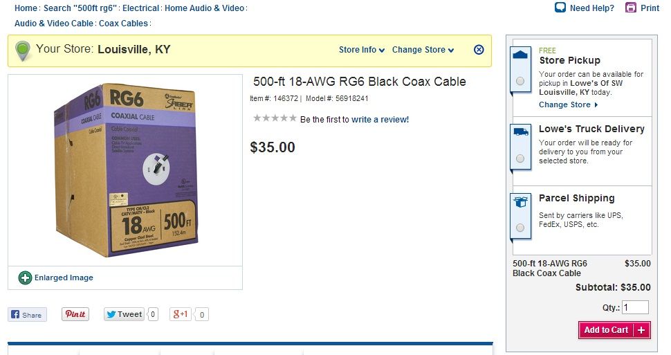

Lucky lowes is cheap here $35 for 500ft :)

I've never bought quad. I personally don't care for the copper clad steel center conductor. I have seen the steel rust completely off with time.

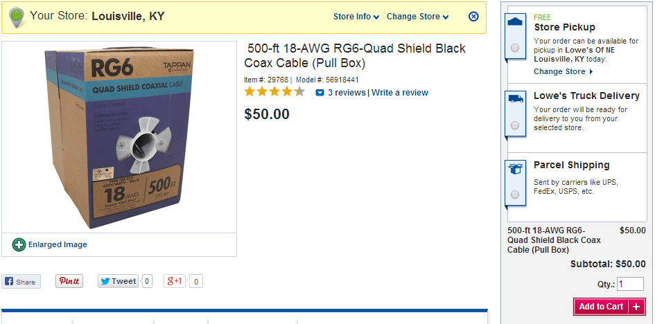

maybe I was thinking of RG6 quad...its been a couple years since I bought 500 foot rolls of coax ;)
I think you are right. I spent about that much at one of the box stores for quad a few months ago.

That cheap coax is probably 'broadband' coax. Broadband coax is for computer networks and is usually designed for use up to about 1GHz. The 'good coax' (single or quad shield) is swept tested to 3 GHz and costs more.
Copper clad steel is much less expensive than solid copper core. Personally, I never use copper clad steel due to the increased chance of corrosion and the lower voltage/current, control signal passing on long runs. If shorter runs with well protected connections, it shouldn't matter too much.
