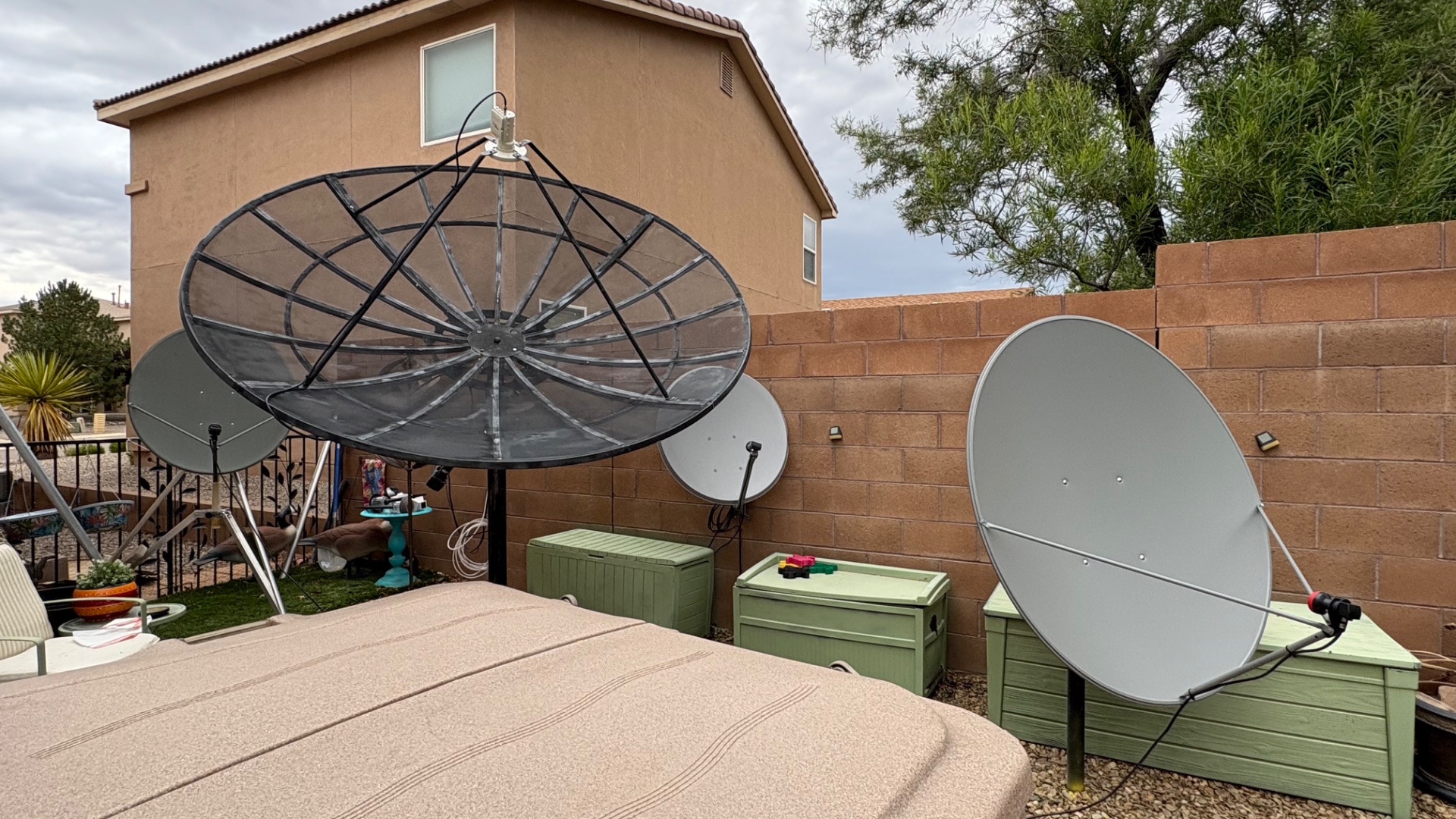

Need some help - 8 foot Unimesh install

We are moving it with the actuator.
This is the LNB currently in use:
Excellent! Thank you for clarifying that the actuator is moving the dish.
For proper polarity reference, align the C138 "0" skew stamp with 3/9 o'clock with the dish parked at the apex of the mount. With the dish still parked at the apex, locate and identify either the 107w or 105W satellite. This will be the approximate center and maximum elevation of the arc, providing a starting reference for visualizing the location of other satellites.

The dish needs a good coat of paint. Any advice on what type to use?
Any FLAT paint should work well. BLACK is practically invisible not too far away from the dish. Though any color that blends it into it's surroundings is good. Just do NOT use anything that's reflective. It can fry the LNBF.
The original paint is powder-coating, and baked in an oven.
