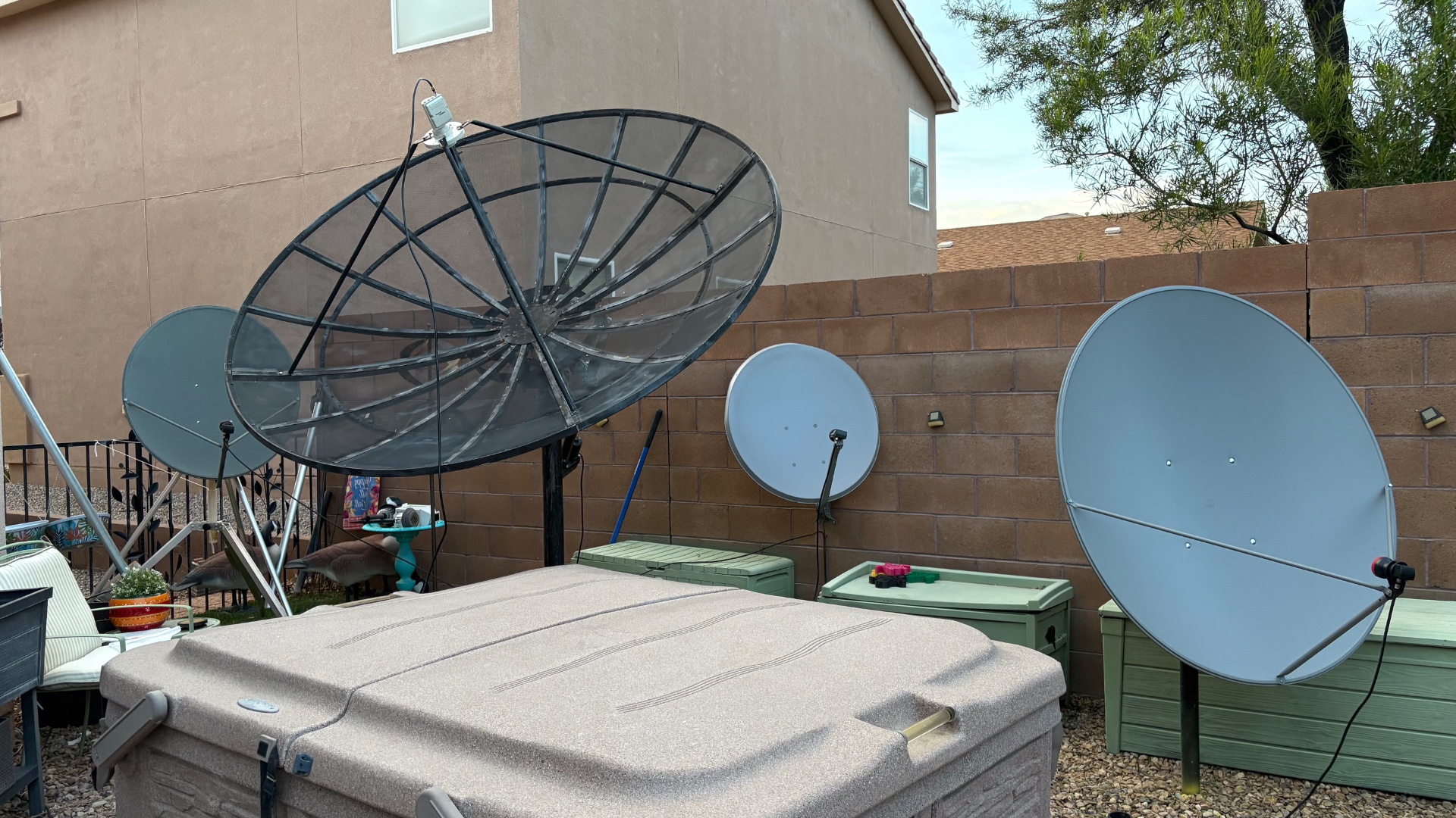

Today we may address some of the issues we're having with satellites on the eastern and western ends of the arc. Satellites at 97, 99, 101, 103 and 105 come in perfectly, but we have issues with 87, 89, 91, 117 and 121. Is this a declanation issue with the dish? If so, how should adjustments be made, and will they affect the satellites that are fine-tuned in the middle of the arc?
Today we may address some of the issues we're having with satellites on the eastern and western ends of the arc. Satellites at 97, 99, 101, 103 and 105 come in perfectly, but we have issues with 87, 89, 91, 117 and 121. Is this a declaration issue with the dish? If so, how should adjustments be made, and will they affect the satellites that are fine-tuned in the middle of the arc?

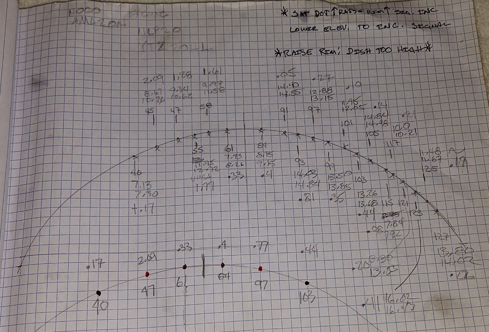

I might can help. Here's a sketch from some time ago using 'dinner plate' methodology.
My buttonhook feed defies all common sense as you can see from the notes at the upper right.
I am very interested in knowing your results for future reference.
As you can see. If I pull the lower part of the dish rim UP to increase dB. It's actually aimed too high.
Screwy because you'd think raising the dish to seemingly aim it higher in the air to increase signal was the exact opposite. Too low.
Using the declination adjuster to lower the dish on closer-to-zenith satellites increased signal.
I was using a score of 1-5 based on how hard pulling/pushing on the rim made the signal the strongest. Then I went to dB.
Plotting the x at the representative relative satellite aim point looking at the back of the dish.
Get as many satellites plotted as you can. Some will fall very close to the desired arc. Some higher or lower and marked with an x.
Look at 101W. Why is he plotted higher on what should be a seemingly steady point to point plot? Don't know.
Fine.
Then connect the x's. How is your arc looking? Egg shaped? In my case on the doodle it appears as if there is a slight North/South axis issue. Everyone is just a touch low. But the Western sats are closer to the actual arc.
Extra fine Sharpie. Automatic center punch. Mark the pole and dish mount.Grab the tools.
Look at the chart (my most-favoritest) that TRG planted above. Be like Watney and science the s**t out of it.
In the end you probably will not be 100%. But very, very close. It takes patience and a lot of tweaking.
Look for slop in the dish piviots too. Weight shift as the dish swings through the arc can make for some very iffy aiming issues.
They have to be solid.
Hope this helps a little bit. Get back to us. Good luck.

Perhaps I missed it but what is the arc of your LOS? Is 107W your true south satellite?
It probably doesn't matter but I think your actuator may be on the wrong side.
Haven't seen answers to the questions posed there
Haven't made any adjustments yet. Need to flip the position of the actuator arm and fix a stripped nut/bolt first. Will post updates once we've got those things fixed.

Well, points #6, #7 and #8 I find not so good.
What's the point in rotating the whole setup around the pole, when you have only checked at one side (the east side), and not yet made certain on both sides that the north/south outlining is indeed not OK?
This advice, in fact, is counterproductive.
See this text, quoted from the linked file:
If your dish is pointing at a satellite to the east of center and you have to push up on the dish to get a better signal, then the elevation angle must be adjusted higher.
You adjust this by turning the WHOLE mount to the east!
