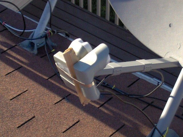

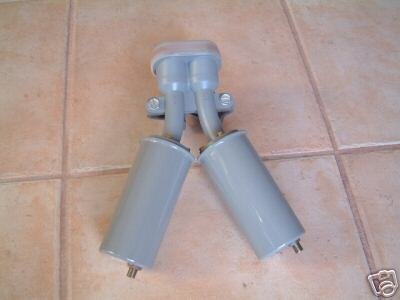

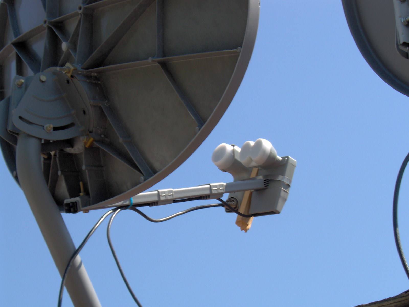

here are some pics
1st one is the beer cans
2nd & 3rd is the quad (disregard the other LNB...that is one I had for 119 to get NASA TV)

I have the beer can style . The reciever was used on a singe lnb (before now), which i have in front of me and it looks like the quad but with one white cap. So my reciever needs to be remapped??
