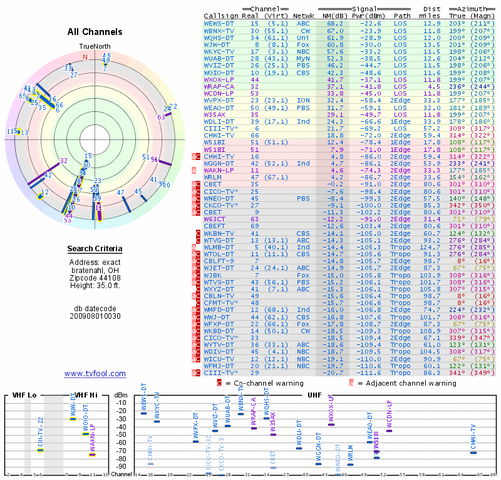

I would like to watch 35 (W35AX, RTV) and 49 (WEAO, PBS) on a regular basis, as opposed to when the weather conditions are perfect. I've attached my tv fool report.

W35AX may be getting trashed by WQHS. Adjacent channels 0.2 miles apart was a major brain fart on somebody's part. I'm shocked and appalled.
WEAO may beg for a little more southerly orientation of the antenna (assuming no extraordinary obstructions).

Your best bet is a 91XG with no amplification. I would try it without a rotator first if all your desired stations are in the same general direction. A 20 degree spread will probably be acceptable with those signal strengths.
If the stations are co-located, adjacent channel interference isn't a concern & is seen in many cities throughout the US. We have a low power channel 8 (200 watts) wedged between powerhouse channels 7 & 9 (52,000 watts) & reliable reception is possible up to 25 miles away with the right antenna. Ain't digital TV great.
