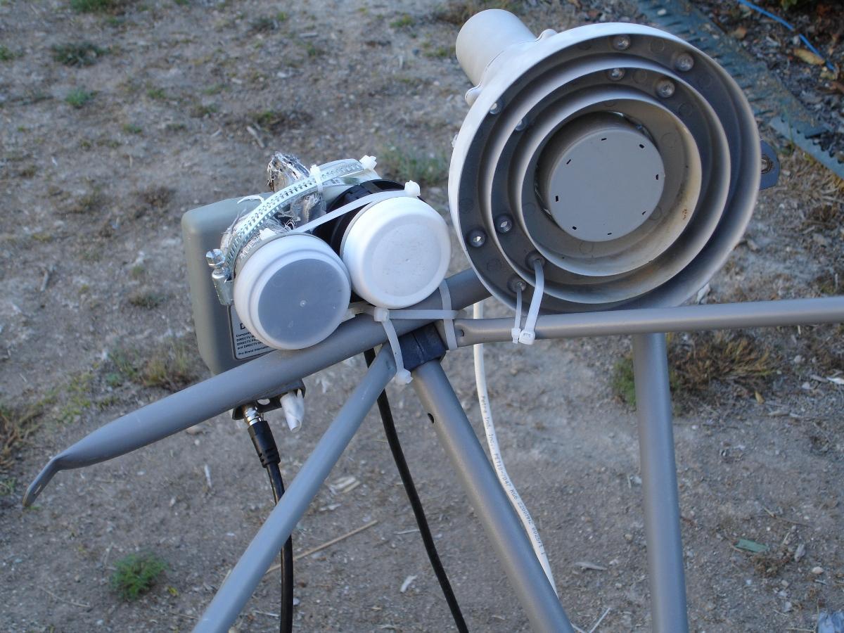

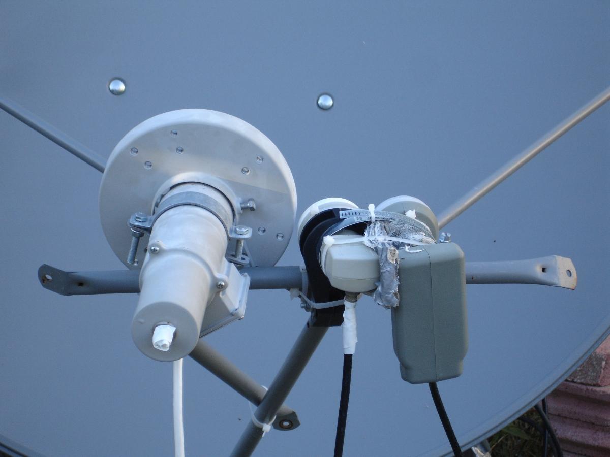

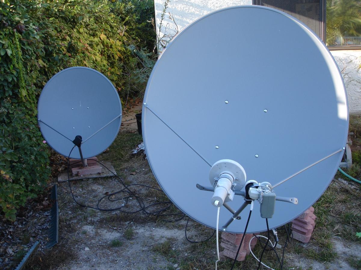

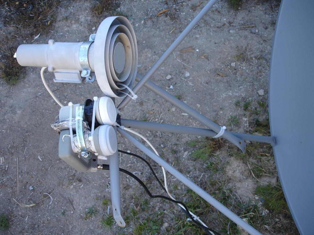

Here's my setup :)
I know it does not look that great, but it works well for me and the tie-wraps have held it in place since June without any problems.
The 1.2 Meter Dish (Large one) is on a motor GS120.
The 36" Dish is pointed at 103 Degrees West due to the weird skew.
Hopefully this might give Brotherhood some ideas.

Hope You Understand What I Mean
