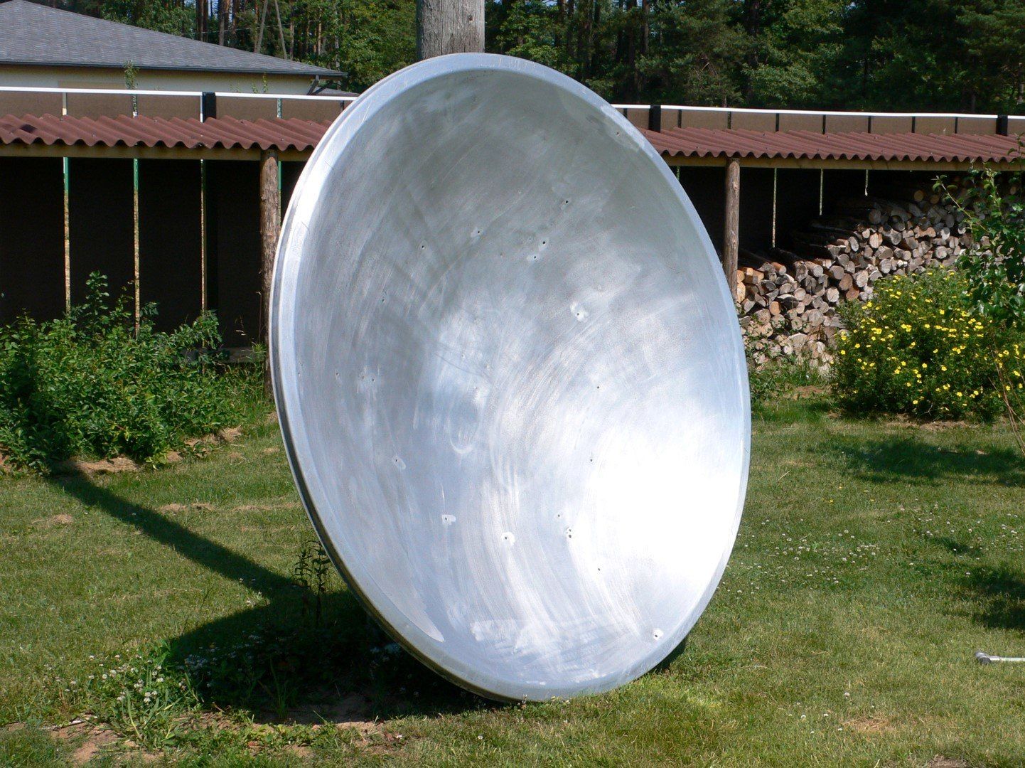

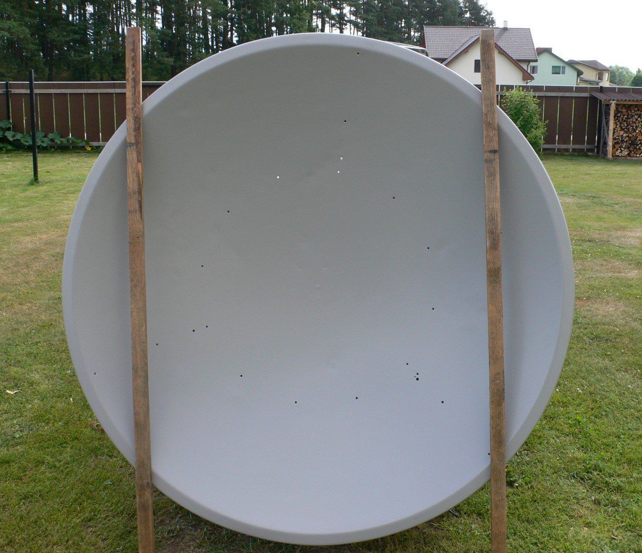

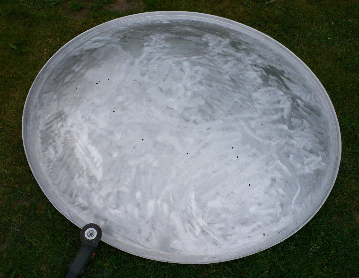

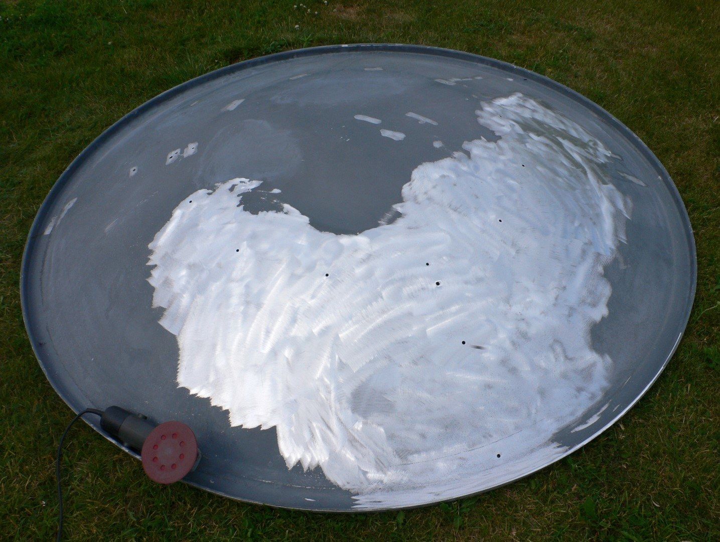

This summer I refurbished 1,8m aluminum PFA. Removed old paint and gave it to paint-shop where they applied powder non-metallic paint and then fixed it under high temperature.
That is a beauty.

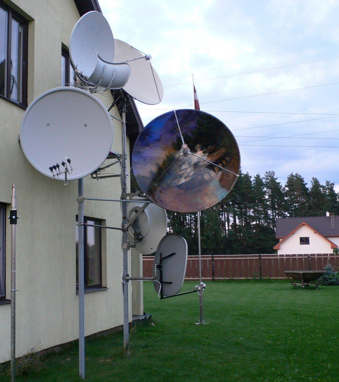

And for this 1,8m PFA I've spent about 10x more than to buy it :rant:. Aerofraphed by professional artist with car-paint and lacquered in auto-shop (so very dangerous to use when sun copies Clarke belt). Will probably use it as a painting in the garage. :)

Nice fancy custom paint job on the other smaller dish too. Dish farm looks well organized and leaves a small footprint, easy to mow under etc.

Guess the hard part would be cleaning off the old paint.
Yes, it took some time and made me quiet dirty :rant:
not damaging the dish when moving it to/from the painting facility...
For that I made 4 small holes on the edge of dish and screwed dish to 2 wooden planks, so no damage at all and easy to carry (see my post #5 picture #4).
Small dish is also 1,8m :)
Very nice work Rima, excellent dish farm. You must get tons of channels!
Thanks. Yes, there are many channels in the list, and all of them, if needed could be reached by one single polar-mounted antenna. That also does not mean I am watching all those channels.... maybe couple of tens and some terrestrial. And that picture is not current one, my farm is changing quiet often in quantity and also quality. My last favorite antenna is 1,8m offset Prodelin located on the ground (not on picture).
