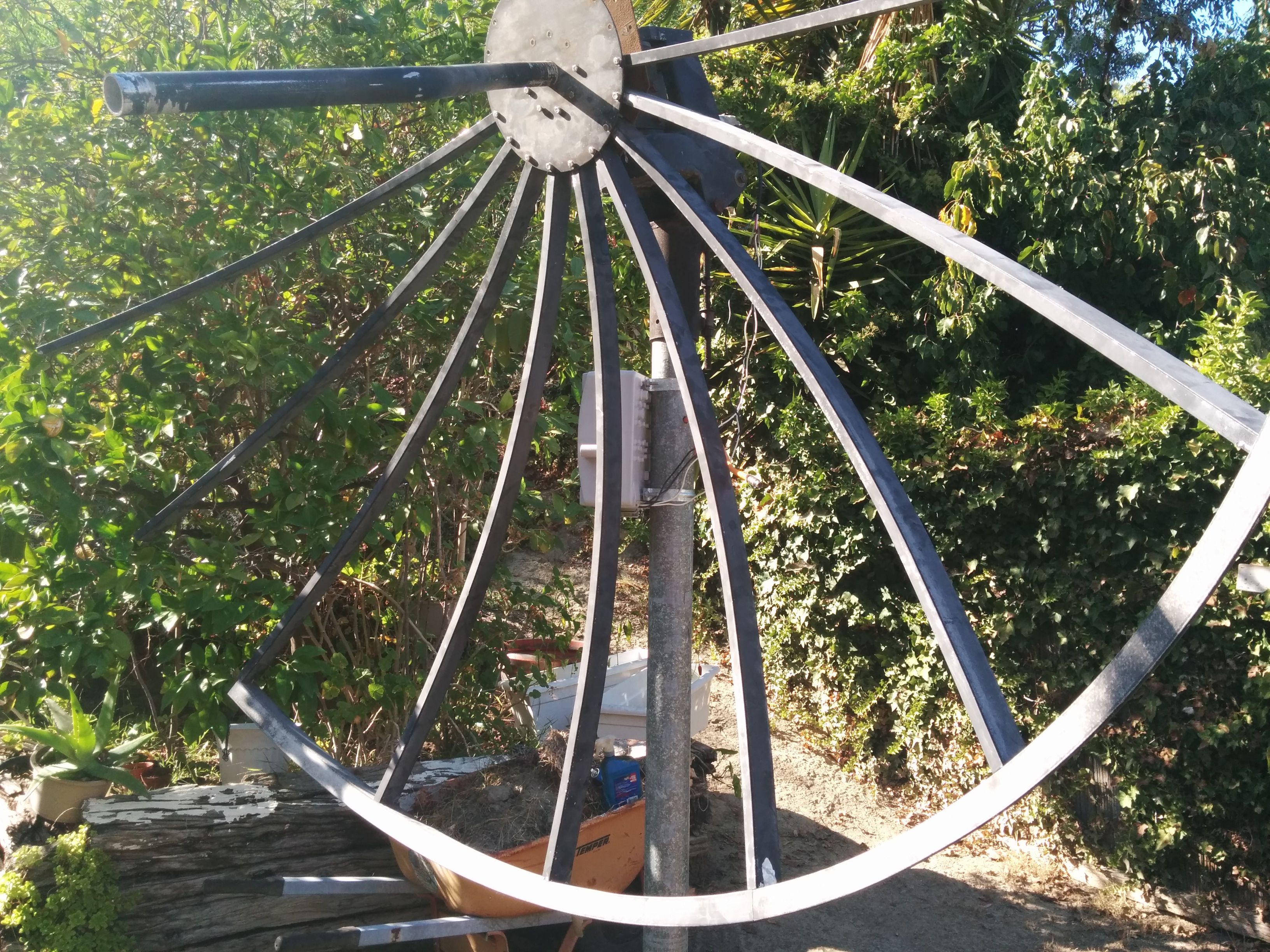

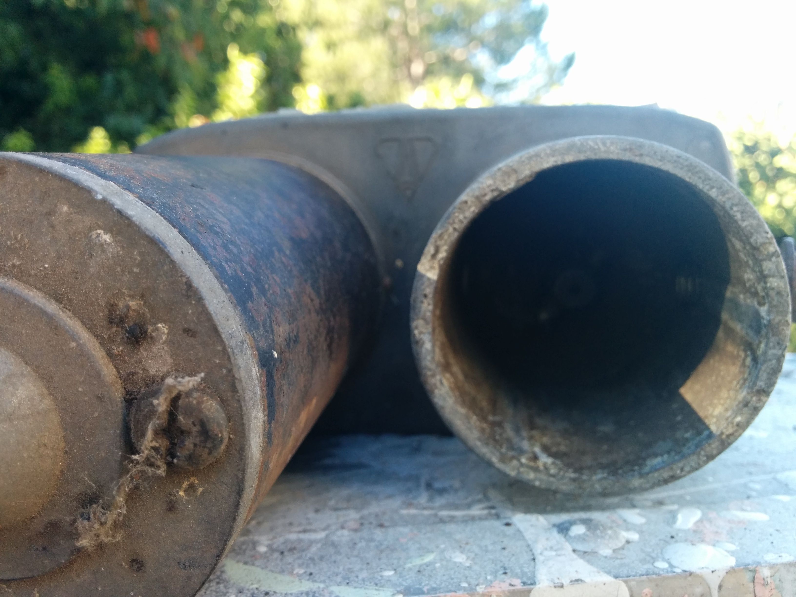

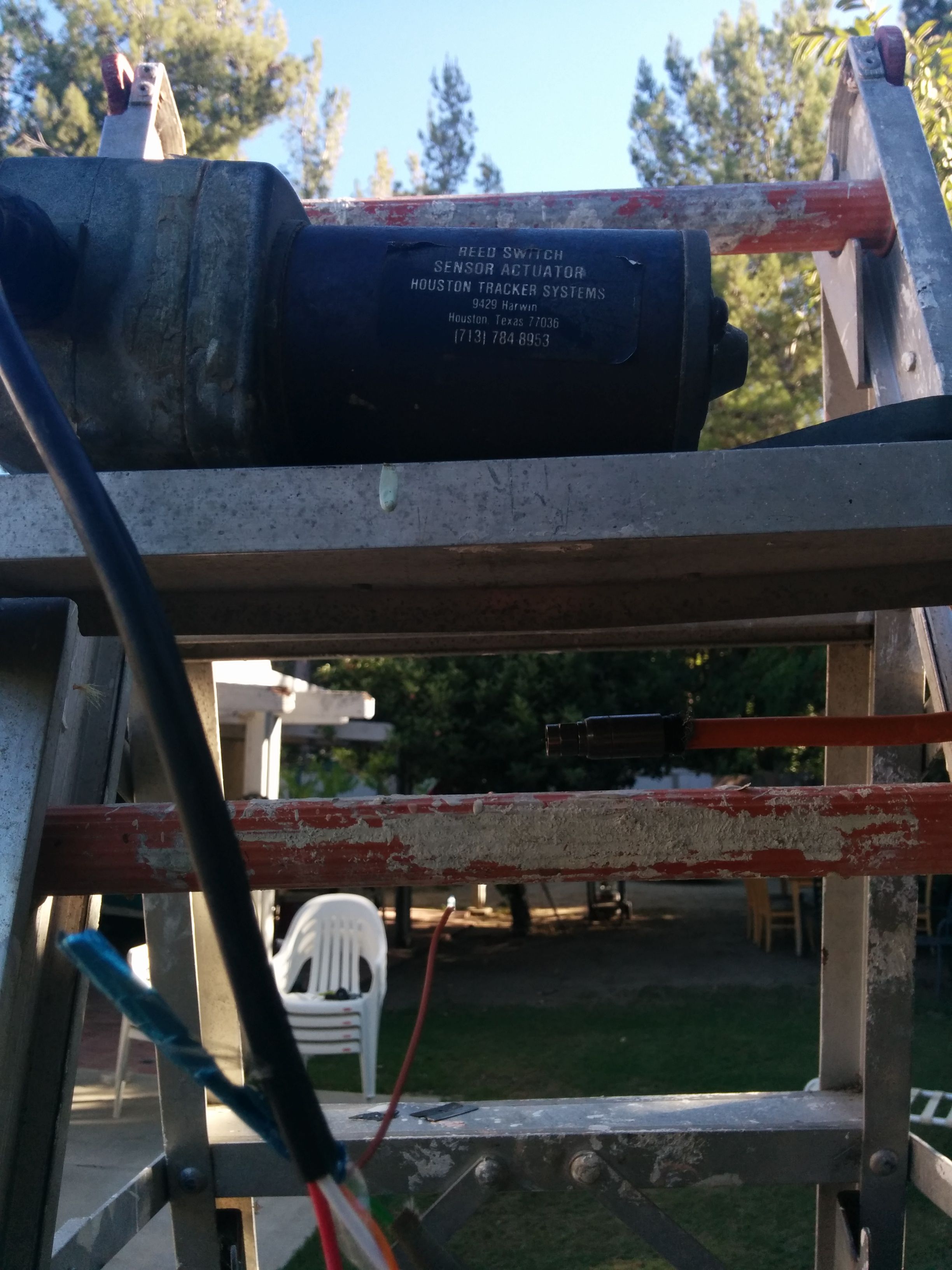

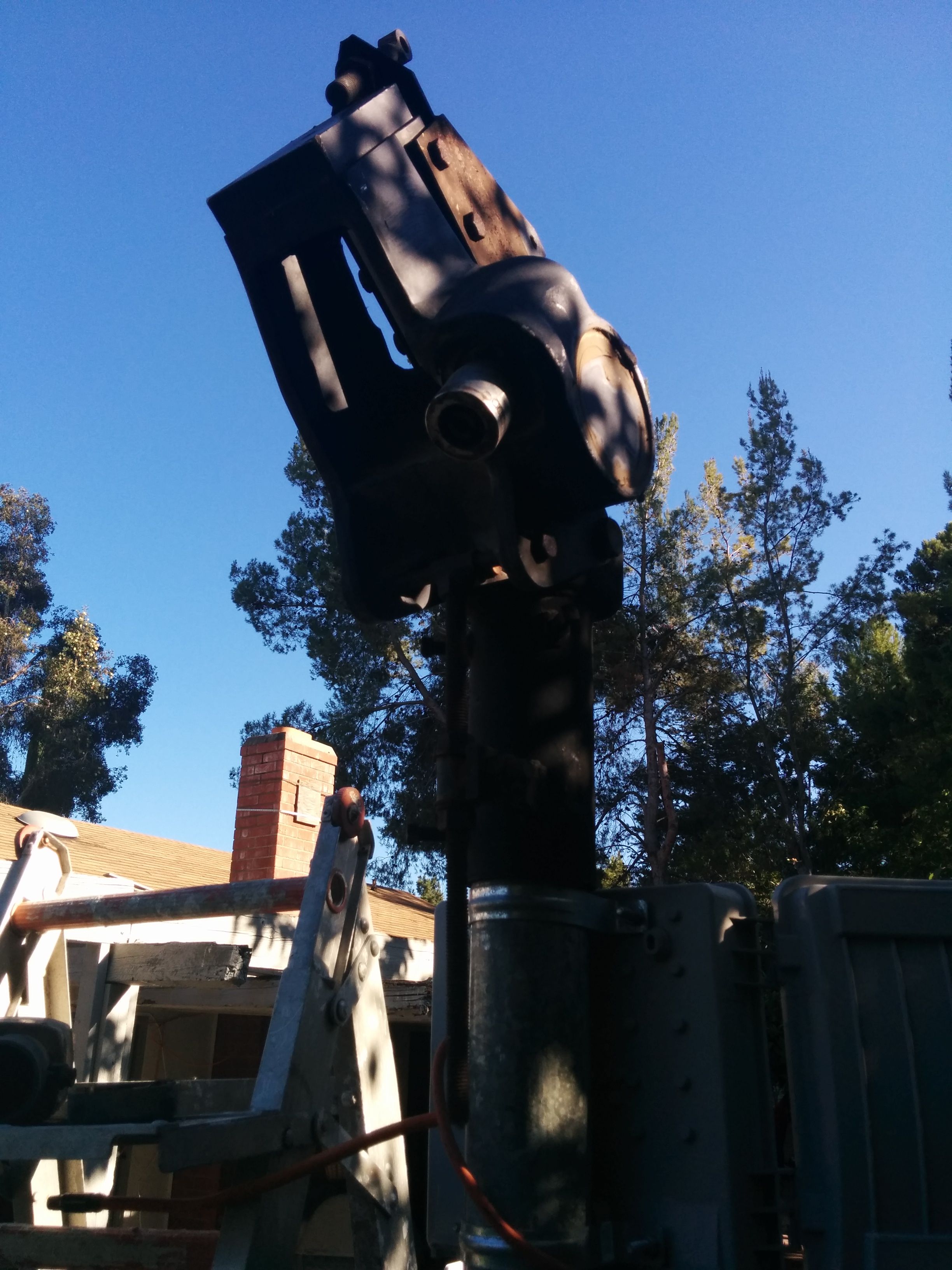

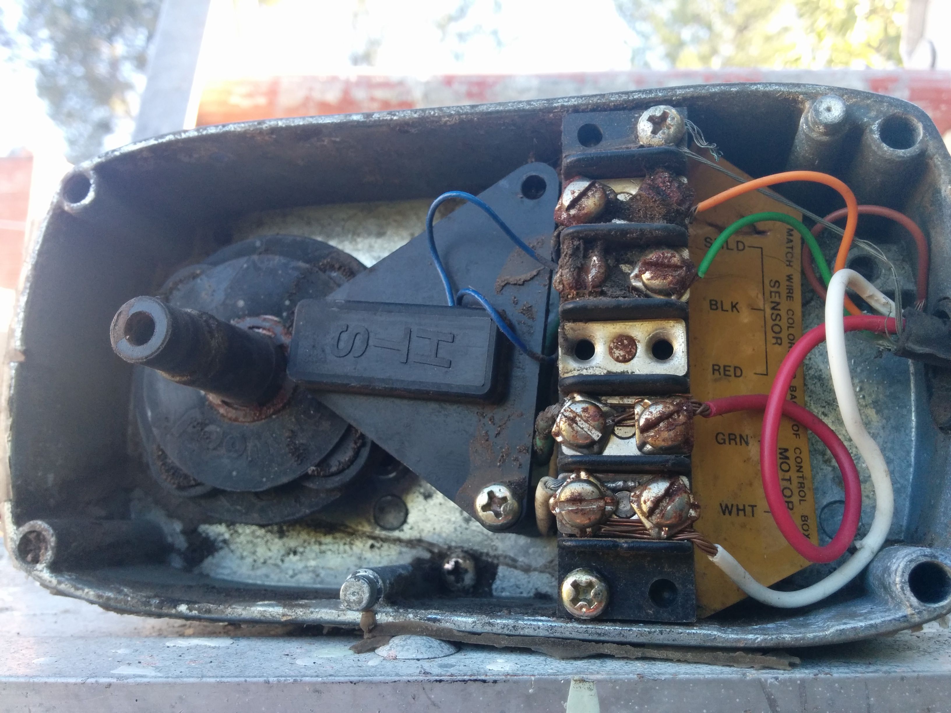

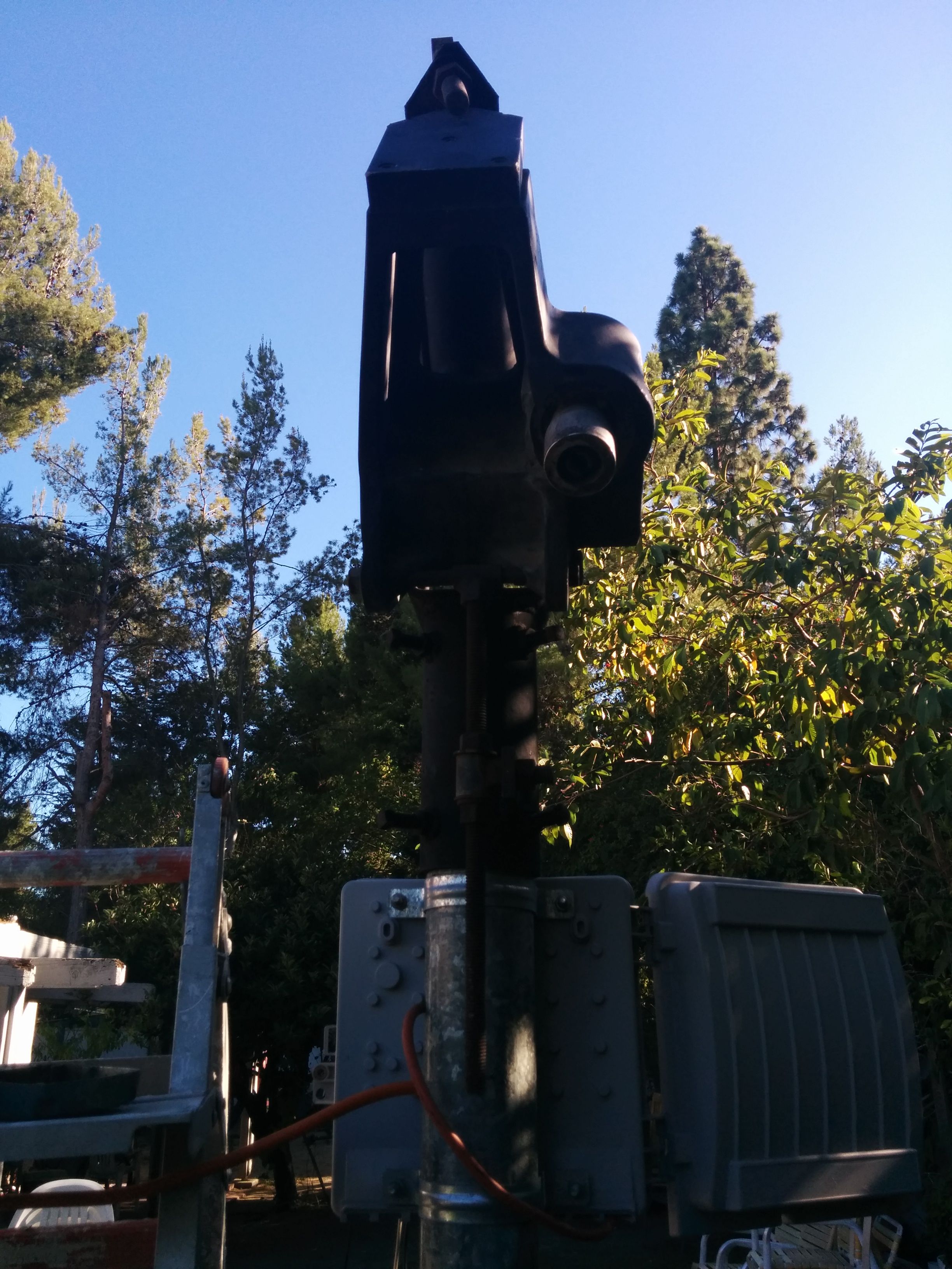

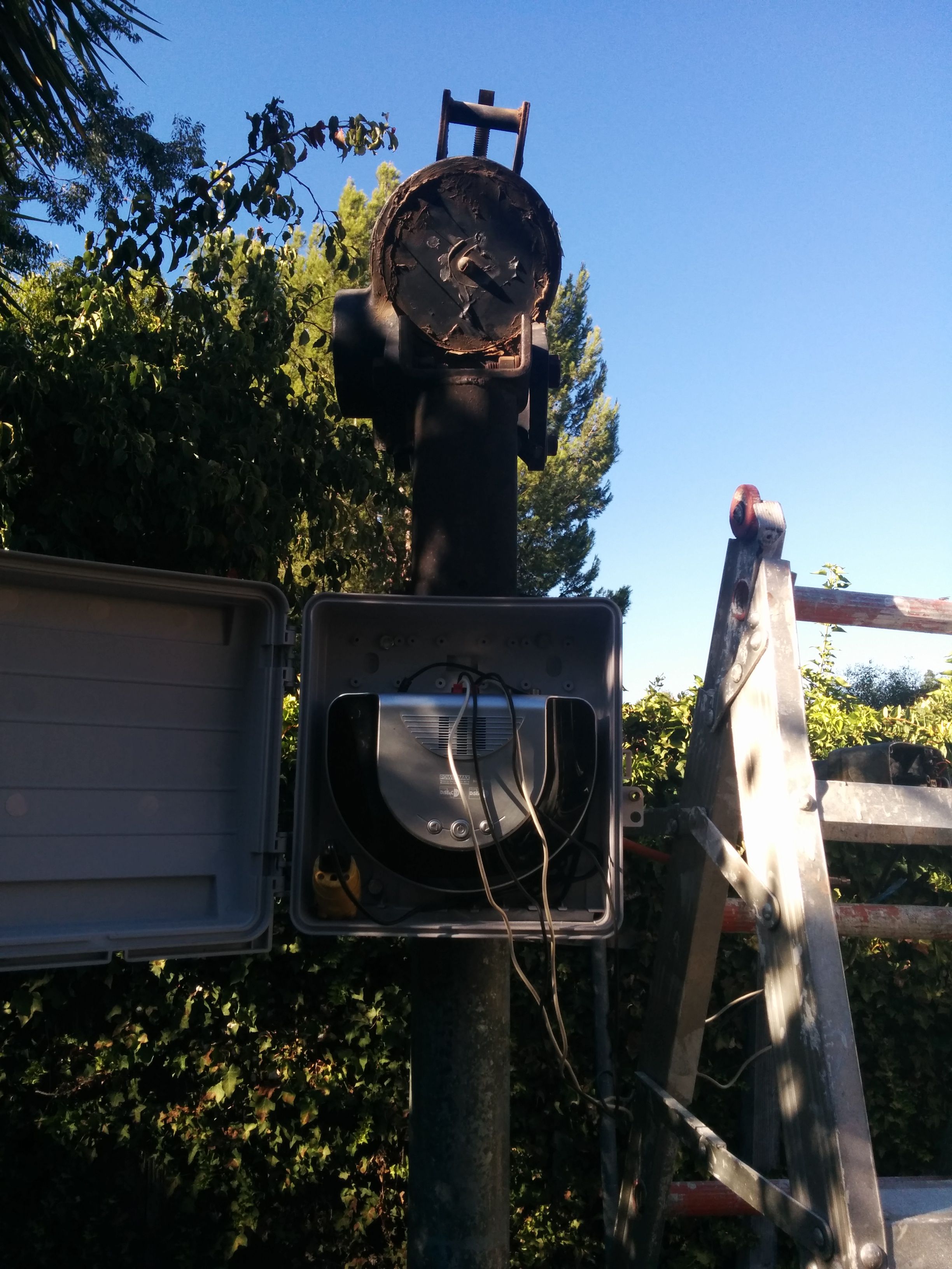

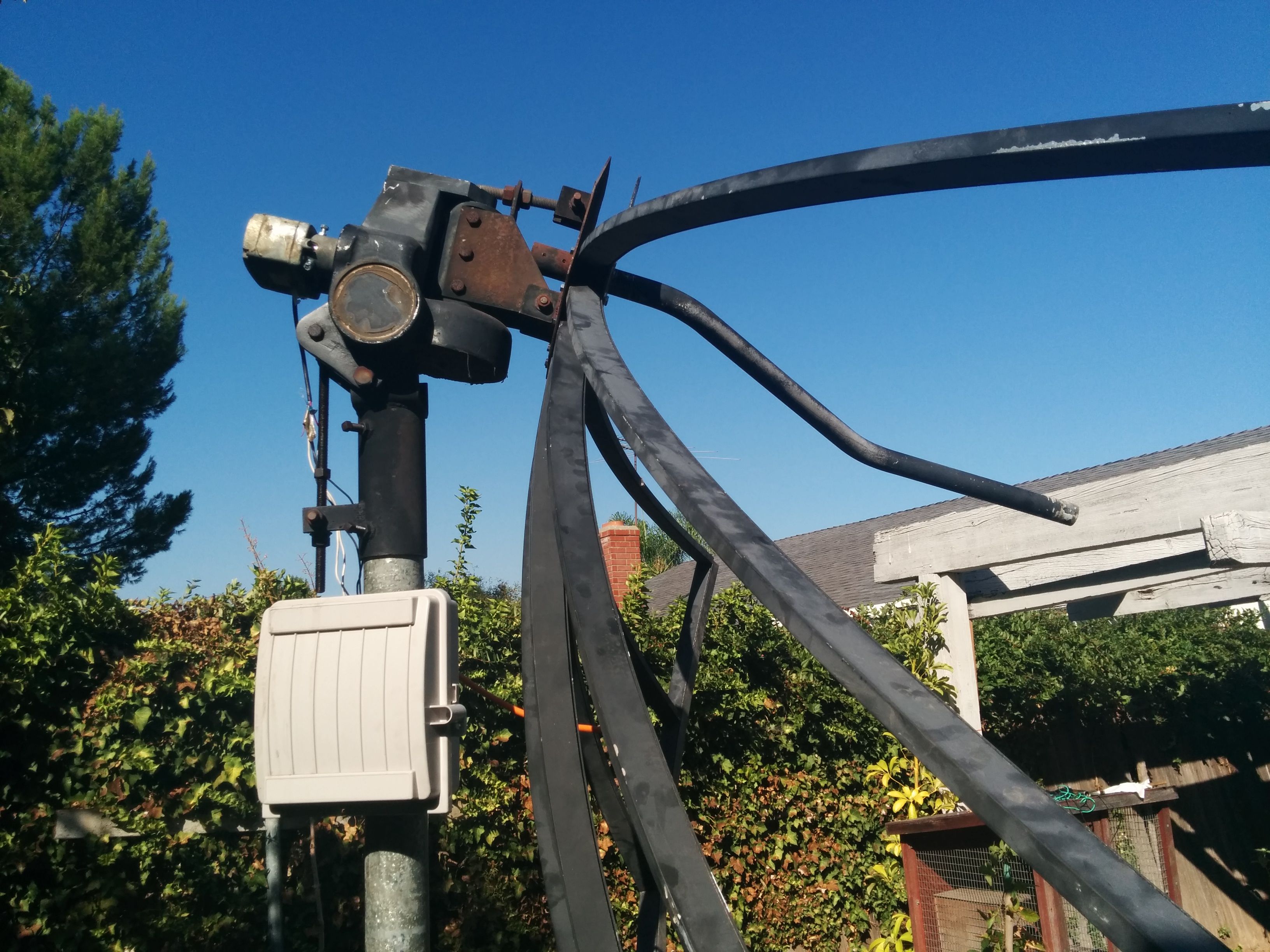

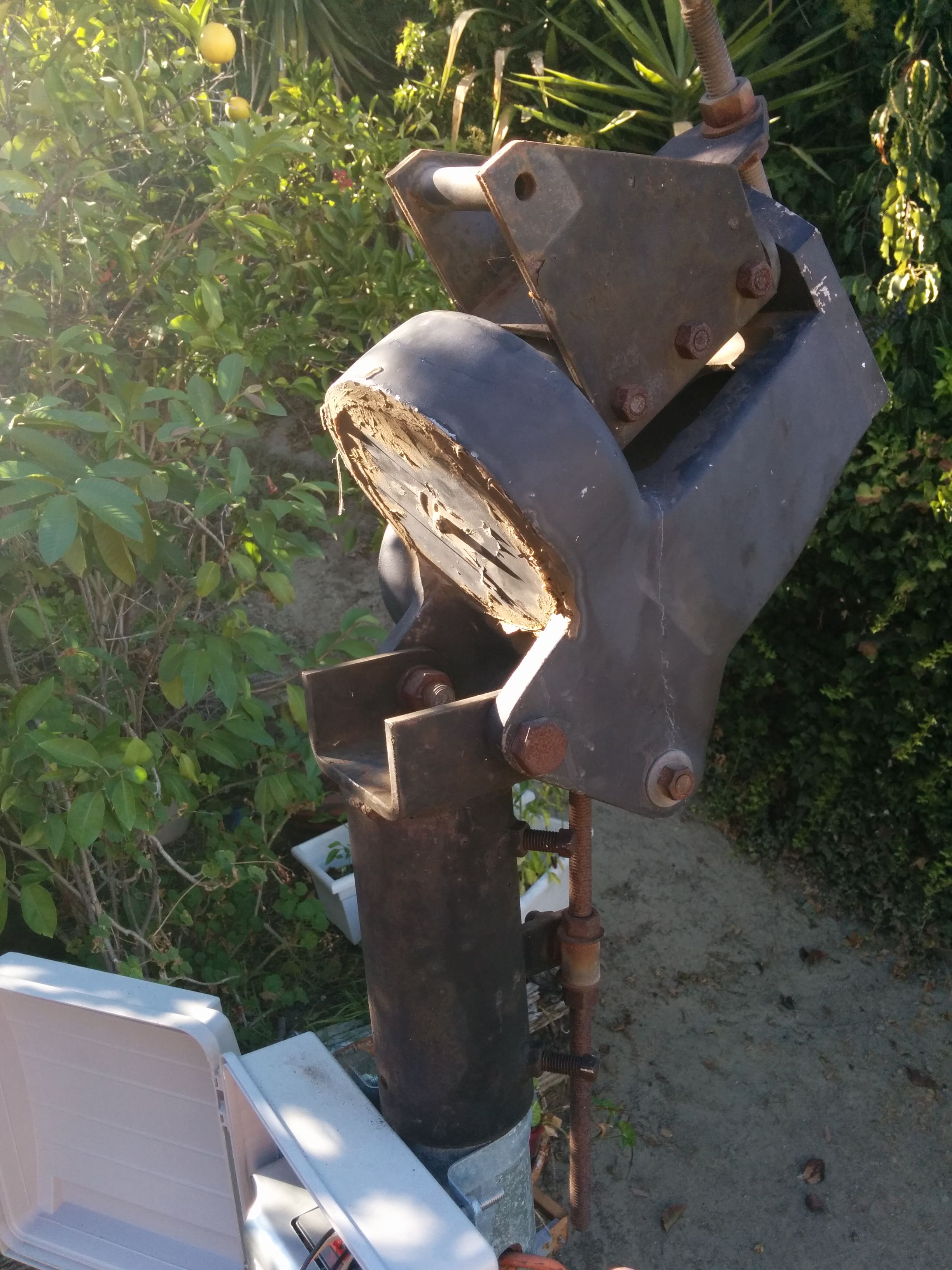

i recently got this dish that uses a 36volt houston tx motor by city thats all i know
it has the telephone number as well but it aslo says reed switch motor on it
i wanted to speed it up is there a way
i have a vbox x still and works still
i have a 9 foot dish
and some pictures im working on it
so pick this up in el cajon for free in california
i live in mission viejo
this uses just the motor from an actuator and does connect to my vbox x
everything works just need something to go faster but not to fast
it has a gear box and don't aslo know what type of dish setup this is or the name well
i'll leave it up to satellite guys to see what it is and i'll be posting some pics along the way

You can't really change the speed without a sacrifice somewhere else. The motor is a common linear actuator motor. Most are 36V with a reed switch sensor. But the one you have looks a little "crusty". Is it functioning as it should? Maybe your motor is suffering? My H-H mounts are not as fast as most linear actuator setups. They are geared low to pull a heavy dish off the horizon :)

But what I see here is a dish and motor combo that has been turned to a certain position for a long time; and I would just take a new motor/actuator and make it turn the dish east and west; and put the vbox back inside the home. This retro-fit needs it; the pictures show it; and I would disconnect AC at the dish; remove any binding of the mount/dish relation; install the actuator arm on the east side of the dish. Hook it up to motor wires and sensor combo; put the v box inside out of the weather; hook it up correctly; BAM; new dish!
