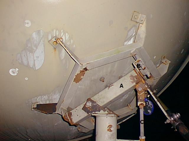

Also in one of the pictures below, i put in A, B, and C. A is polar axis, B is elevation and C is declination offset, right? There are two bolts for B. Do they need to be the same measurement from the little plate they are tac-welded to? Or is this the adjustment necessary to fix my first problem above? I dumbed off during one of my quests to setup the sat tracking arc by confusing B and C, throwing everything off. I can't seem to find paint evidence to where they were set to. This is starting to sound familiar from another thread i read a month ago :o please forgive me? There are SO many threads to search thru, that i have spent many hours reading and getting easily sidetracked into reading other sat related (but unrelated to my searches) problems or coolness, and am trying to cut down on time wasted on the computer (this is hurting the WAF!)

If I'm looking at the picture correctly, you have your definitions for B & C backwards. B should be your declination, and C should be your elevation. You are correct in your assumption that the true south is in the direction of the polar axis. It appears as though you have it set-up for an eastern arc, so you may not be able to go any further than G1 and you're only missing 3 sats to the west, which the last one, you probably wouldn't get anyway, as it's primary target seems to be Alaska. The 2nd one has only feeds occassionally and the next one to G1 has a few analog subscription channels and a couple of shopping channels along with C-Span2. It could possibly be in the limits on your Drake receiver. But, unless you get a DVB receiver or especially a 4dtv receiver, you should be OK as you are. And last but not least, your feedhorn/polarotor may be off 90 degrees causing your H/V to be off. But, then again, if I remember right, I had one of the 1st Drake receivers, and it had a button on the front, with H/V on it, to push when you changed from one sat to another. Later models would do this automatically. I'm sure you probably have a later model. And oh yeah, 95 only has occassional feeds with analog, so you would need to catch a live feed of some kind? Good Luck!

I'm really sorry if something I told you caused you a problem. By looking at your pictures "A" needs to be set at the 29.6 degrees that I told you for your latitude which you said was 29 degrees. The adjustment for that appears to be "C". "B" is the adjustment for declination that I told you was an additional 4.8 degrees for a total of 34.4 degrees across the face of the dish when it it at its zenith or apex. Voomvoom is right, it appears that it is set up for an eastern arc. That possibility didn't occur to me without the pictures. For a western arc the drive arm is mounted on the east side of the dish and is pretty much fully retracted when the dish is pointing to satellites in the west.
