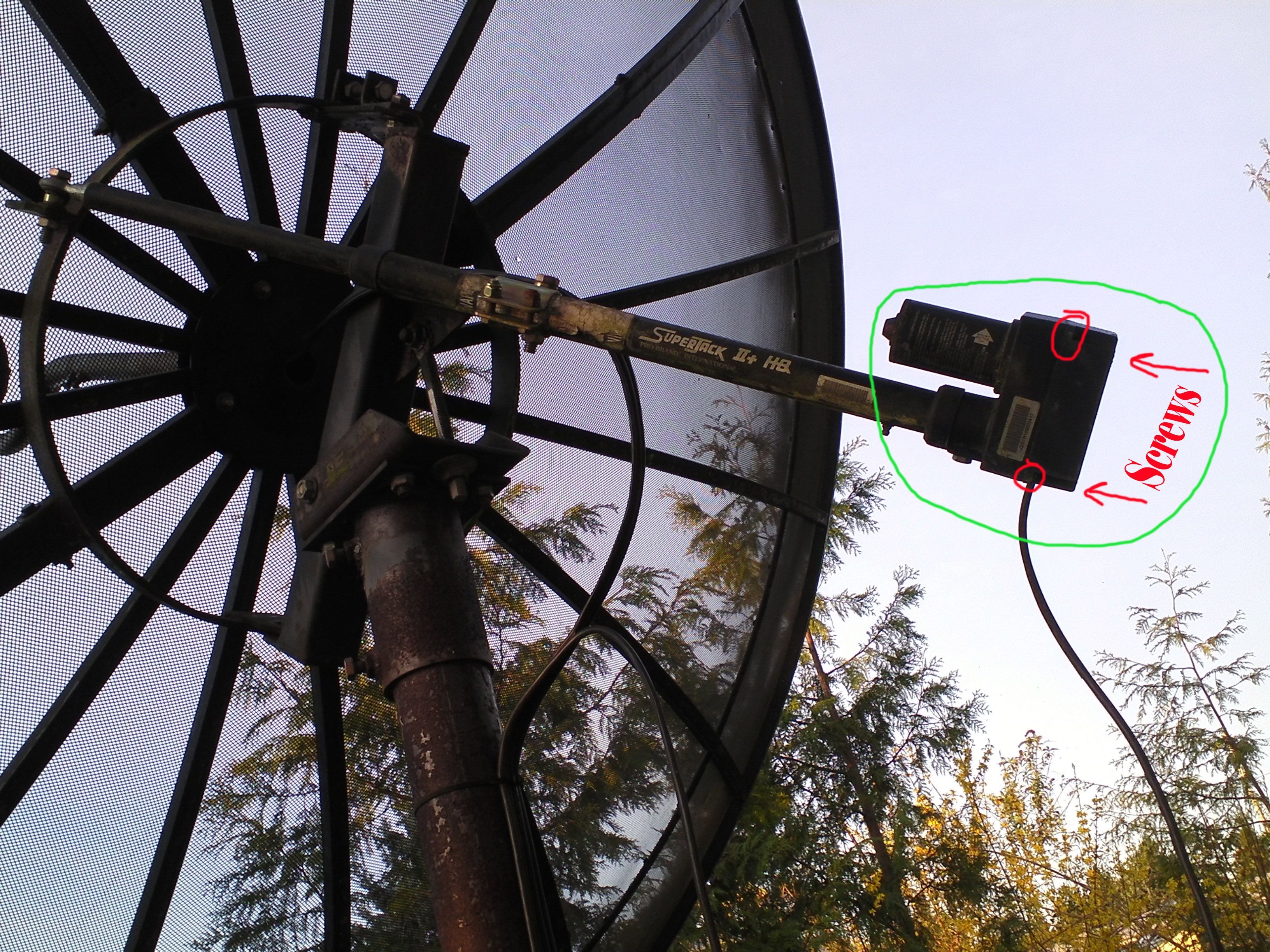

Can you circle where this motor cover is located (see my previous posted pictures)? I see the actuator arm.. is that the motor?
Yes, I did the test inside the house. Again, I don't know where this motor cover is located.. the actual arm looks like a thick pole/piston...

Click the thumbnail for larger picture.
The terminals with the larger gauge wire will be the one going to the motor. :)
