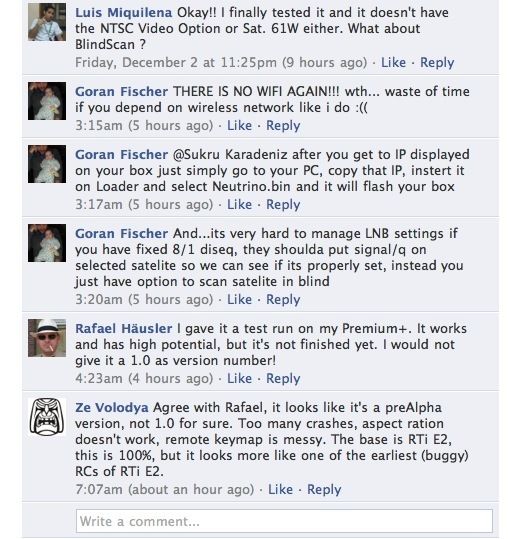

OK, don't follow AZBox Instructions.... Just start the Neutrino Loader App ad it will put the AZBox into Rescue Mode, then follow instructions.
Again, Holding the "Vol+" did not put it into Rescue Mode.
glad I didn't jump on it
