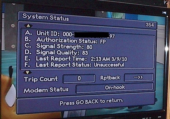

Ice have you ever seen any stuff go FP where any box can get it like if there having problems on Shaw? Any free previews on an subbed box probably go to "U" mode. It would be interesting to see if a box that was just unsubscibed would pick up the "U" stuff. I think once it goes OC (old category) or old monthly keys. It can only see FP and ZK.
unsubbed wont get the freeview or U stuff. Only FP or ZK. My old 205 hasnt got free previews when I know the 505 did ;)

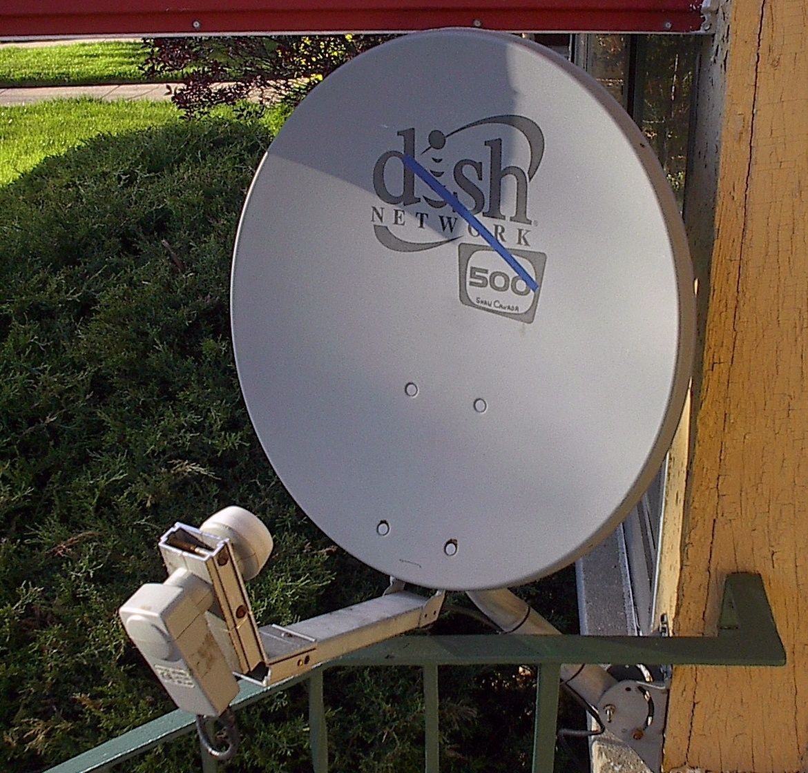

I did finish up my repointing of my ADTH this past week too. It's now pointed at AMC-4 and G-19.
Ku birds list:
AMC-9, 90 Cm Primestar.
AMC-4, 84 Cm ADTH.
G-19, 84 Cm ADTH.
Anik F1R, Modified Dish 500.
Direct tv 101, 18" Dss dish. (looking at directs guide)
C band: Motorized Unimesh 12XL. 40w to 143w.
Total 5 dishes. My neighbors have to think I've gone beyond nuts :D

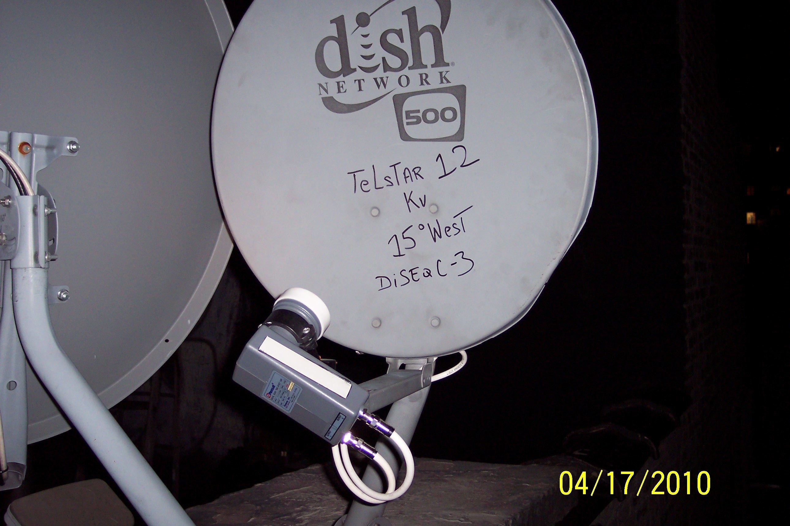

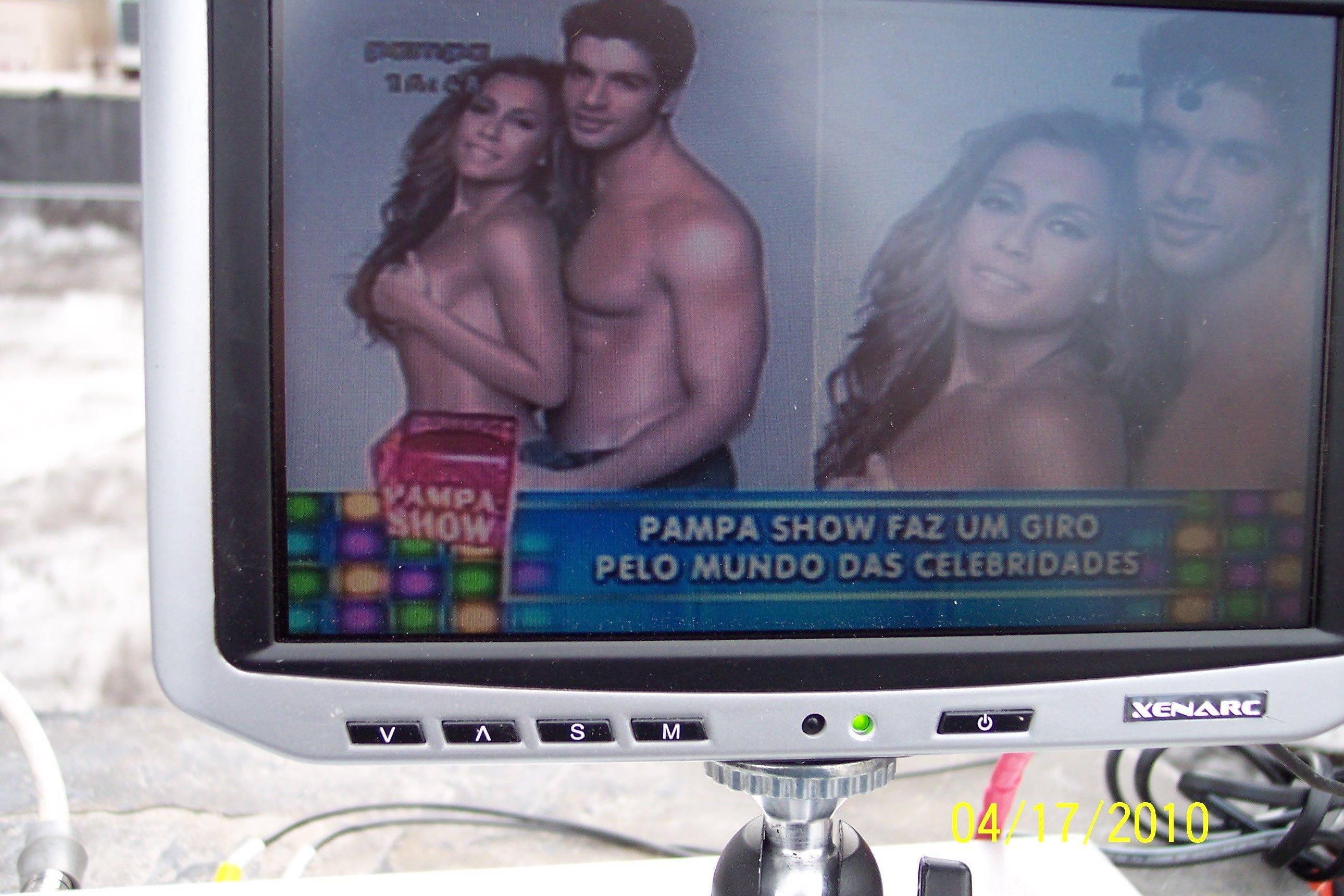

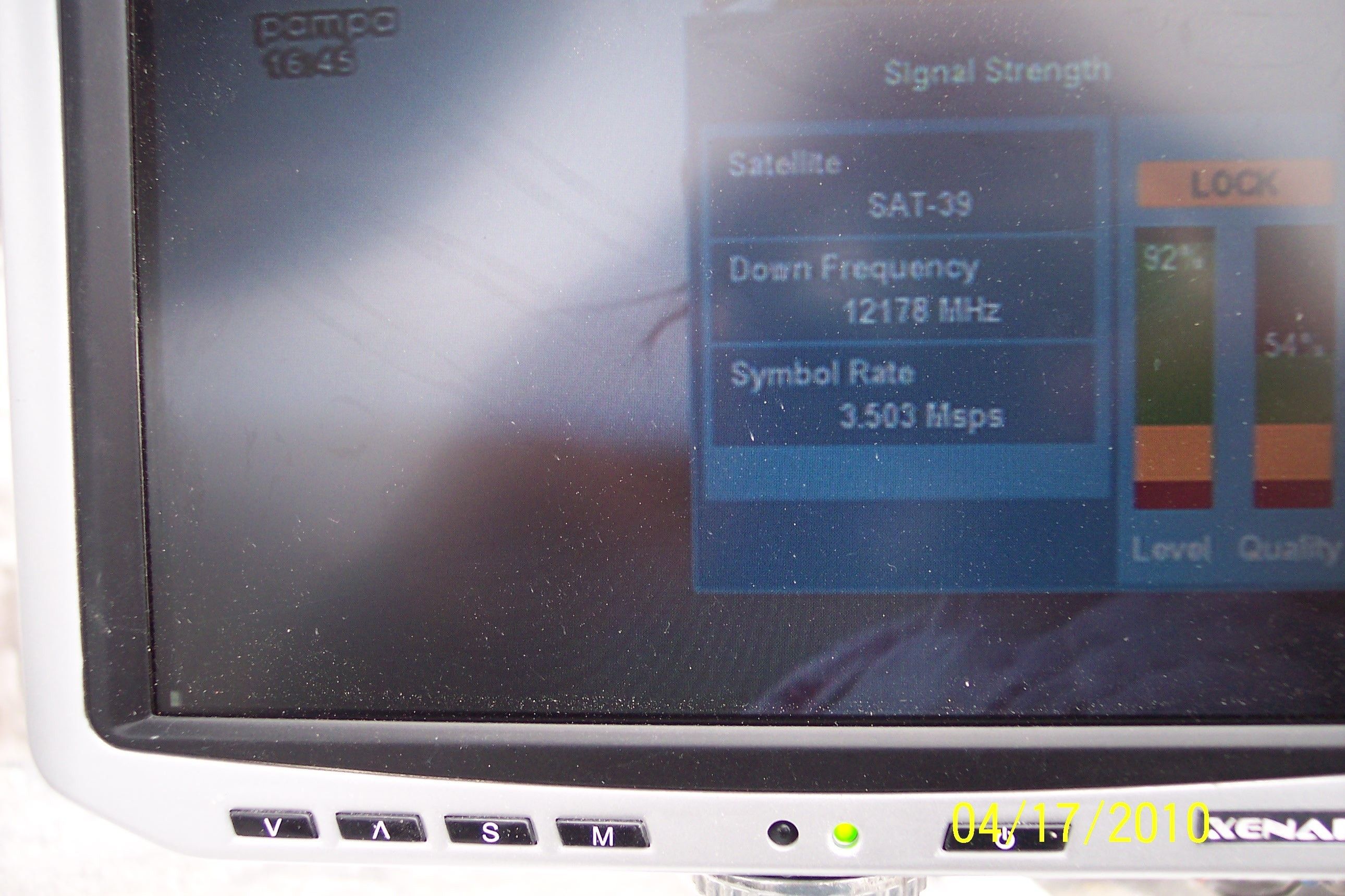

Last weekend I tried to do the same with another bird.I got a good result with mini dish 500 aimed to T-12.Usually I have Quality about 60-65.Here I post a few picks
These Dish 500's are better than I thought for FSS stuff. They are plentiful too and free. I have been looking at the smaller dishes on houses around this neighborhood lately and would like to score a globalcast or a larger direct tv HD dish to mess around with too. Have to keep my eyes open. :)
U Right !!!
All you have to do is find a focal point for LNB.Once you do it right? all is a piece of cake.Its a good training with finding a signals on the sky.Also a lot of fun.You can practycly use a Dishh 500 for all major tru fta birds on Ku bands
Update
Seems like it holds up pretty good in the rain. Over the weekend it was raining here and I was getting a low of 63 to 66 Q I thought it would drop out with any rain but it had quite a bit to go to threshold 35-40 Q :)
Decided to play with dish a bit tonight

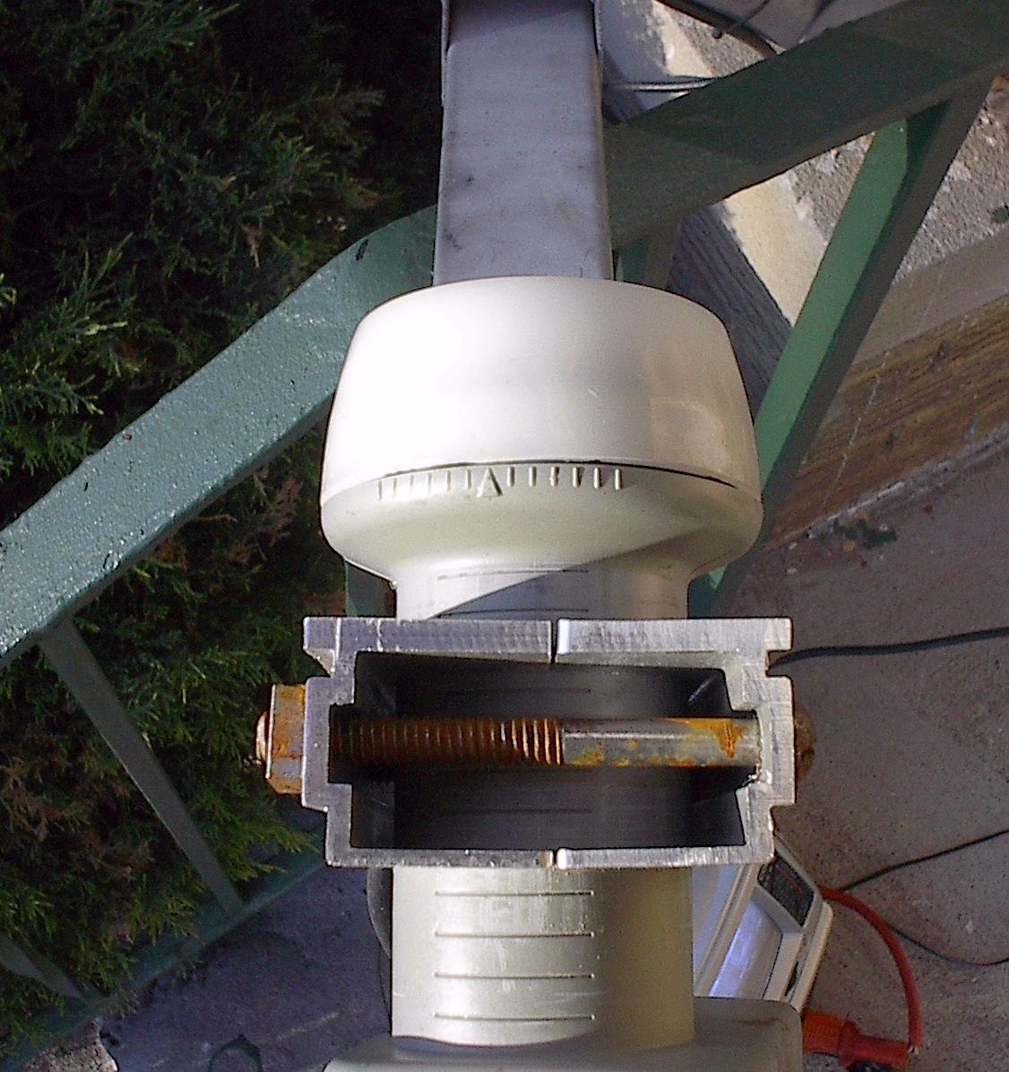

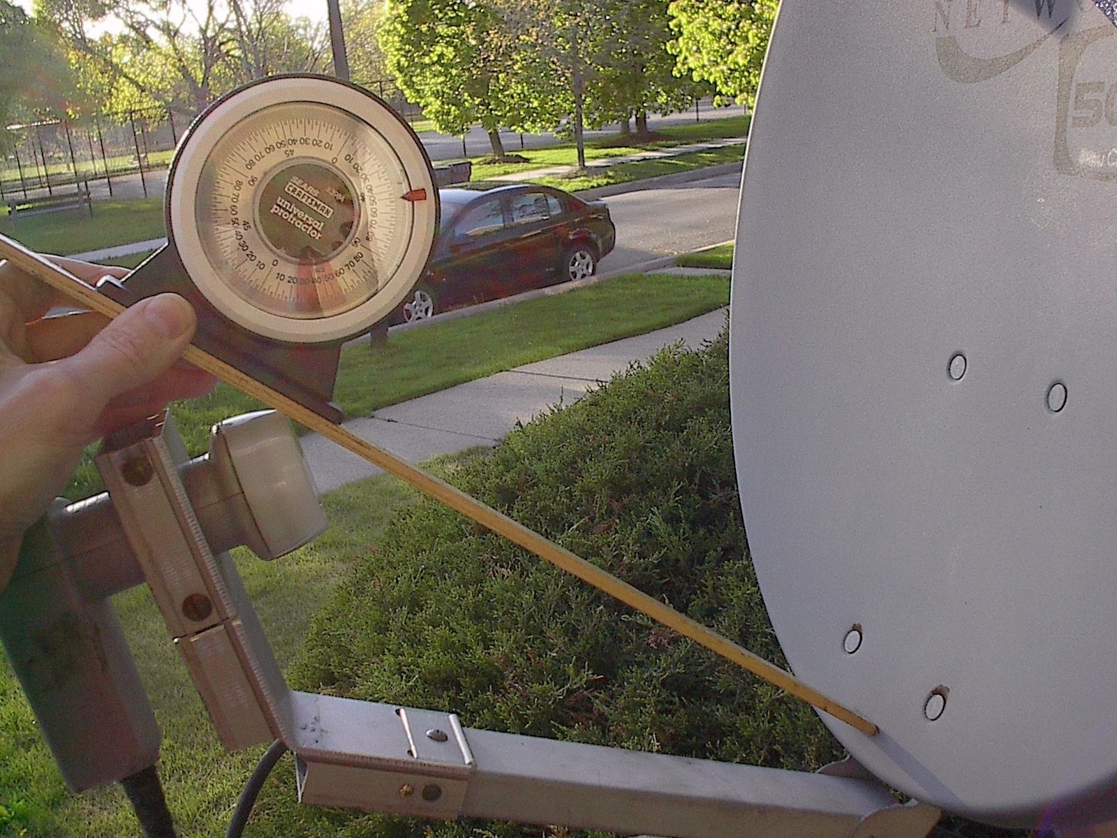

Was sitting around and thinking how much I can get out of that 21.5" dish. So I went outside and messed with it. I picked up a bit more. I played with the feedhorn and the azimuth the elevation was maxed. I actually slid the LNB closer to the dish and turned the skew just a bit. Thats all there is now. Used EBNO to peak, love EBNO peaking :D This thing is doing great for it's size.
The one thing with these mini dishes on FSS ku, adjustments are very touchy. Not a project for the guy in a hurry.
