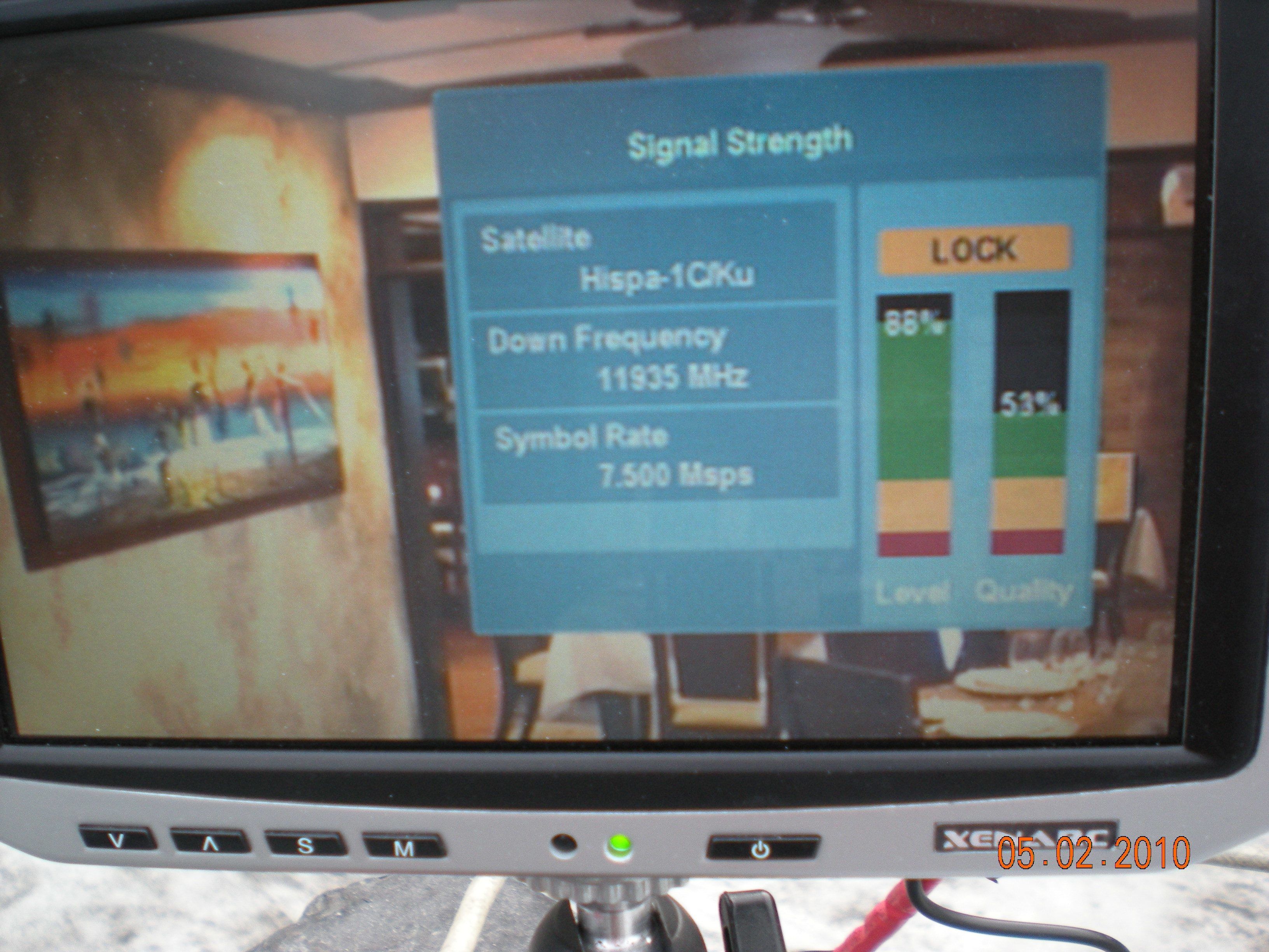

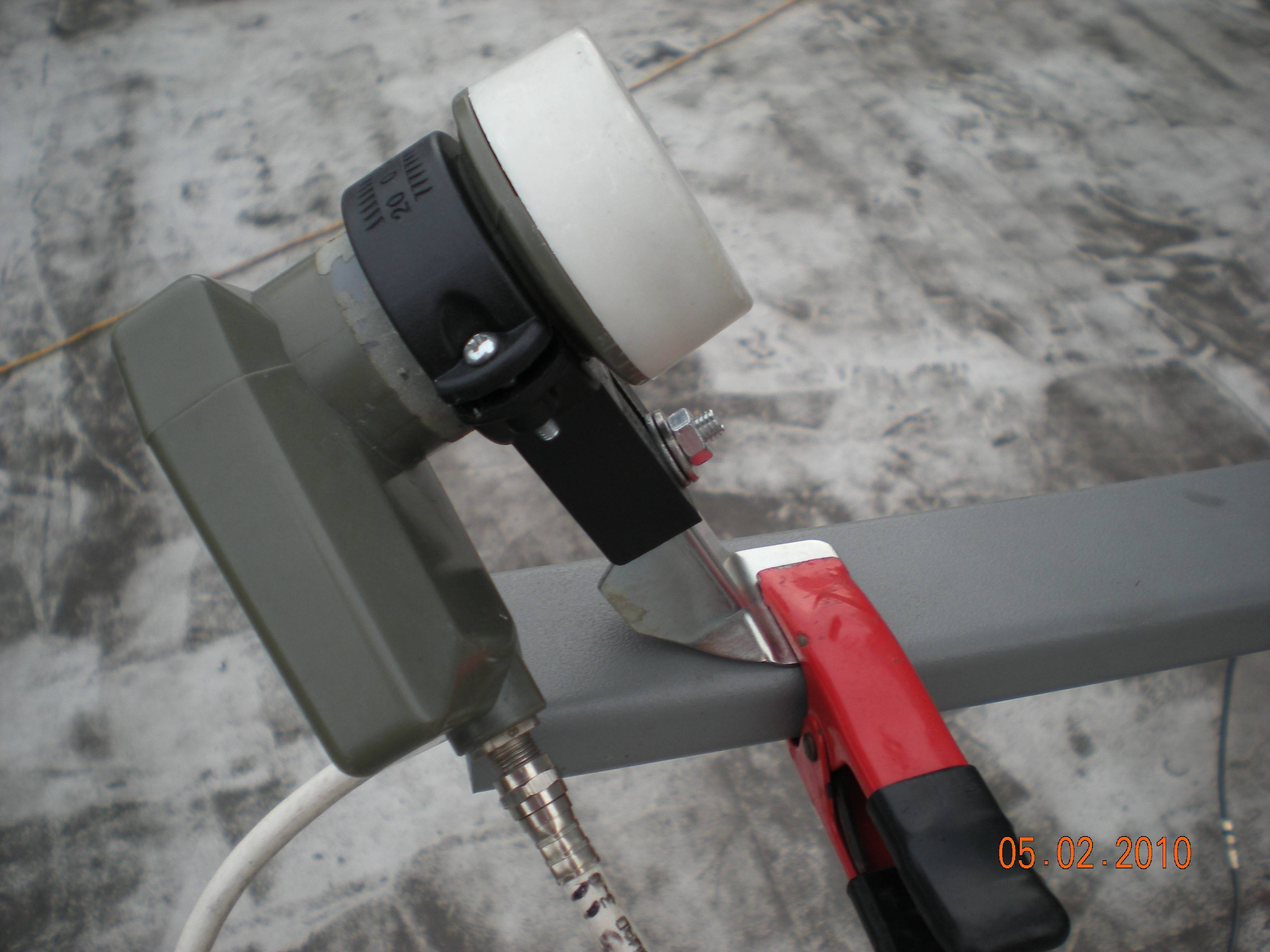

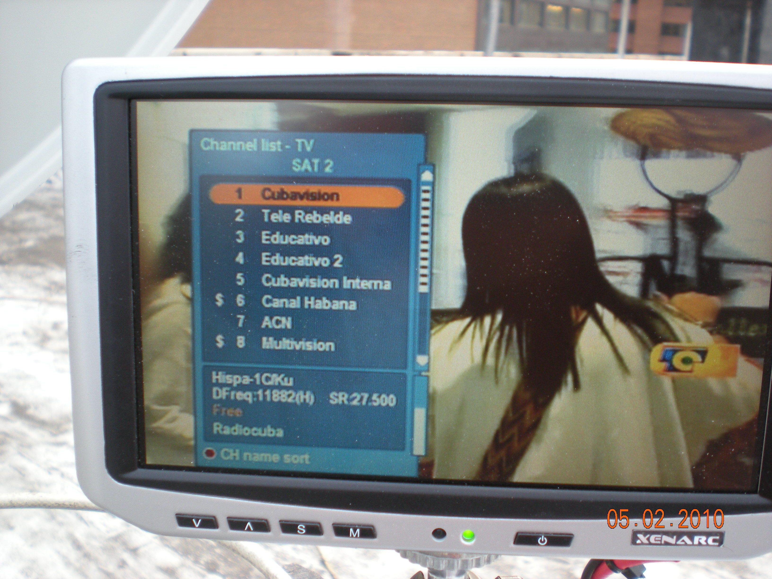

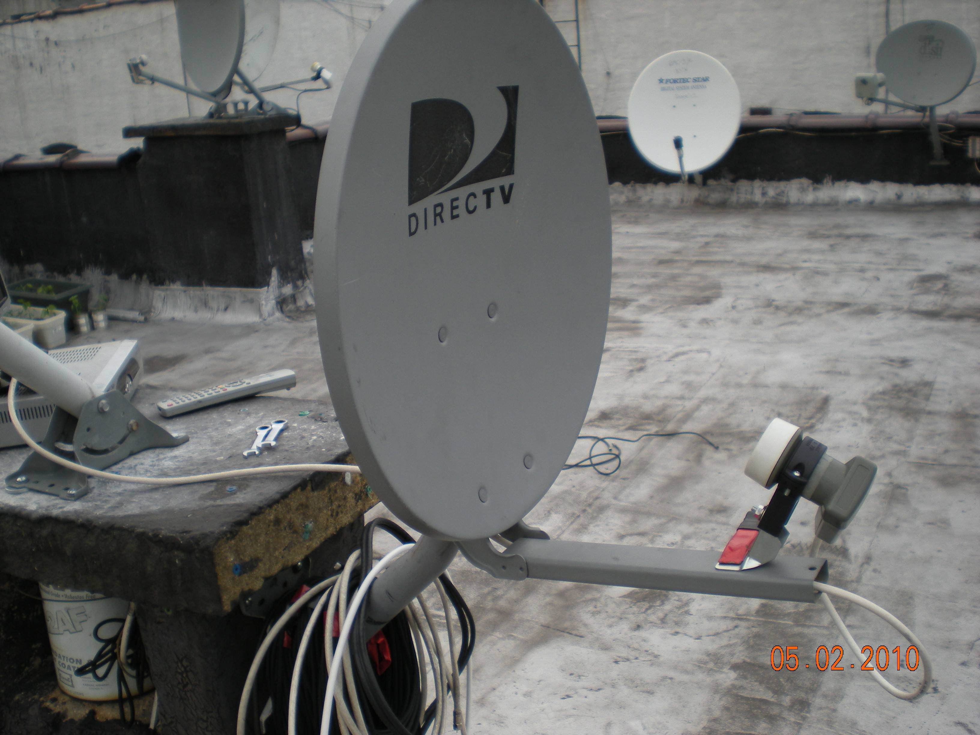

It was a wonderful day in NYC so I took my chances on 18 inch dish.Like I expected it was a full success.
I was able to lock on T-12, Hispasat 1C/1D.Most transponders gave me 40-60 SQ so it was all right to watch.On the rainy day it may be a different story but I took this test to see by myself if it is possible.
I would not recommend this way for permanent installation but if you in a harry on sunny picnic day in some park with clear view to Clark's belt then you will be OK to entertain your guests.Here are some pictures

Good work sathen, a lot of us have tried that trick. Works much better than you'd think it might. Well, in good weather at least. Aiming the little thing is a pain sometimes though.
Nice job Sathen. It puts a use to those pie plates all around. My Anik mini dish went out in a big storm the other night. But so did all my ku dishes. C band chugged along though, always does. If you don't need 24/7 access to stations an 18" will work too. For the most part I'm satisfied with my 21.5" mini dish. :)
Nice job! I didn't even know receiving T-12 @ 15 degrees was even possible in North America. Since I live in Pennsylvania I will give this a try.
