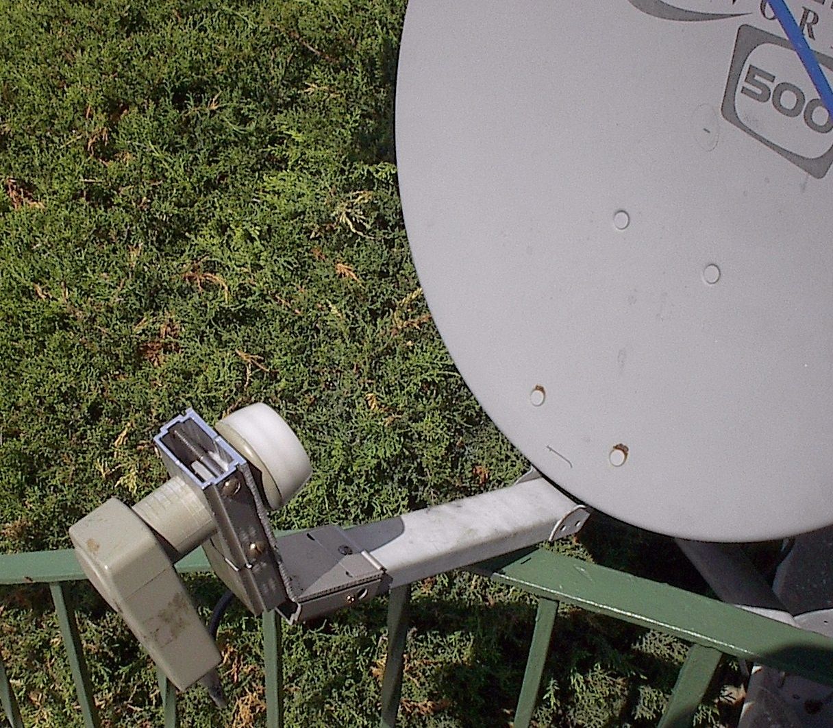

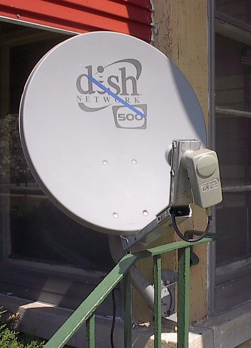

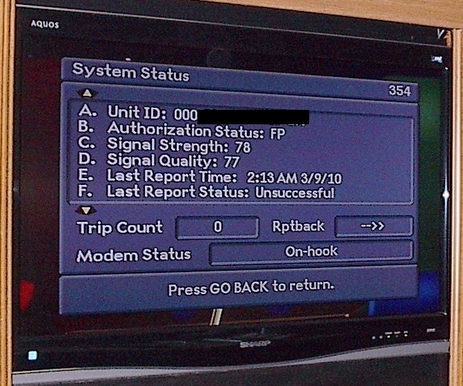

Today I put up my modified Dish 500 with a linear LNBF up. I ended up with a 77-78 quality +8.0 EBNO. Not bad for a 21.5" dish in the U.S. Im very pleased with the results. Now that free's up my second LNBF on my 84cm ADTH to point at something else. I now have a total of 5 dishes up :D Never can have too many.

Now that's a sturdy LNBF mounting clamp!

what kind of signal is that, pro? The blue screen looks like something with a descrambler, modem and rept back, etc.....I'm puzzled.
edit: Disregard, I looked up on lyngsat....lol.

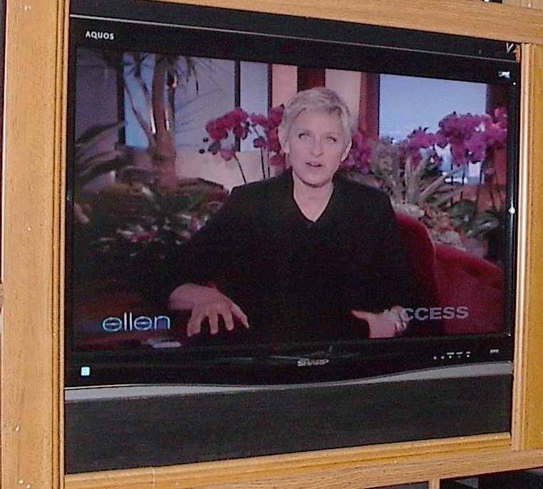

Ok, I never realized that "Access" had such good programming. Perhaps I will setup a dedicated dish for this satellite as well.

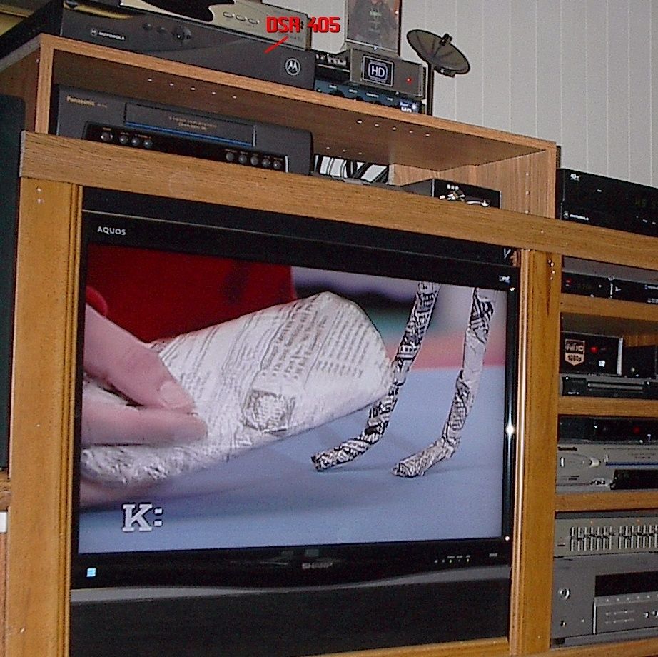

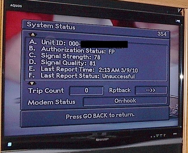

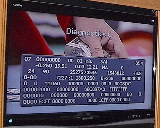

Checked the signal today on the mini Ku dish it was even better. For what it is it sure is doing a wizbang job for ANIK F1R on the DSR-405 :)
If you want to pick up a used Starchoice receiver and use a Dish 500 dish with a linear LNBF it should do a good job in most of the northern half of the U.S.
Shaw has an excellent picture quality too. My DSR-405 even has S video out just like my 922.

Ice have you ever seen any stuff go FP where any box can get it like if there having problems on Shaw? Any free previews on an subbed box probably go to "U" mode. It would be interesting to see if a box that was just unsubscibed would pick up the "U" stuff. I think once it goes OC (old category) or old monthly keys. It can only see FP and ZK.
