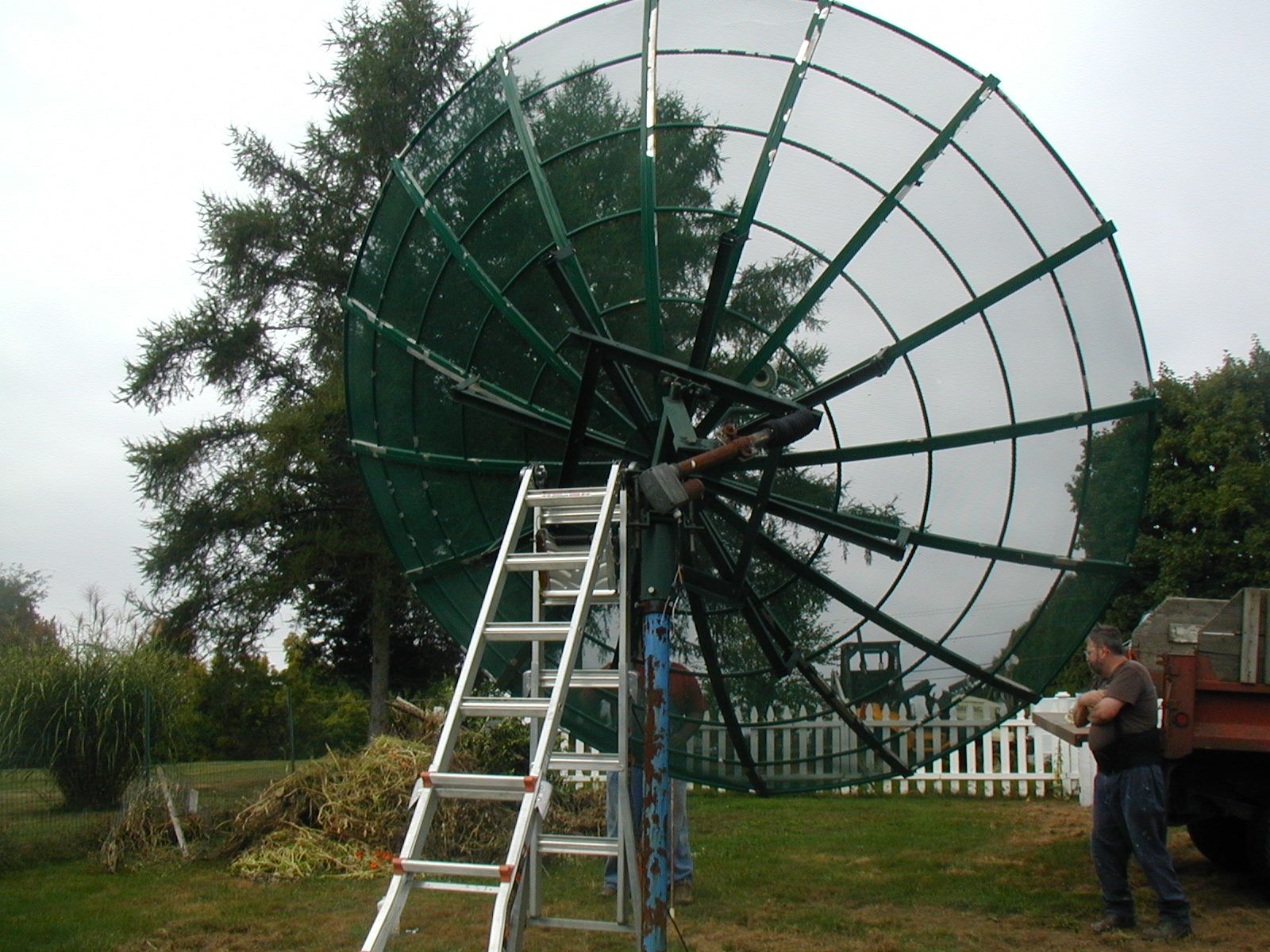

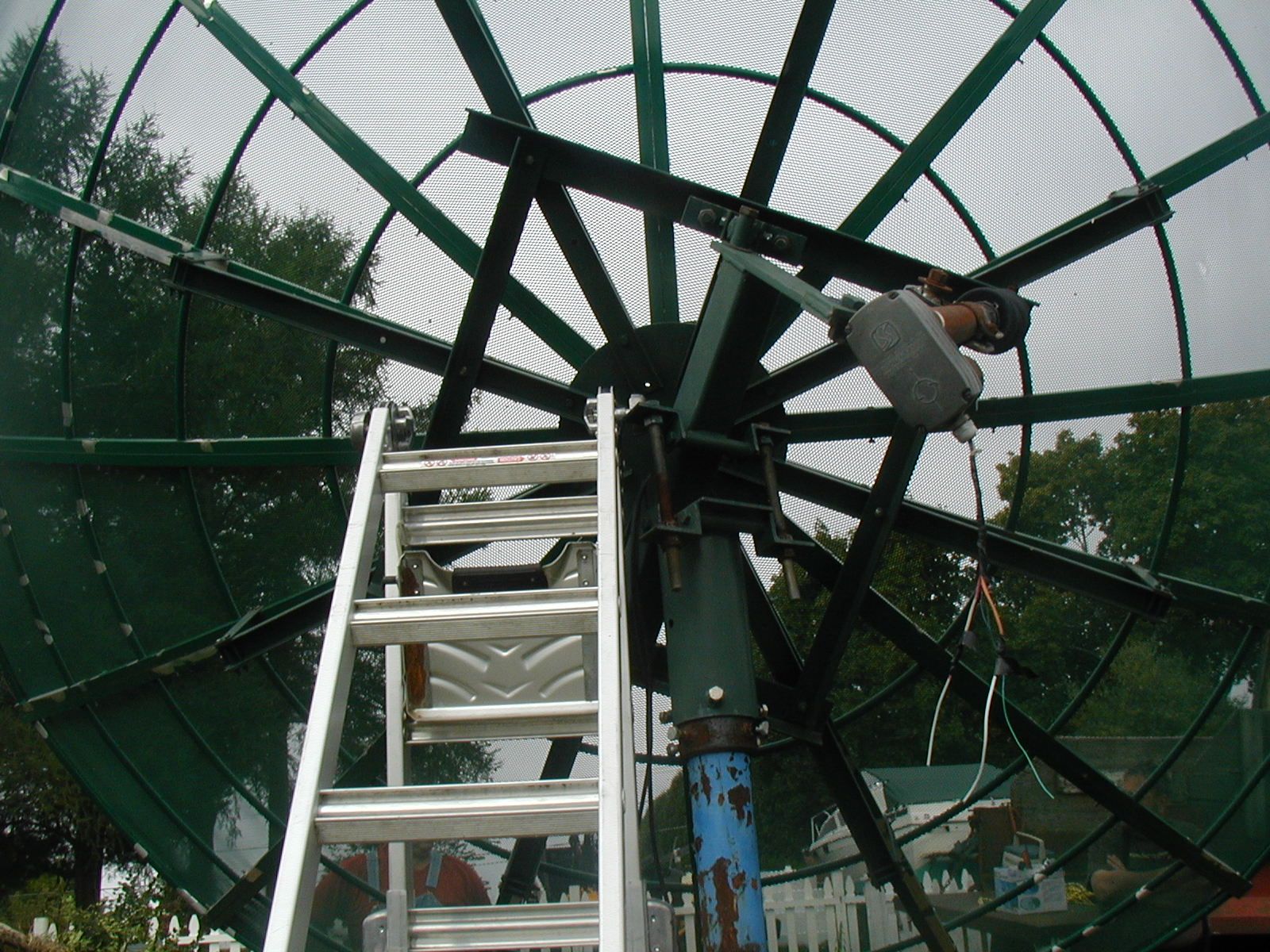

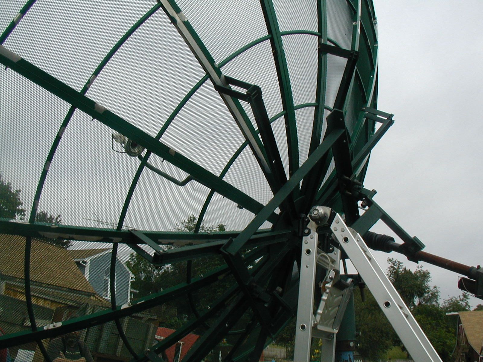

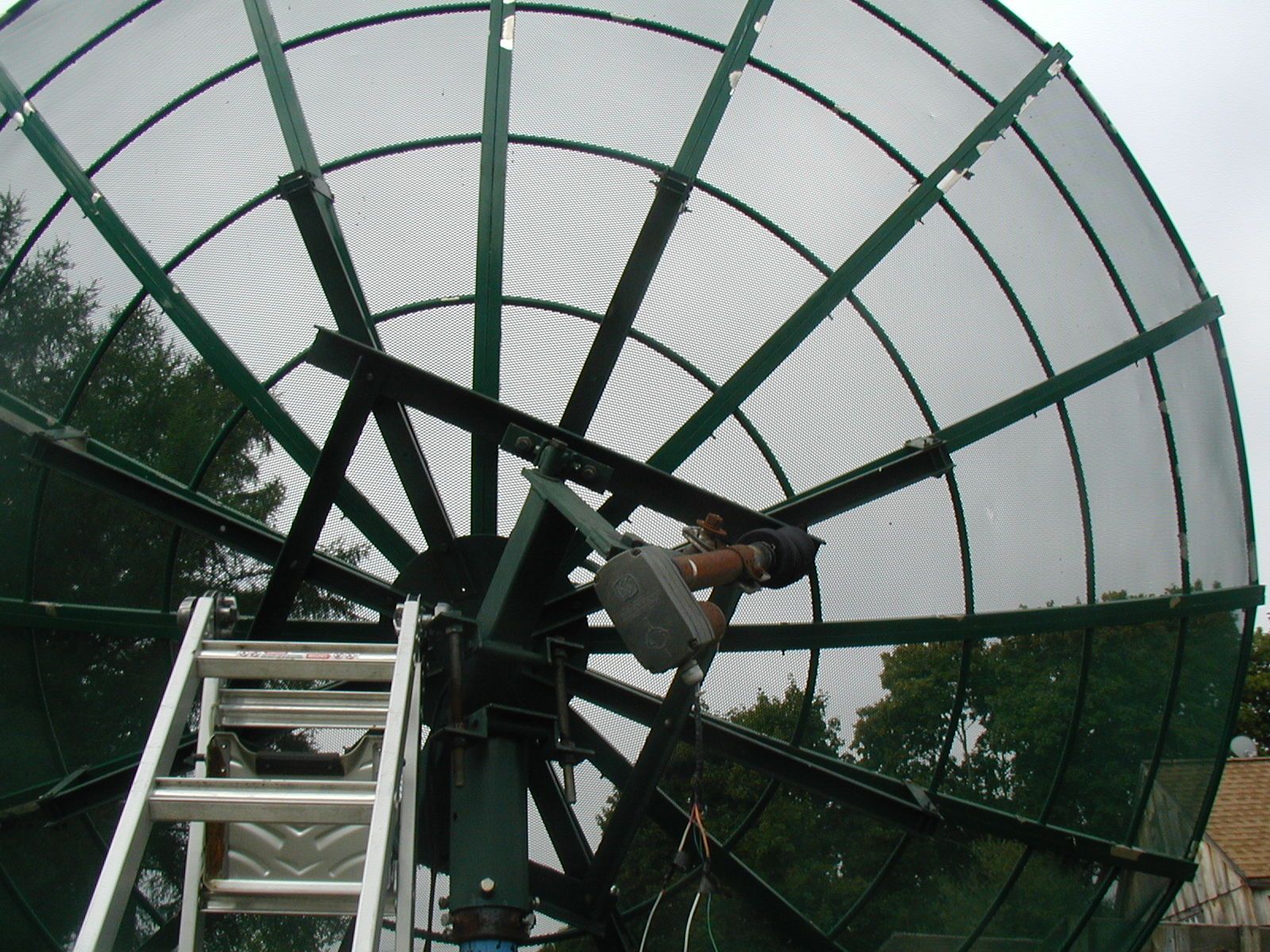

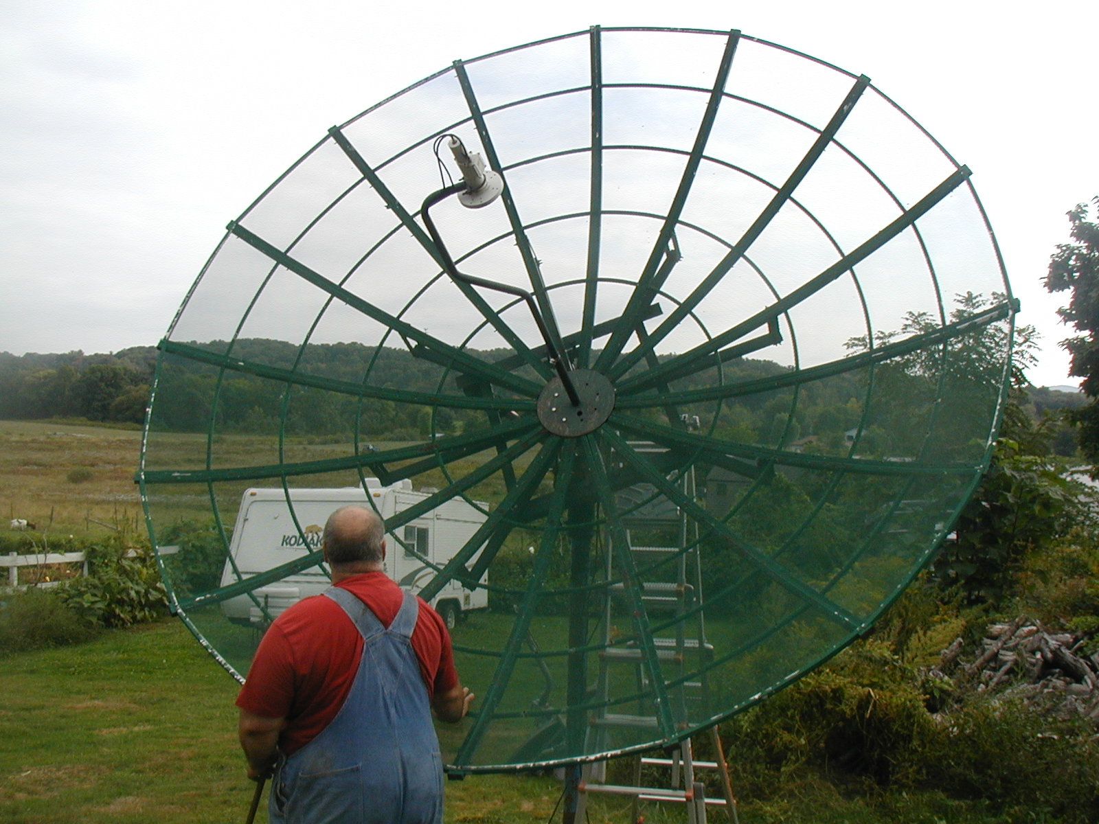

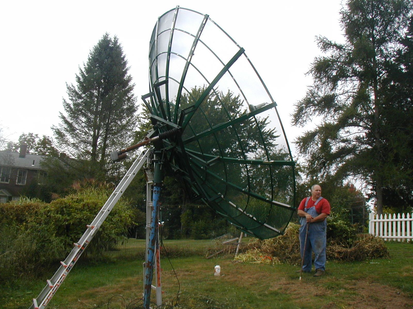

The 12' dish that I just picked up this weekend looks like it might be the same as yours, the guy that I bought it from said it was a Conifer.

Yup, that's a Conifer all right! Had a couple of those given to me a few years back then the guys brother screwed me out of them by scrapping them before I could get back there to pick one of them up.
That polar mount is one heavy MOFO too. After I got the dish off the polar mount 2 ppl still couldn't get that mount off the post.
I finally threw the button hook from that dish away about 6 months ago but still have the old cband feed horn here in the shop.
Like so many others I've seen, I see the actuator is mounted up side down on this one also! One of the two Conifers I was given had a Von Weise mounted up side down also and water got in it and really horked it up. I saw one back a year or so ago that had gotten water in it then it froze and split open the gear box!!

I can confirm that the polar mount is heavy, you got that right! It took three of us to lift it off the pole and the thing is like 3'x3'.
Is the actuator mounted wrong, or is that the way it's designed to be mounted, or is it that it should be just flipped around with the motor facing up?
Well, if you hook the pole up to your bumper on a car or truck; it will break a car or truck bumper right off (i have tried). Do you know how heavy the pole and concrete are? To get it out of the hole; you need to sledge the concrete into small pieces...The dish (a 12') should work for C Band ONLY all the way to Alaska! Now, I just cut the pole off at ground level and remove the dish; WHOLE and still works!
