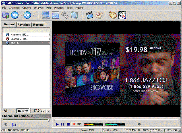

I've done both with DVB Dream, but I think it may depend on the codecs you have installed. I'm not sure if they came down with the install, but I have a choice of InterVideo or Elecard which both seem to do the trick.
There is a 'new' new version out as of today (v1.2b).
