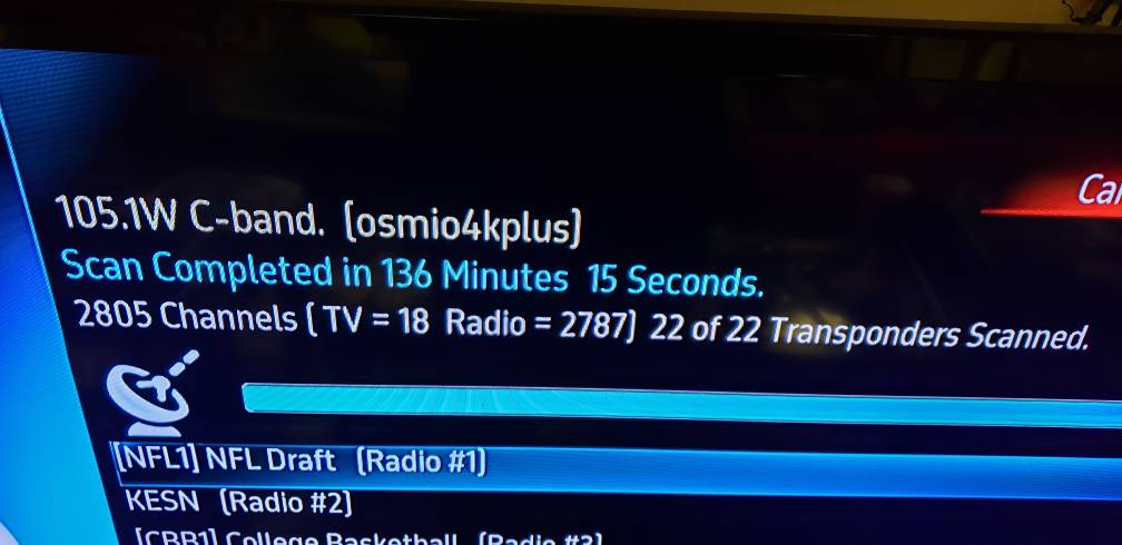

The blind scan issue has been fixed apparently and I noticed that this box is significantly quicker than the Octagon which was no slouch. Had a bit of trouble with all the radio channels on 105 as it was taking too long to log them all in so I did that one transponder by transponder. Channel changes are significantly quicker than the Octagon taking a second or less whereas the Octagon was significantly longer. I have tuner A set to the c-band dish and tuner B set to the Ku dish. Although my Zegemma was also a dual tuner this is the first time I've run KU and C off of one receiver. Took me awhile to figure out how it liked the LNB settings but once I did that it was off to the races and the box effortlessly changes between tuners. I haven't tried to set up recordings as of yet.

There is a good way to blind scan the thousands of radio services on 105w. This incredible number of radio services can be quickly logged by selecting All Services rather than the FTA only scan mode. This selection reduces the blind scan and service scan time to approx 4 minutes vs the 1/2 hour if each of the 3000 services are analyzed and sorted for only non encrypted services. This work around works well since there are few encrypted services on 105w and there will be only a few scrambled channels to edit from the service list.

I had time to make and then bake a cherry pie...lol
