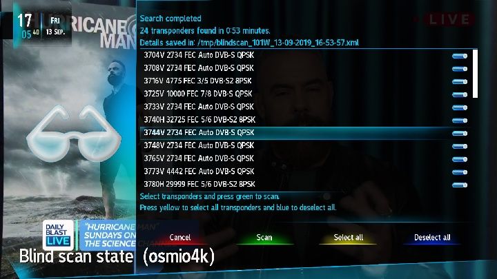

No problems with either listed TP or services during a Blind Scan.
Maybe local interference as both of the problem frequencies are vertical polarity and within 14MHz of each other?
Blind Scan Results: 101w C-band - 53 seconds TP Log
Blind Scan and Logged Heroes on 3744 V 2734
24TPs / 35 TV / 0 Radio

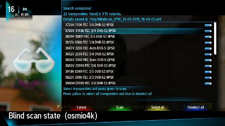

Blind Scan Results: 97w C-band- 71 seconds TP Log
Blind Scan and Logged Azteca Services on 3760 V 31456
22TPs / 67 TV / 3 Radio
