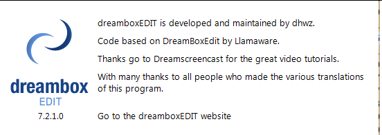

I utilize dreamboxEdit. I use this for my Enigma2 receivers, and use it to update my channels etc. I find the program user friendly. I use a windows program... They might have a linux version, but not sure.
I've used it in the past and eventually I got error messages. I don't remember what those messages were were it seems some data got corrupted.
Used if for years.. Not sure what problem you had, but I have had no issues with this channel editor..
