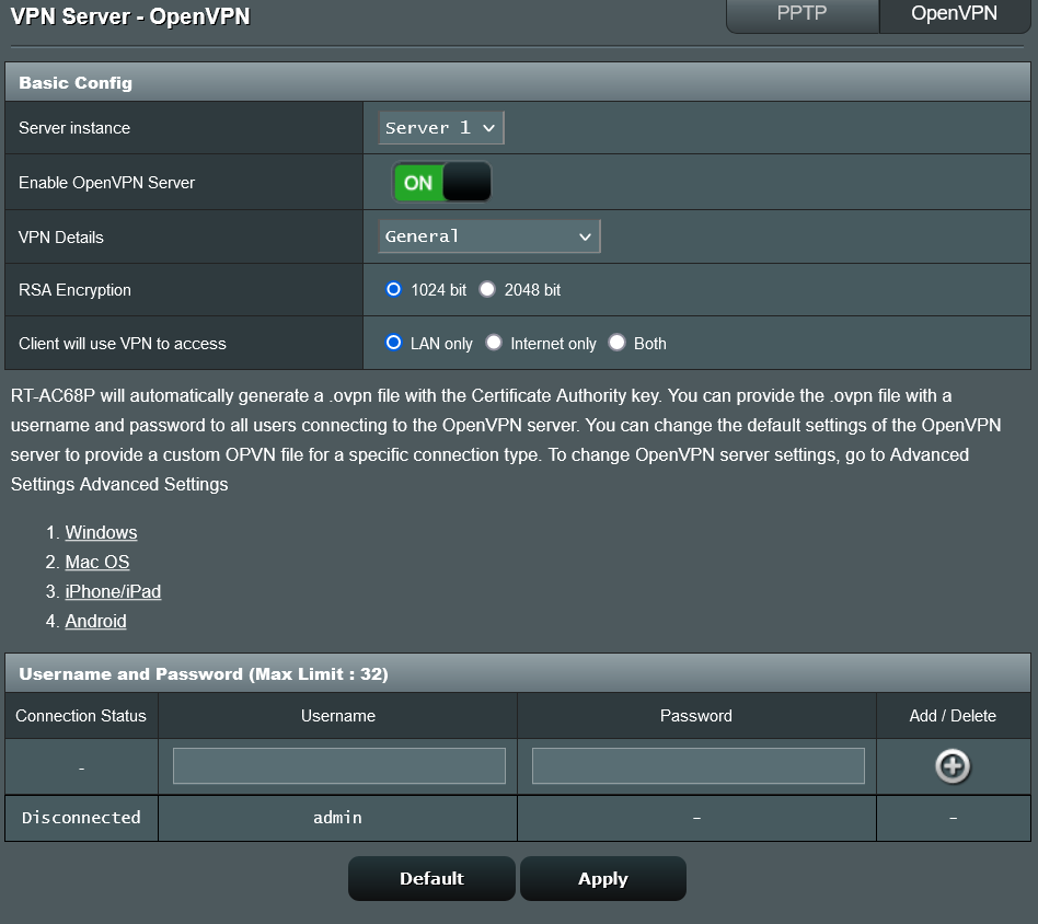

Openvpn is the easiest to setup. Really. If your router has the feature.
There are a few quirks such as your ISP will roll your public IP address once in awhile. So reading up a touch on dyndns or similar will assure that you can connect to your home network.
Or like I've done before setting up a dynamic dns. Call you ISP when you can't connect and ask for your home IP.
Wireguard is a bit more complicated to setup and use. It does hinder network speeds less, especially if your router is an older one that lacks the 'oomph'. My newer Asus router seems to stream fine from my osmio with openvpn. I mean. NASA UHD on 127W burps. There's a lot going on there. Of course your available broadband speed on either end makes a huge difference. Streaming at a motel or campground wifi from your home vpn net will be understandably balky.
My older router running custom firmware in the shown image runs a VPN. Nord is what I use currently. In client mode it's pretty good. Just don't get caught up in vpn services with their own router firmware.
I did that once and it didn't last very long. I think ExpressVPN had that.
You would probably turn the client side off and turn the server side on if you need to get into your home network.
I haven't tried using both simultaneously.

Openvpn as you see in my previous post is a breeze (almost) to setup and use.
