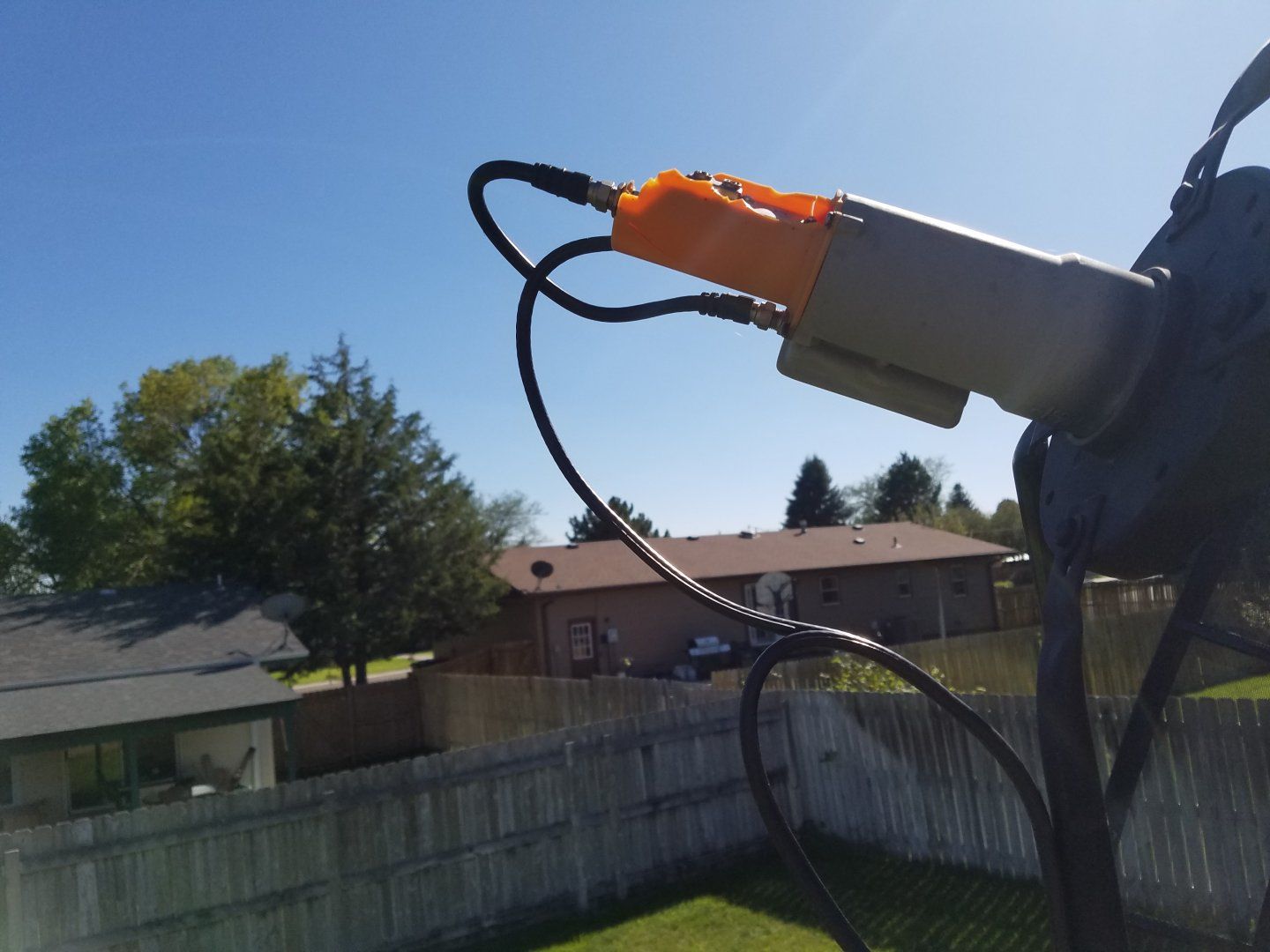

I'm beginning to think that the LNBF isn't consistently changing polarities. The polarity voltage is changing like it should. If the LNBF is the problem, it's intermittent. The LNBF may have been damaged by the hail storm after all. It doesn't look damaged but we did get some hail about the size of golf balls. I don't think I have a spare laying around and the dual-band LNBF on the other dish is definitely hail damaged. You should see my roof and gutters.

It seems that I think differently from some of you guys. The image of the C/Ku LNBF is on a different antenna than the one I'm working on in this thread. The antenna that this thread is referencing has a Titanium C1W-PLL installed. I just uploaded the C/Ku LNBF image to show how damaging the hail storm was. I probably should've put the feed covers on both antennas. Anyway, I ordered a replacement Titanium C1W-PLL LNBF from Amazon. It should be here Monday.

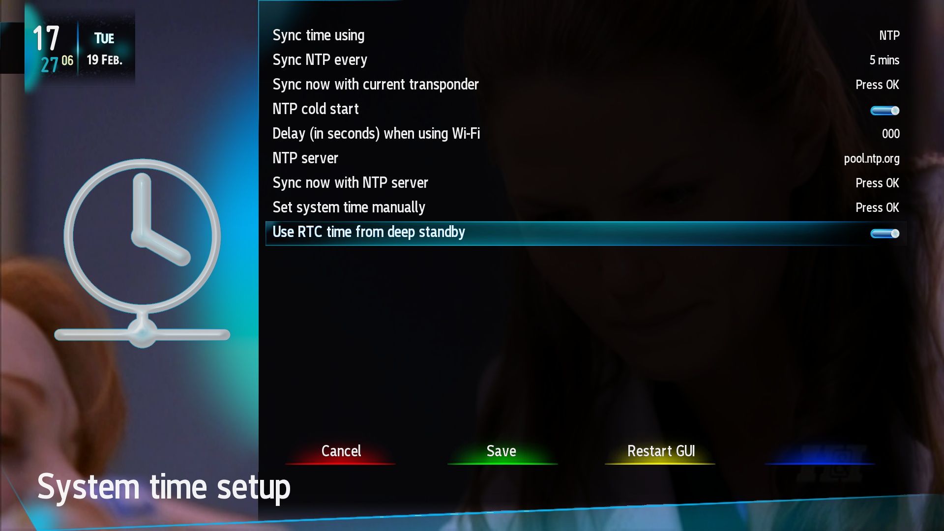

If you put your STB in standby or remove power, the time reference should be enabled for start-up. I don't believe that is the OpenVIX default.This setting will cause the time to jump.
Set your Time settings like this. This screen is from NA SDGr, but it's similar in other images.
RTC time, and NTP Cold Start need to be turned ON.
Reactions: Titanium
