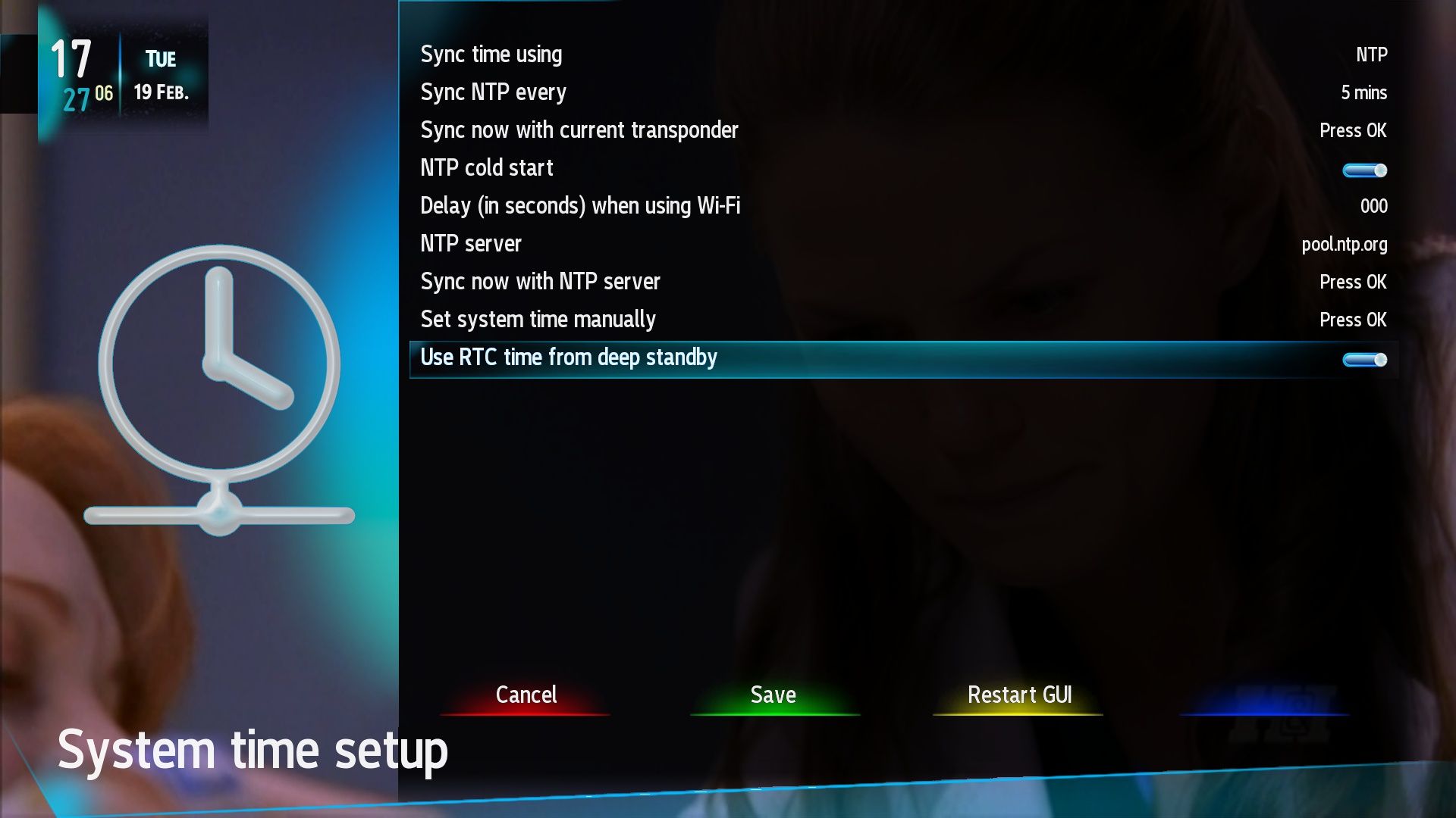

Thanks primestar31 for the TNAP setting. I don't use OpenVIX enough to recall the menu path, but I know that this user setting keeps perfect time when selected.
I'm quoting your post so Johnnynobody will see your post if he has you blocked... [emoji54]
Set your Time settings like this. This screen is from NA SDGr, but it's similar in other images.
RTC time, and NTP Cold Start need to be turned ON.

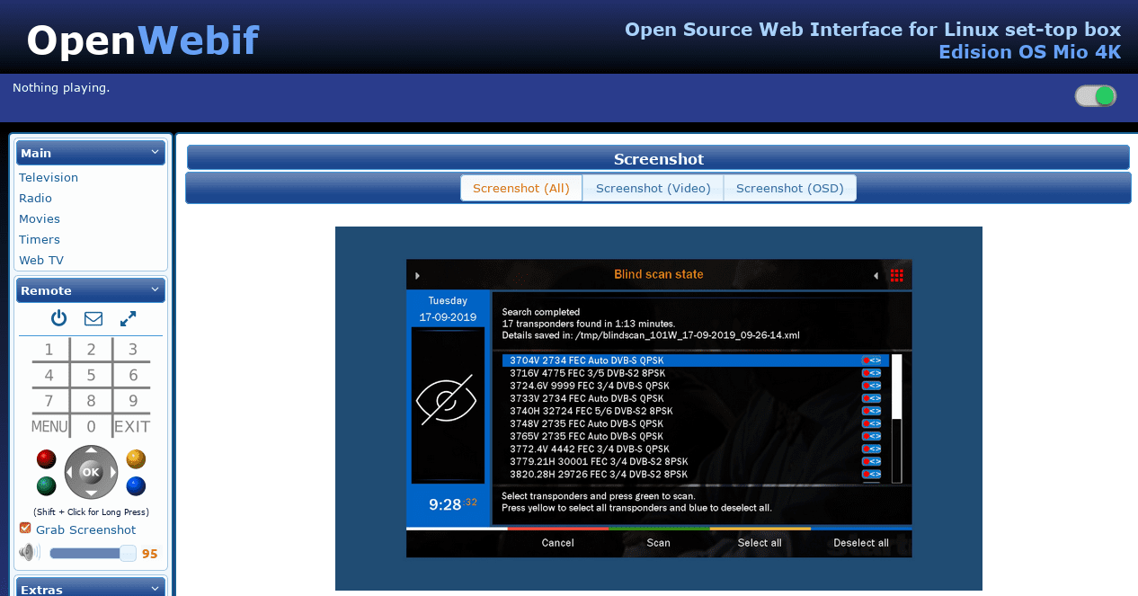

johnnynobody, In TNAP on 101w C-band, please do a Blind Scan >>> Transponder>>> Clear Before Scan. Once all TPs are logged, do a screen capture (with WebIF) of the logged Transponders and the Logged Service. Post like I did in post # 20 above.

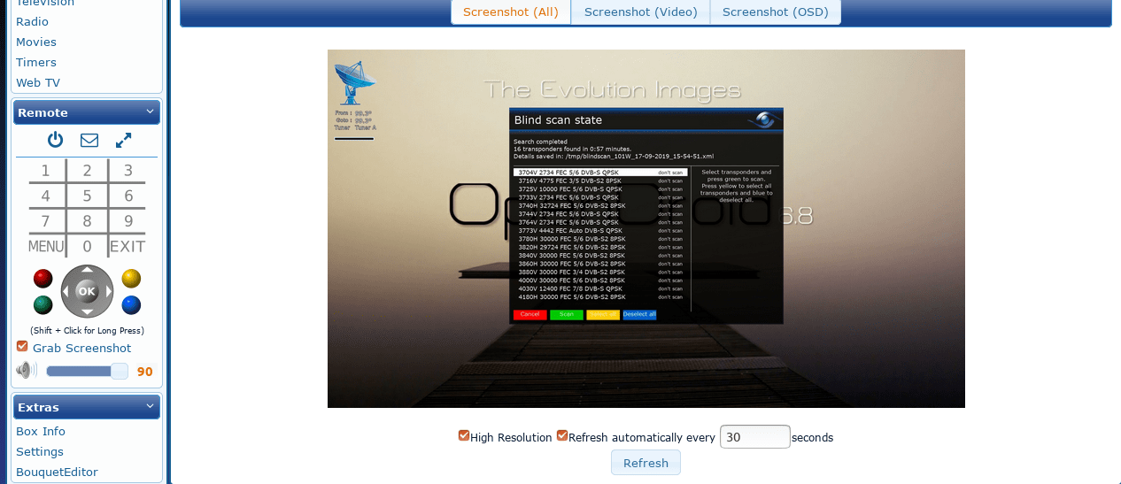

Thanks, for the screen capture. I see that it logged only 17 transponders and missed some fat TPs as well. Not sure what image was used, but this isn't TNAP image (The North American Project).
Could you perform the transponder scan using TNAP so we can compare apples to apples? If there isn't something obvious, we can compare the details in the saved tmp .xml file.

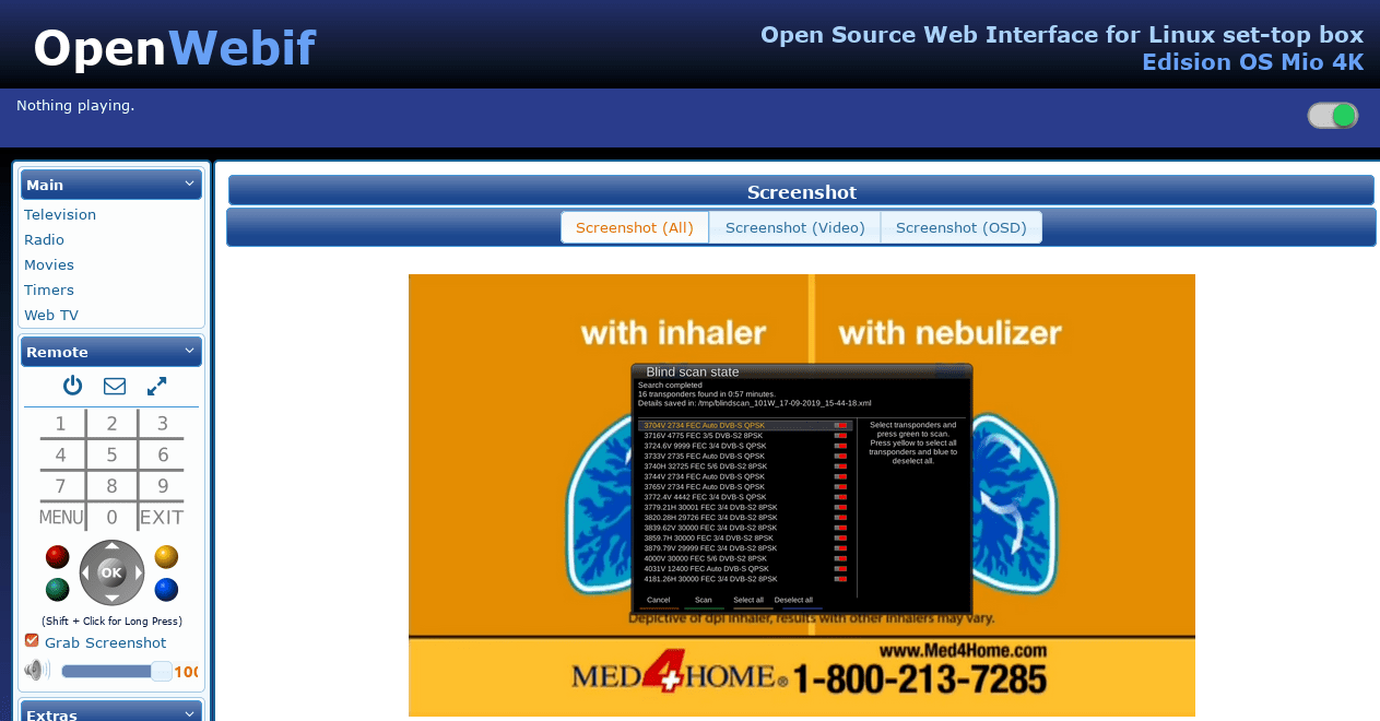

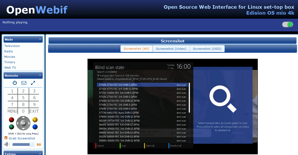

It is from TNAP. That's the way the image boots up. But, slot 1 is identified as SatDreamGr. Anyway, I've included scans from OpenPLi, OpenDroid, and OpenATV also.
