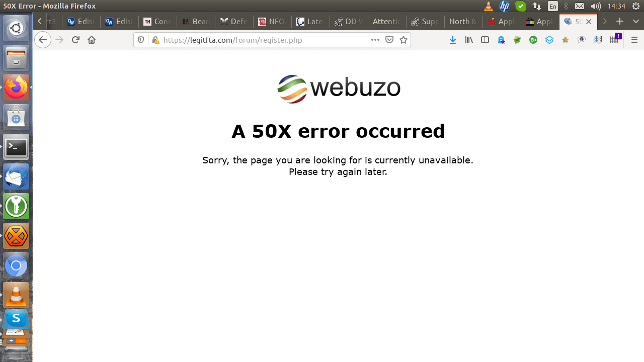

I still can't get to legitFTA. I get the same error no matter which browser I use. The error I keep getting is : A 50X error occurred.

I still can't register at legitfta. Quitting.

Johnny, have you tried Legitfta on a pc that's NOT running Linux? I haven't heard of that error often, but when I have, it always seems to be related to Linux in some way.
Just throwing that out there, as I don't know for sure.
Didn't make any difference using Firefox 70.0.1 on Ubuntu Linux or Windows 10. There are other browsers that I could try but it is my opinion that web site developers shouldn't optimize their website for just one browser, anyway. I did did send a message to the admin to see what they say though.
