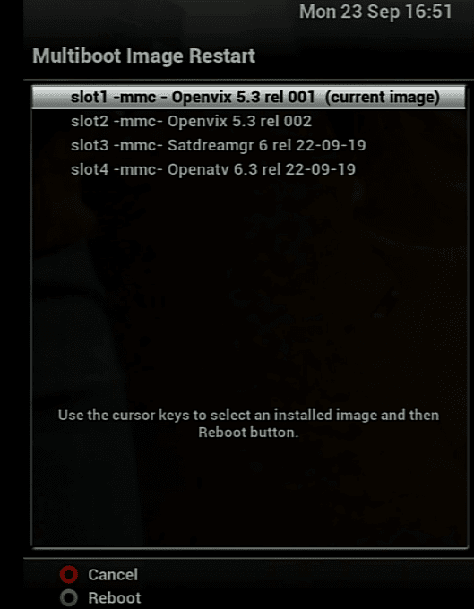

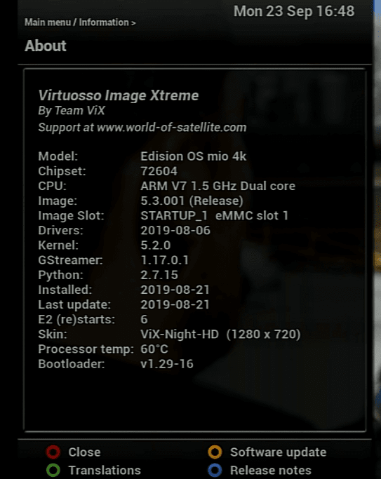

It jumps all over the place. Sometimes it's the correct time then a few minutes later it's way off. It comes back to the correct time and jumps to some way off time. I did pull the power cord to completely power off but it didn't fix the problem. It is wired ethernet using NTP.n Now here's another issue, I had OpenPLi in slot one but somehow OpenVIX overwrote it and now it's showing in slot one and slot 2 in the multiboot menu (see attachments). It was originally in slot 2 only.

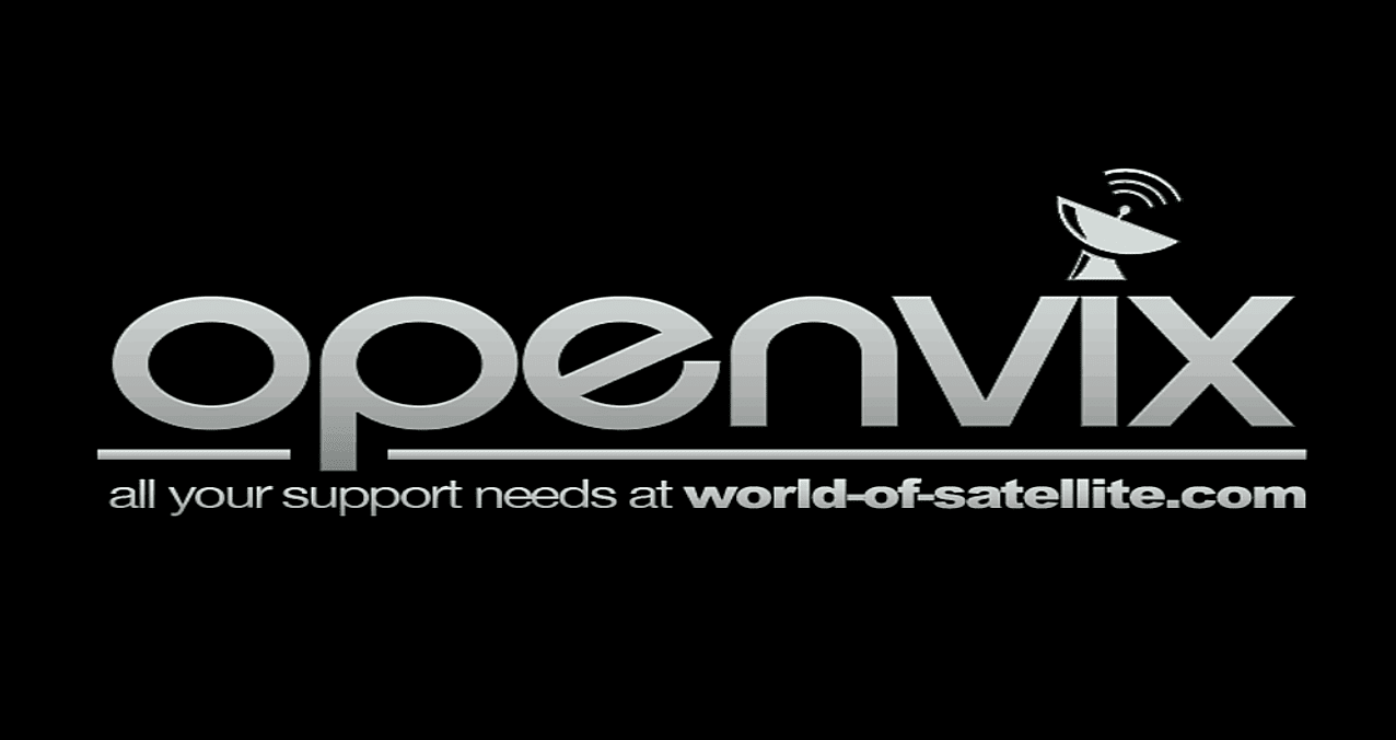

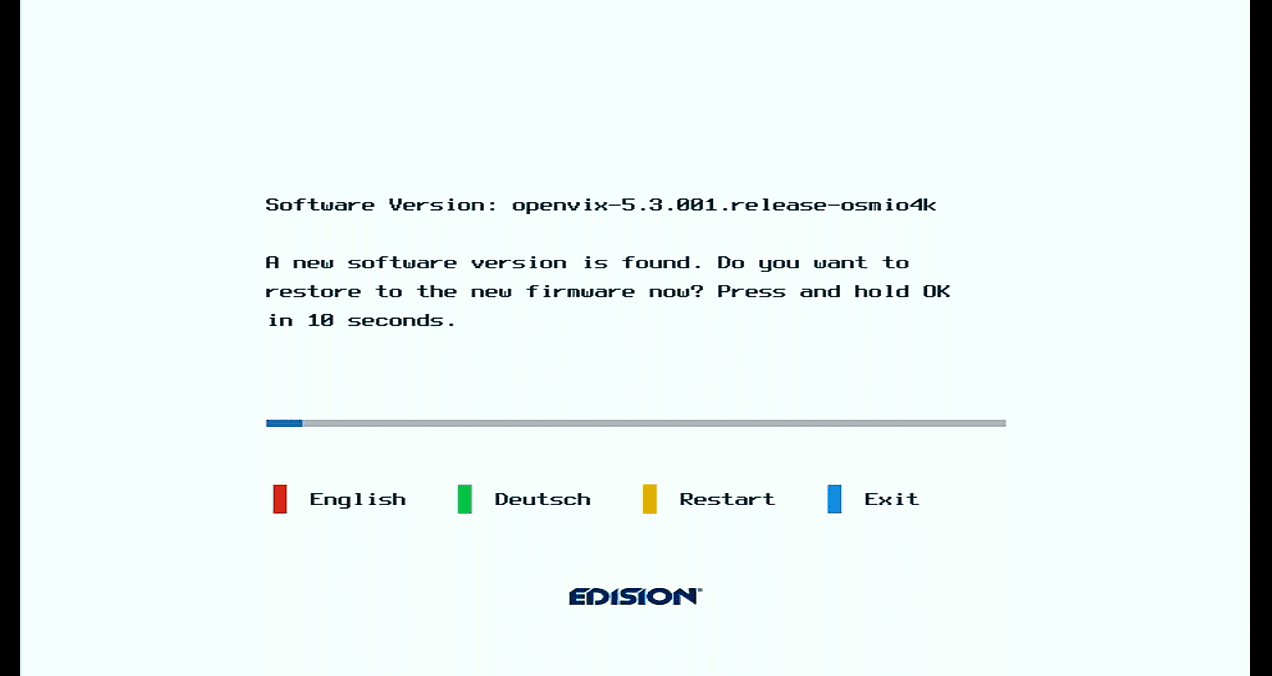

After removing OpenVIX from the 2 slots, I'm getting this nonsense (see attachments) after rebooting. I'm "done" with OpenVIX. Edit: turns out the second image below was due to a thumdrive with osmio4k folder with OpenVIX image in it. I still get the first image on reboot.
You had to flash emmc open vix to get the splash screen installed. All you need to do is make sure to be booted in slot 1 and then flash emmc openpli 7.0 release and the edision splash will be back.

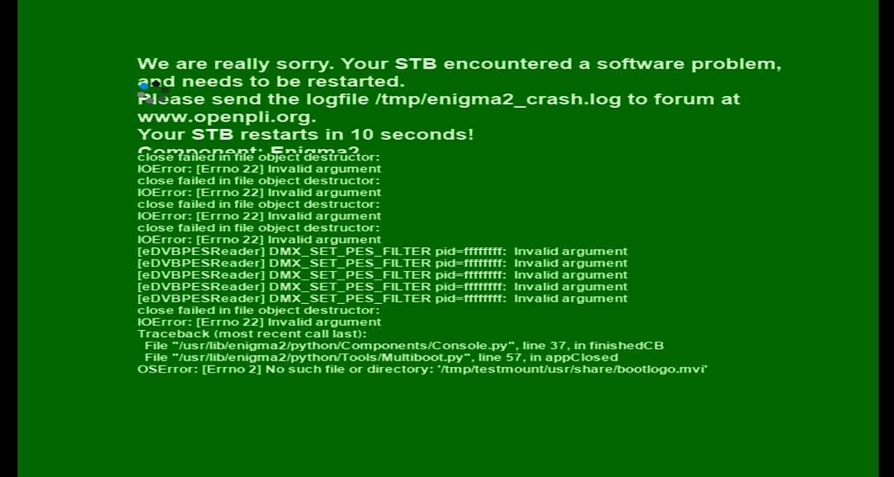

Here is another issue. I'll consider reporting this to OpenPLi. Anyway, when I select the Multiboot menu the attached screen shows up. After the restart I can select the multiboot menu without the crash message. This happens in the OpenPLi image only.
Does it have to be 7.0 or can I use the latest 7.1 stable release to do this? I'm assuming that I will need to download the non-multiboot release?
7.1 has an issue with the TNAP image and multiboot so use 7.0 release if you are going to have TNAP in another slot. Yes non multiboot.
I guess I'll roll back to 7.0. I know that there is a problem with 7.1 crashing when bringing up the multiboot menu and it looks like they're still trying to fix the issue.
