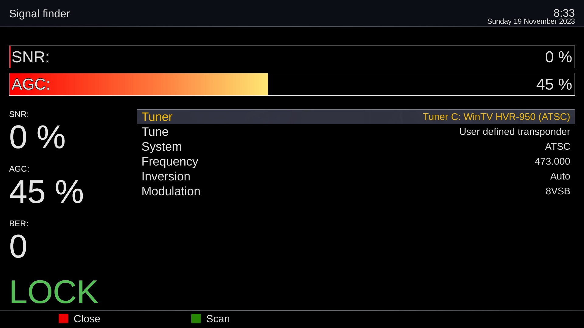

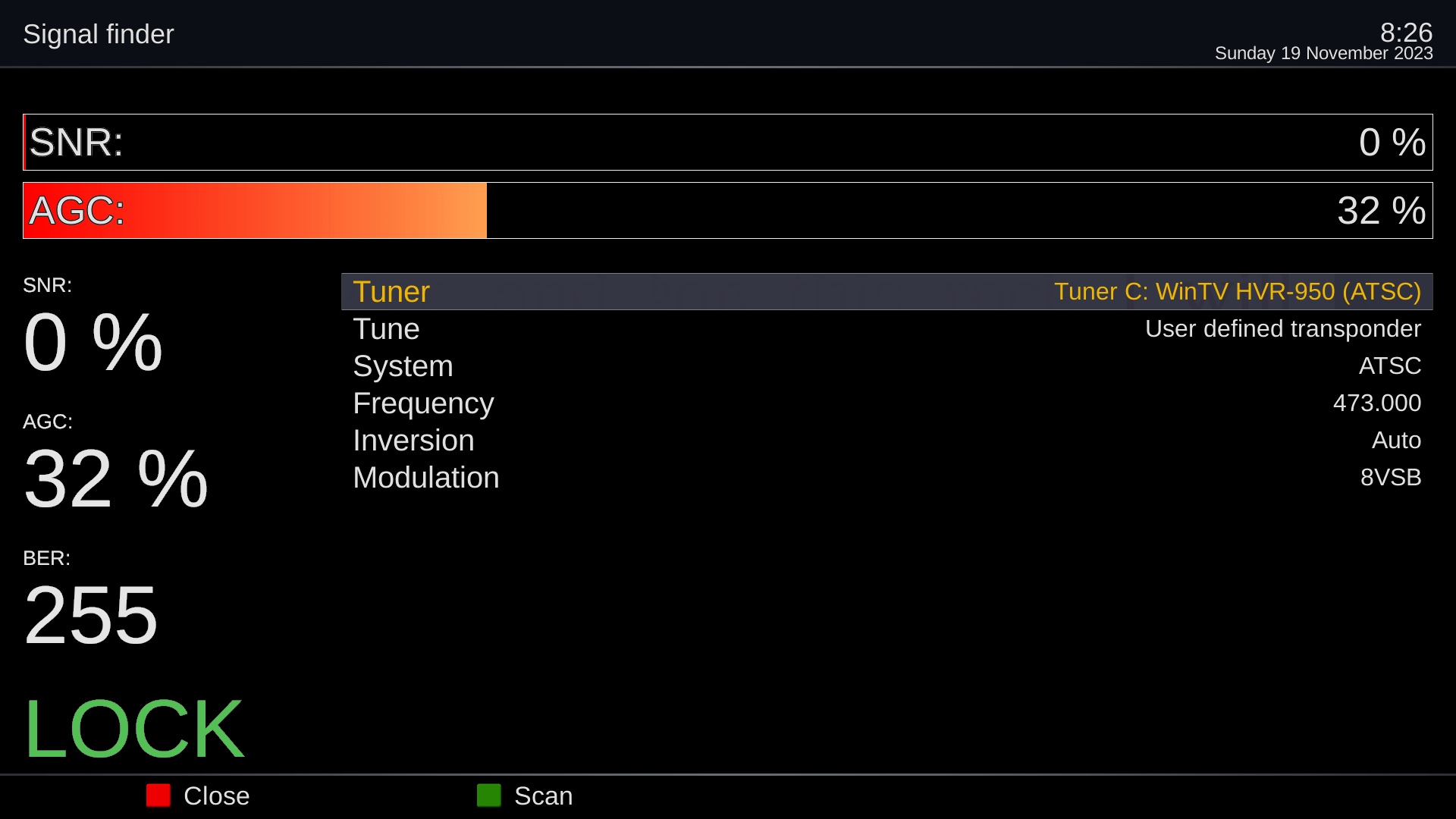

ADDED: Image shows current signal reception from KVOS in the pouring rain. No reception right now though it is locked with AGC action. When AGC reaches about 45%, then I receive the channels perfectly.
Heavy rain (no reception):
Rain almost ended (Good reception):

After trying the antenna 20 feet high on a mast, I quickly discovered height is not what counts in this situation. There was zero signal at 20 feet. But at about 4 feet off the ground, there is solid signal much of the time. Sunset time is tricky since the signal seems to drop out then briefly. During rain, I can also lose signal.

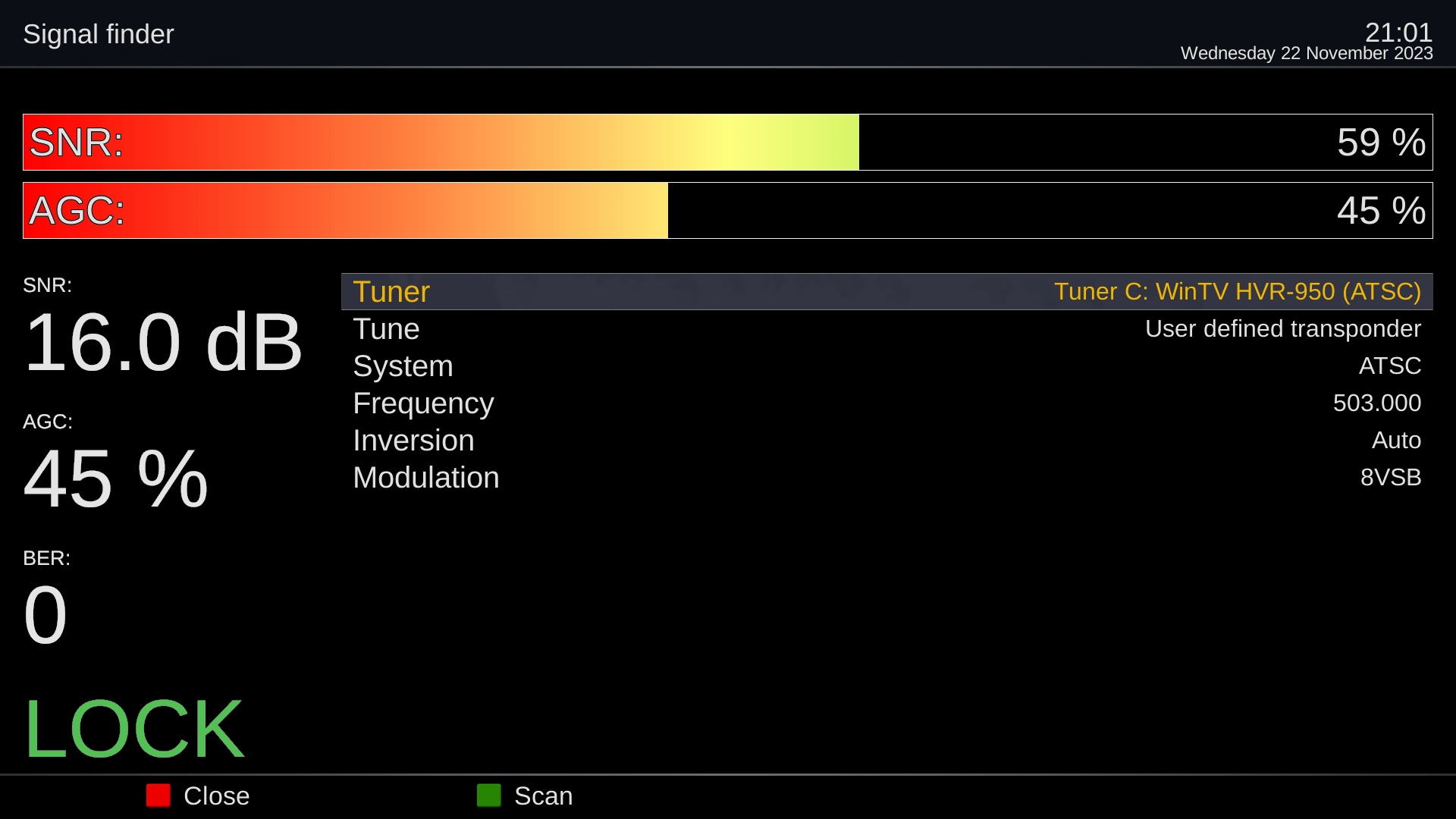

note that some newer E2 images like TNAP 4.2 and TNAP 5 show the SNR measurement, just like they do for satellite reception. Might be worth installing one of those in a spare slot just for that purpose
Glad you told me that. I've been looking for an excuse to update to TNAP5. I did and SNR now shows! My "local" station in Victoria, BC (CHEK 6-1 on 485 MHz) about 66 miles away is 16.0 dB in the rain. KVOS 12-1 to 12-7 on 473 MHz and 77 miles away is jumping around from 13.0 to 15.2 dB. At this peak SNR then KVOS becomes visible. After the rain when the signal is stable, I can try peaking the antenna again using SNR as a guide.
Reactions: Brct203

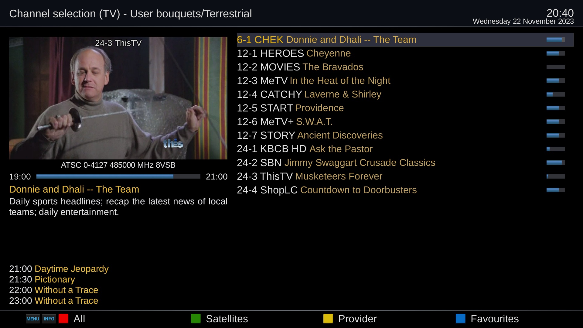

Today is a sunny clear day. So using the SNR as my tuning aid, I have scanned in a total of 12 channels. This includes new channels 24-1 to 24-4 KBCB at 503 MHz on the same tower but 150 feet lower down the mast from KVOS' antenna. I had never received them before. They are the weakest of all mentioned.
That's about all the channels I will be able to routinely scan in without freak conditions. Even turning the antenna toward Vancouver, it's unlikely I can get more since the strongest station is still 28 dB lower in fade margin. I'd say the Clearstream and Hauppauge are doing a great job!
