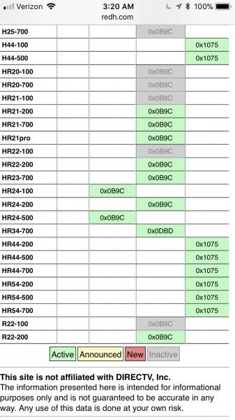

A couple of things to answer the last few posts, 0x1037 is in the stream M-F 3 AM to 7 AM ET, CE is Friday 11 PM ET to about 3 AM ET and again on Saturday (tonight). Last night 0X1075 was in the stream from 11 PM ET until about 3:20 AM ET, so when it ends is not an exact science as of late (see attached) as proof.
