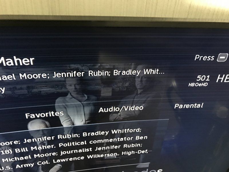

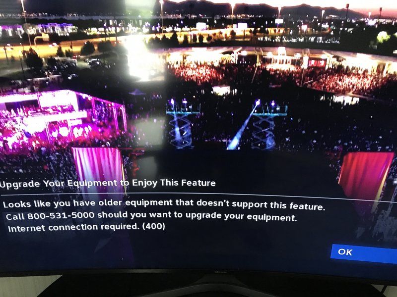

I got the 1101. pandora is gone and when trying to load apps like iheart or music choice it says I have old equipment and need to upgrade before the apps will work. also the faded black at the bottom of the screen and the top banner, is that supposed to have lines in it like a brushed metal look? mine does and I find it quite annoying. thought it might be a glitch so I rebooted but its still there. first time ive noticed it not being smooth. I do like the larger fonts but the guide is slower than 1088 & the menu freezes when in settings. takes around 45 seconds to over a minute for it to clear once exit is pressed. I have HR54-700

attached are 2 pics. one is the lines present in the menu info screens and the error when trying to access apps. is this happening to anyone else? not sure if the lines present in the menu system is part of their new design or a flaw in my download. if this is a glitch do you think a re download of the software might correct it? how would I get pandora back or did directv permanently remove it from their dvr's? also, I am connected to the intetrnet, even though my box says im not. when going through the steps to connect, it says connected.

edgecutter is enabled. my menu looks awful. my settings and recordings are fine but apps still wont even after RBR. I went back to 1088 hoping this would resolve the problem but its still the same on 1088. prior to the 1101 upgrade apps worked and menu wasn't distorted. im thinking about doing a complete reset and wipe everything, recordings and all but Id hate to do that if there was another way to fix this. perhaps I got a failing hdd.

No. You need to give it time to reload. Make sure the unit is off and no clients are pulling video off it. Also make sure there are no recordings scheduled for a few hours It will load And reboot on its own. It will not reboot if you are using a tuner. For example. After I downloaded last night I also had no apps and lo res icons. I cancelled any overnight recordings and turned all TVs off. An hour later the unit rebooted on its own and restored on demand. I turned the unit off again. About two hours later it rebooted again on its own and restored everything else.

and just like that.... everything is back to normal. it did take into the next day but after going back to 1088 the menu graphics smoothed out, internet stabilized, apps work and pandora came back. im new to all this so I appreciate all the replies and information given. now that I know a little of what to expect, when things like this happen it wont be such a shock.
