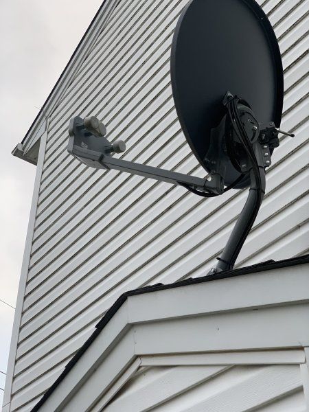

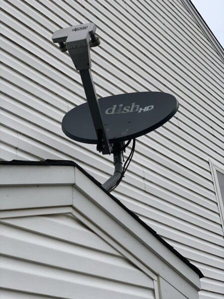

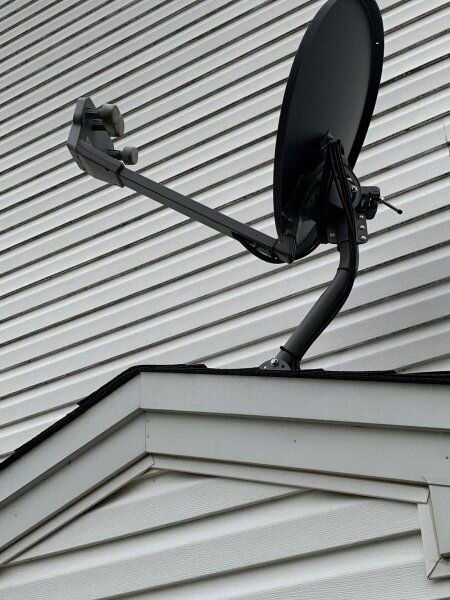

To the OP, do you know what Dish is on your roof? The tech might just be able to use it, if it's a 1000.2 and if you buy the OTA, then yeah, he'd install it because you bought it - which you can do when the tech arrives. Calling Dish to add it probably won't work since you apparently ordered from a retailer but you can try that but if you buy it form the tech, he get's a commission. Something too think about

I will be getting my locals channels from Cincinnati. I was using the google machine and I saw some posts that seem to indicate you need a wing dish to get sat 77 for he hd local channels. What is a wing dish and do you know anything about that?
The mast is good,. but the dish, which is a 1000.4 Eastern Arc, will get swapped for a 1000.2 Eastern Arc. No big deal. Real easy
A wing dish is a secondary dish used to pull in an additional satellite signal. The dish that you have on your roof now does receive the 77° sat, in addition to the 61.5, and the 72.7. The 77 is no longer being used, so no wing dish necessary, regardless. I do know some guys that put a 1000.2 lnb onto those 1000.4 dishes, but your tech will most likely swap the entire thing out.

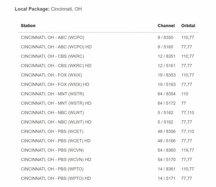

When you say 77 is no longer used. Is that in every market or most markets? I found this website and it may be old but it says 77 is used in Cincinnati.
Local Channels on DISH Network (Unofficial Listing)
Sent from my Pixel 2 XL using the SatelliteGuys app!
You are correct. HD locals are on 77, SD on 110.
My installer left the mast and struts and dish and installed the hybrid EA LNB with some sort of adapter/collar made for this purpose.
Yup.
Also, he didn't change the dish. He said I didn't need to replace anything.
