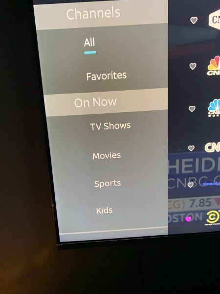

The only way to do that really would be to setup different favorite lists. One for sports, one for kids, etc.. Then you can switch between your different lists while in the guide.
This only allows you to sort high to low or low to high. Something similar to this would be more ideal:

When you're in the guide, press options on the remote and you'll see ways to change the guide. Also record Hopper 3 Insider on Ch 103 one time. It'll teach you everything about how the hopper works and the things you can do with it

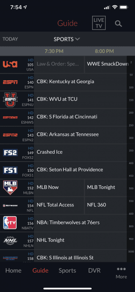

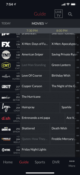

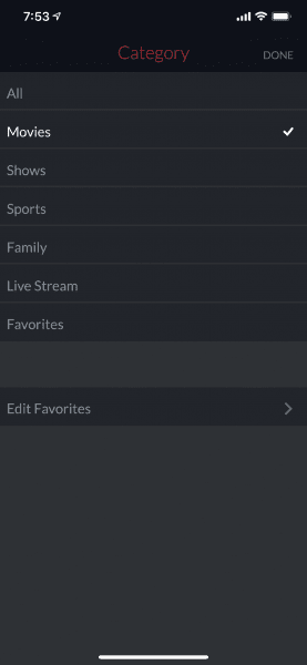

Did some playing around on the DishAnywhere app and the sort function I was looking for in the normal guide is built into that app. Wish they would have put that in the guide.
