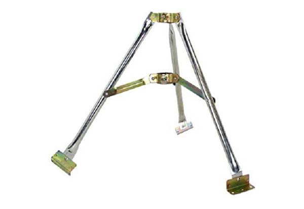

Do you ever recommend a tripod to new users?...so they're not going up and down ladders to the roof and it makes adjustments easier and more accessible.

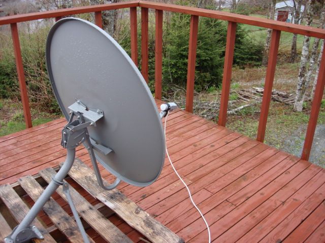

One of the best experimental setups I had was a palette ($0) sitting on my balcony with the dish mounted on a J-mount ($0) supplied with the new satellite dish. I could move the dish while looking through my house window at the TV display in my living room. I could move the dish within minutes to a new satellite at any time.

I always dreaded when a customer provided one of these style tripod mounts for an FTA dish install. It takes an Act of God to keep a 30-36" dish aimed and optimized. Seemed that no matter how well this tripod mount was anchored or the hardware tightened, something would shift and the dish would slip out of alignment. Definitely prefer a Non-Pen, standard j-pole on pallet with ballast or anchored into blocks.
