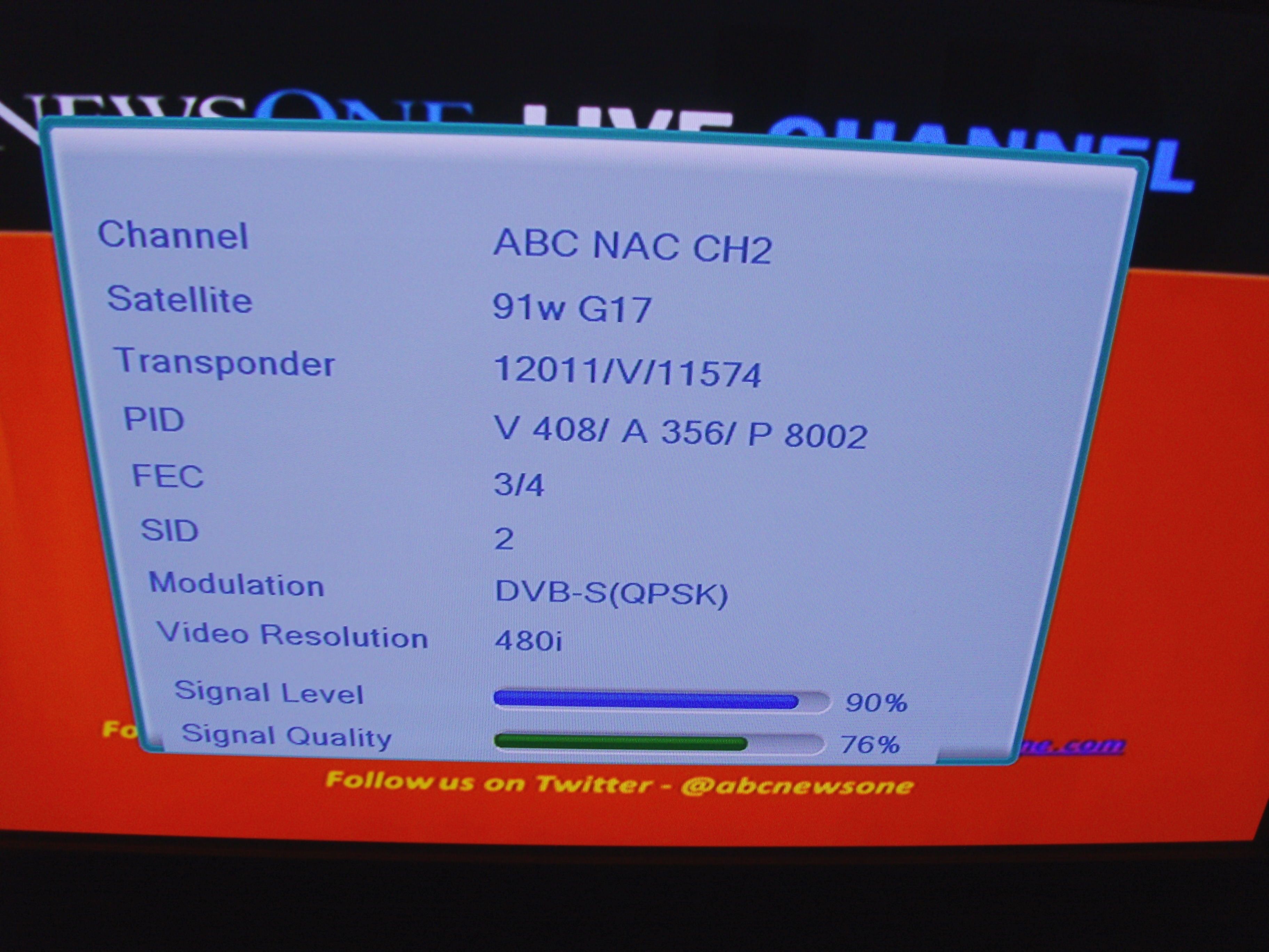

also minor cosmetic thing. When you press info twice to see all the "guts" of the channel its too long so the screen runs past the bottom line. Needs to be shifted up slightly
edit: added picture
