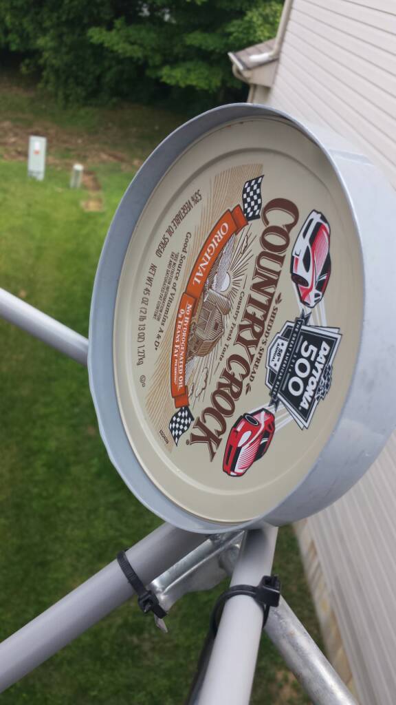

Here is a new pic of the LNB cover I attached today, after I rotated the LNB electronics right side up and drilled a small drain hole in the back. This is the cover Danristheman is using for his setup, I did not notice any signal loss at all, and applied some polish to keep the rain beaded up on it. Be sure the cover indicates Indy 500 and Vegetable Oil on it, otherwise it won't work. :-D You can zoom up to look at the Ouces, so you know what size tub lid to buy at Walmart. :-)
