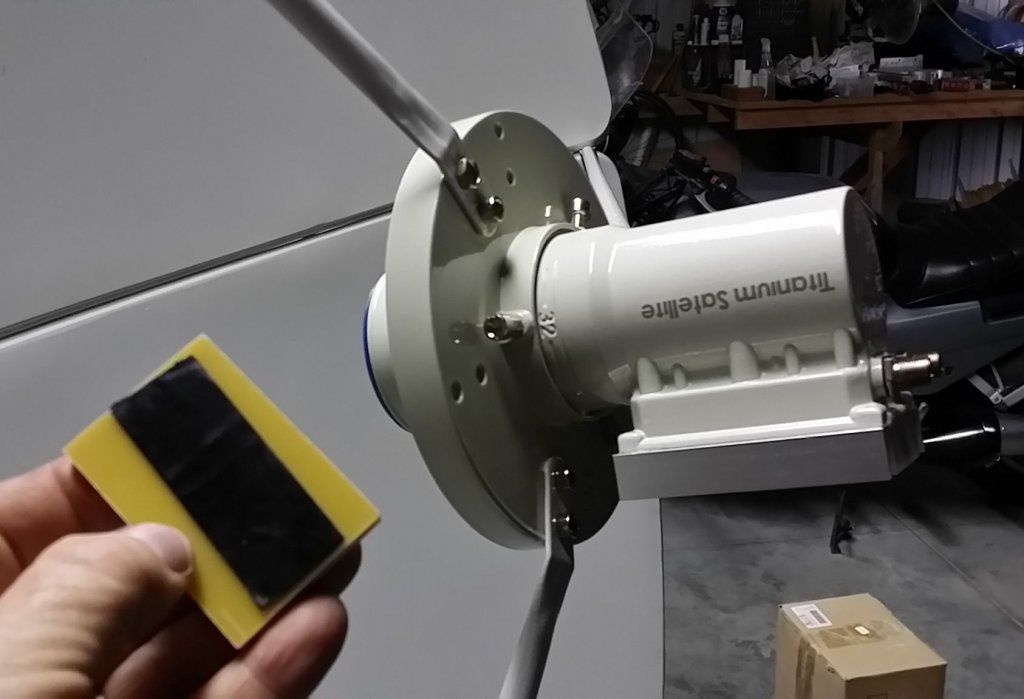

I have assembled the dish in the garage. It's resting on a short pole. I have included a picture of what looks like a fiberglass wafer of some sort that came with the LNB.
Not sure what it is. No instructions in the box.
Any ideas?

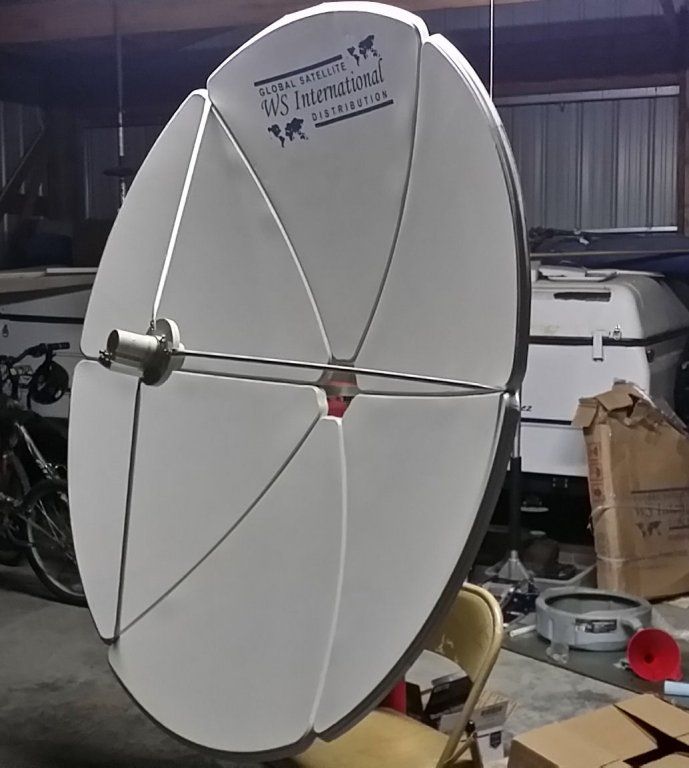

Here's my dish.
