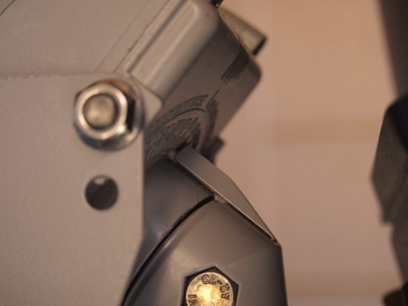

After spending a good week or so getting my NPRM perfectly plumb, I put an HH-90 motor onto my 90cm dish (GeosatPro). All in all, the process was much easier than I expected. I made sure to follow both the guide in the sticky and the manual that came with the motor. I figured since people here like pictures, I could also play with the macro filter for my camera.
A few things I noticed while installing:
The motor tube was awkward to get into place, mostly because it has (1) a little lip on the bottom, and (2) a tab on the top.

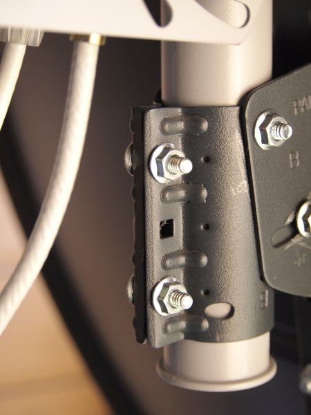

I removed the two bolts on the back of the dish clamp and lined up that tab with the back. It was still a really tight squeeze, so I used a flathead screwdriver to pry a little more wiggle room out of it. It's a tight squeeze, but the two pieces will fit together. I put in the through-bolt then the bolts on the back of the clamp, trying to keep it as straight as possible. Then I put the shaft onto the motor, followed by attaching the reflector and arm for the LNB.

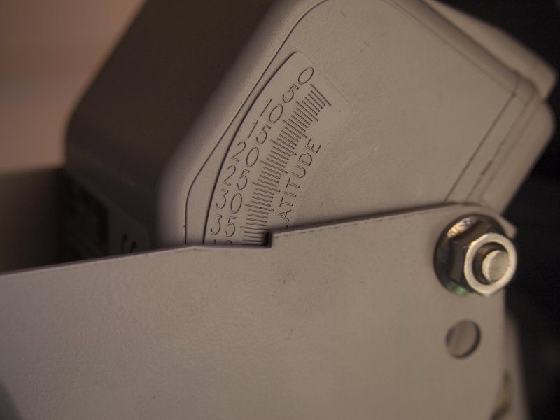

I thought I'd screw up the motor and dish elevation settings, but it was simple. Latitude is latitude. The manual states that the dish elevation setting is the elevation of true south-(45-latitude). 44.7-(45-39.1)=38.8
Like KE4EST mentions in his guide, don't over-tighten the bolts. I did have to adjust slightly east/west until I had a good signal on a near-south bird, then sent the motor to each bird to scan. Some very slight adjustments and BAM, 83W-125W come in.
I also learned not to under-tighten the bolts. We had some strong winds over the weekend, with gusts hitting around 60mph. This was strong enough to rotate the dish slightly on the pole, juuuuust enough to take out some of the weaker transponders.

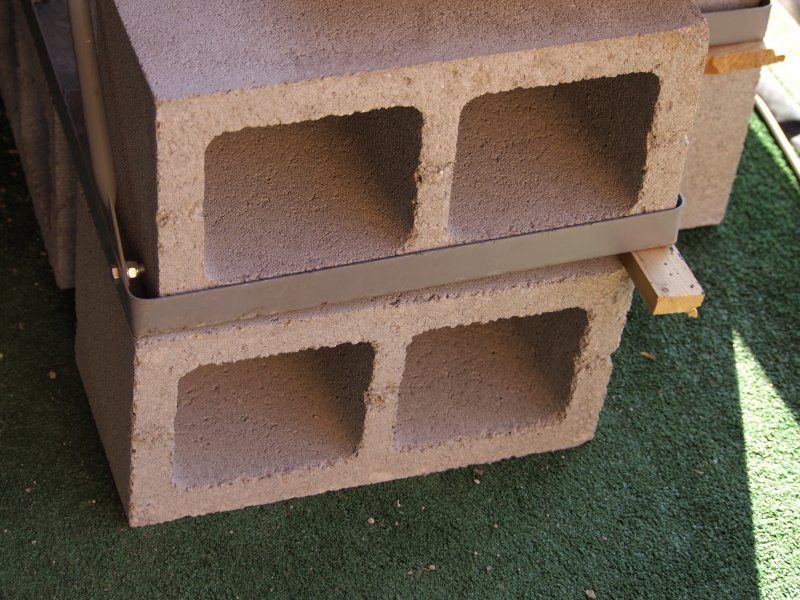

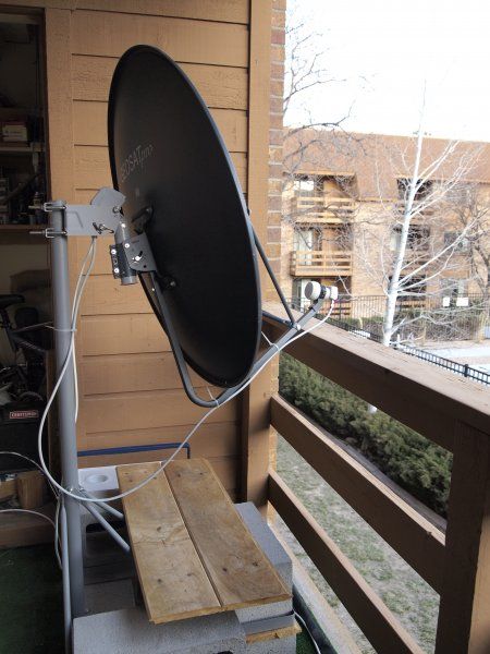

The hardest part of all this, of course, was making sure the pole was plumb. The dish is on a tall-ish NPRM from Craigslist. Once it was perfectly plumb and everything installed, I realized the railing was a major issue. The post on the NPRM is tall, but not quite tall enough to deal with the railing. I grabbed a few cinderblocks and brought the dish high enough to move freely.

I have found on a couple of my motor installs that slightly under-tightening the clamp bolts might have saved a motor or two. My 1.2m dish cracked the HH120 casing during a high wind event, where if the dish had slid a bit on the mast the motor might have survived. Wonder if there are actual torque recommendations for these clamps... as for when using a real torque wrench? :)
Yes, but no indication of grade on many of these "U" bolts... and the stamped metal clamps & brackets are easy to crush from over tightening. I would expect the required torque would be less, maybe half that or less for the same 1/4" non-graded "U" bolt through a clamp assembly... Then some are metric, and some use 5/16" bolts and better clamps (1/2" wrench size nut).
Point is to be careful when tightening these assemblies, not to over tighten, or damage to the mounting brackets can result, making it difficult to aim the dish/motor properly.
6 ft-lbs for a grade five bolt
Things seem to be stable for now. No major winds, and no problems scanning 83W-125W. I was even able to scan in a couple of TPs (no services) on 72W. It looks like I'm tracking the arc well, at least until the next big winds come.
