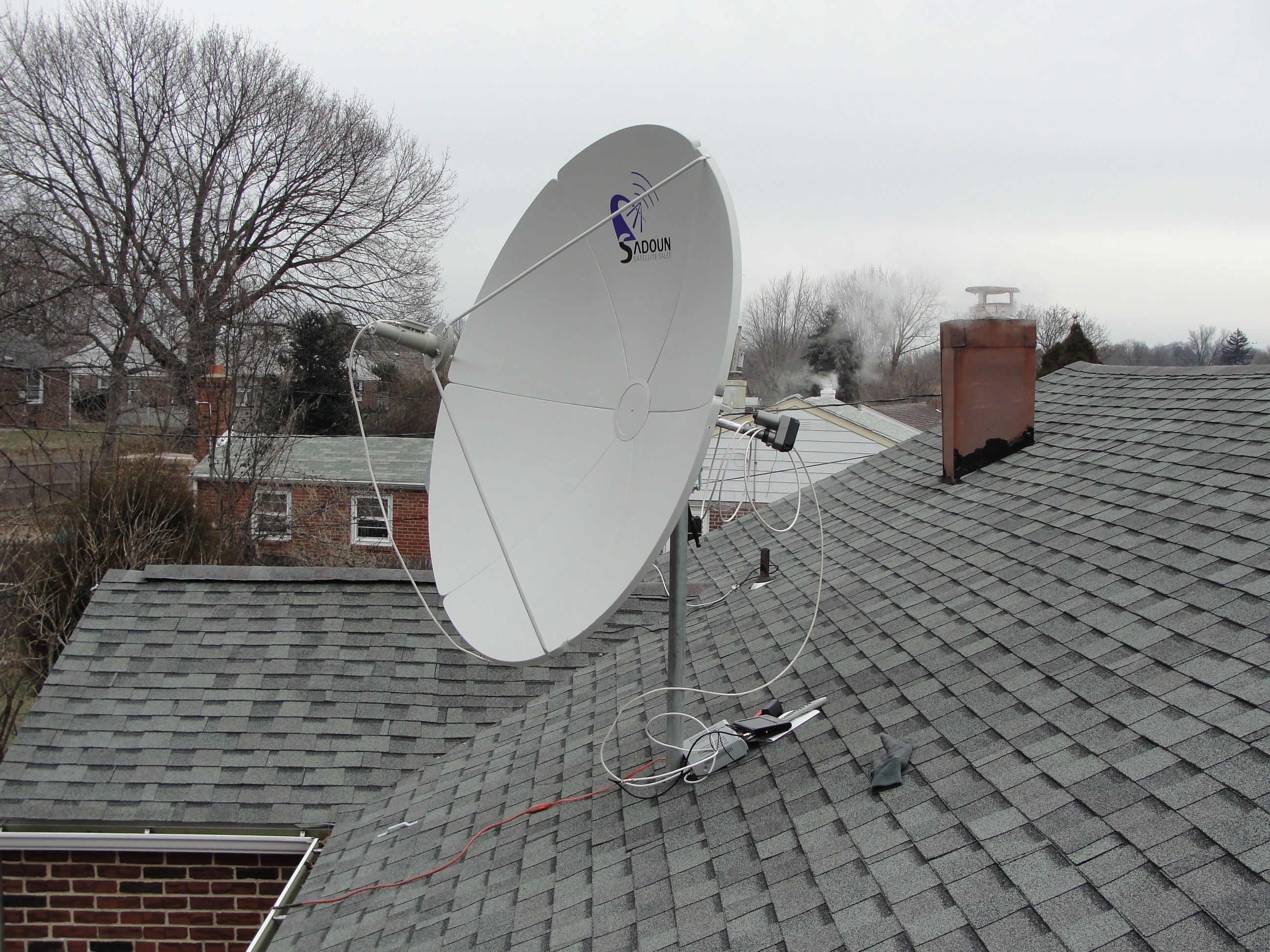

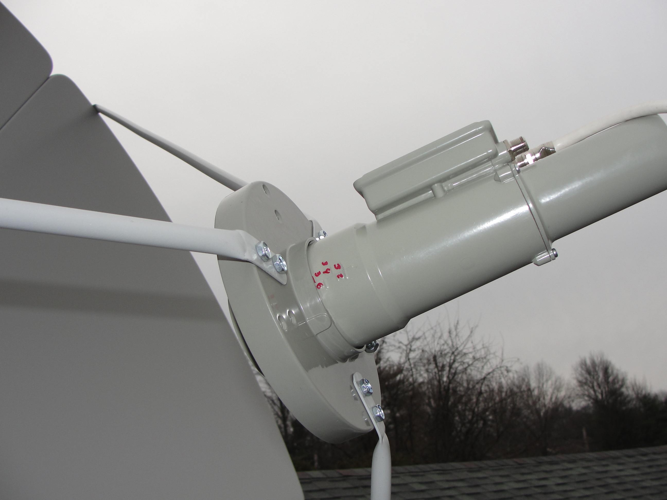

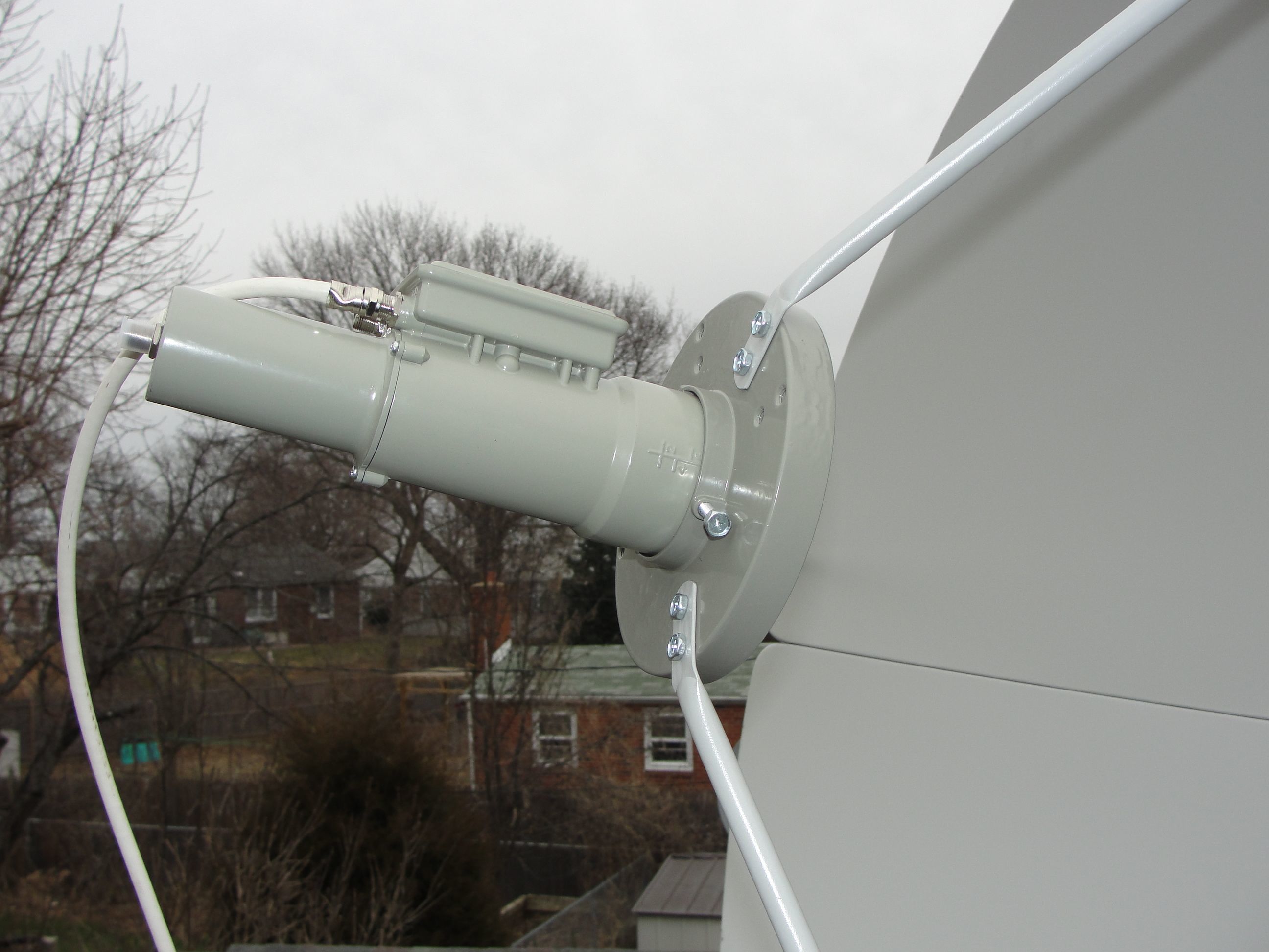

I seem to be shooting in the dark here unfortunatly, so i figured taking a few pics of my setup to give a better idea of whats going.
If anything helps as far as alignment is concerned, im near Philly, PA.

Alright, an interesting method which i read and figured i would try is using the analog receiver to align the dish. Since CSPAN is on that satellite, i was able to align it in such a way that I am able to receive that channel, although, its i would say its quality is around (roughly) 80% with some snow in the picture. are there any tips on cleaning up the signal some more so the channel is 100% and receive all the digital transponders as well ?

Now the V and H issue , a wild guess, make sure in the LNB or Antenna settings , LNB Power is in Auto or V/H or 13/18V instead of being fixed on just 18V or H polarity. Since you do not have another receiver connected like B.J said I can not think of something else.
Also looking at your LNB picture , it appears that you connected the coaxial to the wrong port. Just double check that one just in case. I beleive that LNBF has a 22 khz switch inside to select either Ku (22 Khz ON) or C band (22 Khz OFF)
cc, snow in analog picture could be lots of things. Improper elevation, east/west alignment off, skew isn't adjusted, focal distance wrong. Start with slightly pulling up on bottom of dish, and watch the picture for improvements.
CC, Remember that on any one of those satellites there's not much to watch. 135W Bloomberg, HSN, 133W Classic Arts, 131W QVC....just a couple on each of them. Lock on to one of the channels and try adjusting your LNB also. Slowly turn it left and then to the right to see if your signal increases. Also moving the Lnb in or out may improve things. I've been able to move the lnb in or out 1/8" and it made a world of difference. Basically a trial and error thing. If your looking for a bunch of channels to play around with try 121w. There's a bunch of them up there. Sportstime Ohio and Jewelry Tv usually come booming in here. A lot of it is just adjusting and tweaking a little at a time. Make sure you mark your settings with sharpie pen or similar marker, that way you can go back to the beginning if you mess up. Most of us have spent hours playing around trying to get that perfect signal. Blind
