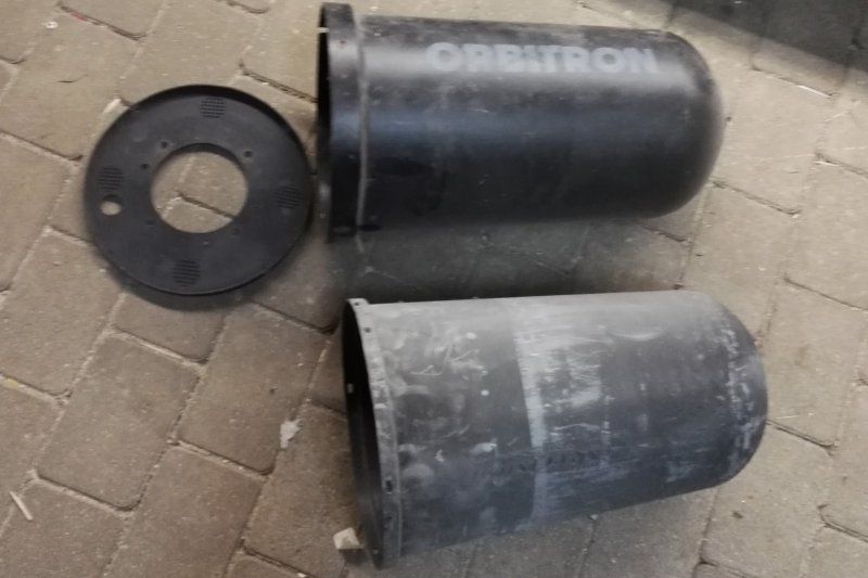

I'm trying to find a feedhorn cover but not having any luck. Any Ideas on where to get one? Most sites are out of stock.
Are you speaking about such a covers? IMG_20170415_171617 (Large).jpg You can have them both for a price of couple of beers plus shipping. Nice renovation work BTW. If I were you I would make feedarms out of stainless steel, it looks better and never rusts.

Yes, that looks like the ones. I have an idea that I'm going to try. If it doesn't work well, I'll reach out to you to see if you still have them. Thanks!

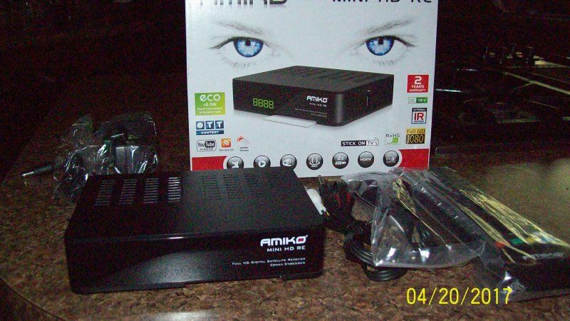

I received the Amiko MINI HD RE yesterday. Quick service and thanks again KE4EST!! Wife is a writer so she took the pen! LOL. I'm hoping to get ever thing set up this weekend.

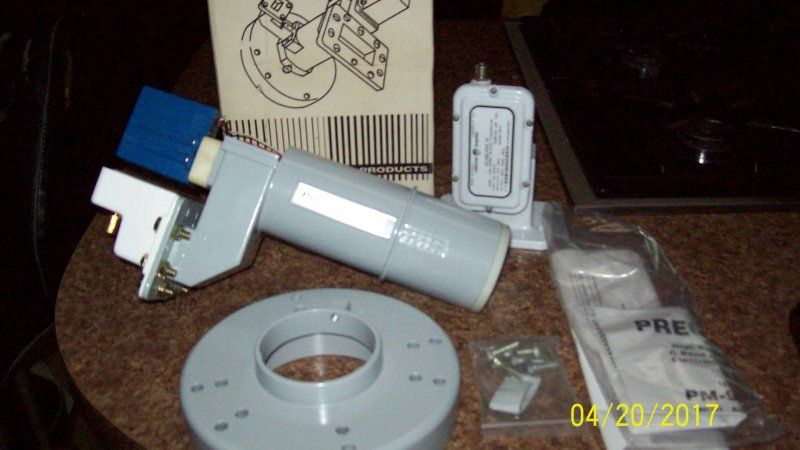

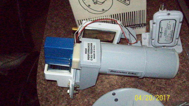

Also I couldn't pass up what I thought was a good deal on ebay and it came in today. It's a new (never been used) Astrotel feedhorn with servo, 1 Ku lnb & 2 C lnb's. Not sure of the status of the stuff I have that came with the dish. So I figured it best to go with a new unit.

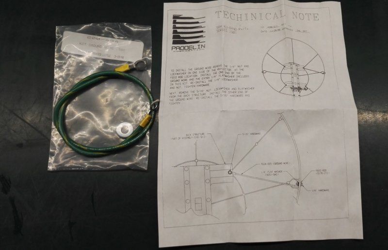

I have 19 y.o. Prodelin 0.98m Ku-band Rx?Tx Series Antenna System (actually never used), so there is special wire and instruction how to install it in the set. I do not think I will be installing this cable, but, anyway, it is there. IMG_20170423_222058 (Large).jpg

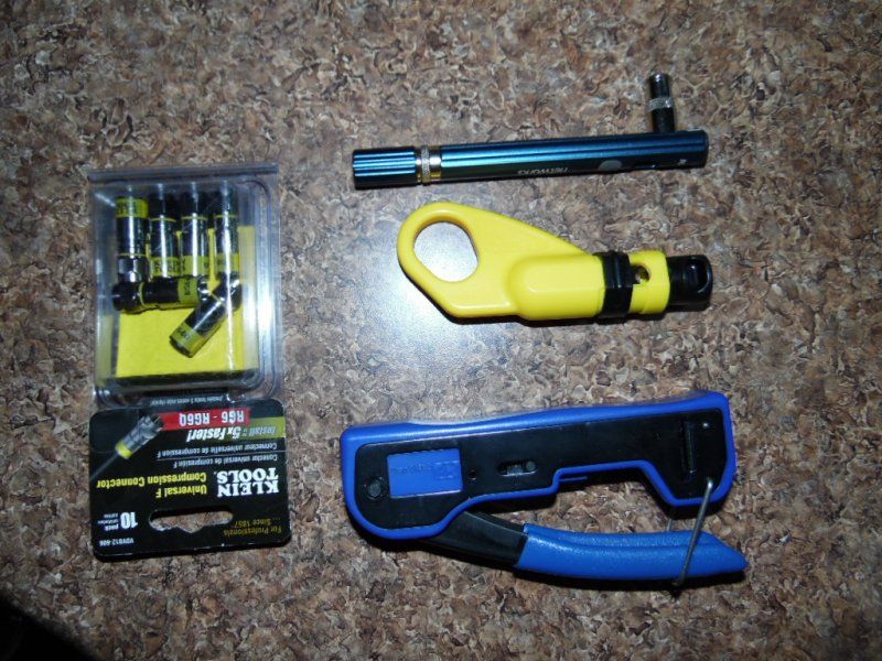

Found the short Sunday. It was at the terminal block at the actuator. I used my battery charger to move the dish and set the actuator limits to maximum East & West. It seems to be in great operating condition. I invested into some tools (stripper, compression tool and toner/tester) to make sure the coaxial's & ends were good to go. A worthy investment to take the guess work out and make the job a breeze IMO. I used 18-AWG RG6 Quad shield coax and some quality compression ends.

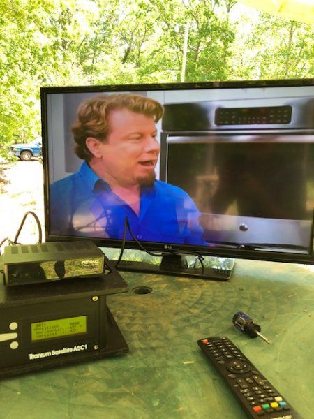

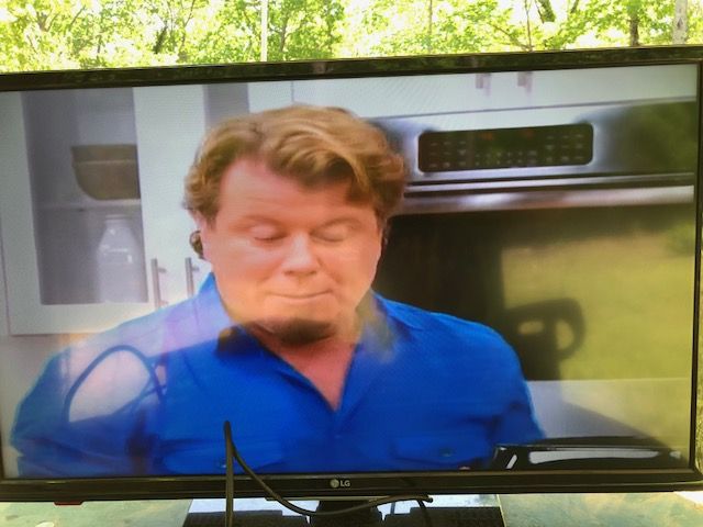

FINALLY!! Found the issue and locked in on 87W. Oddly, it was a grounding issue. The controller does not like earth grounding. I had the rods supports to the feedhorn grounded to the dish supports and post. Once I disconnected the ground, the controller would work with the LNB connected. I'm getting both C & KU on 87W. Next task will be to program it and fine tune the arch for the other satellites.
