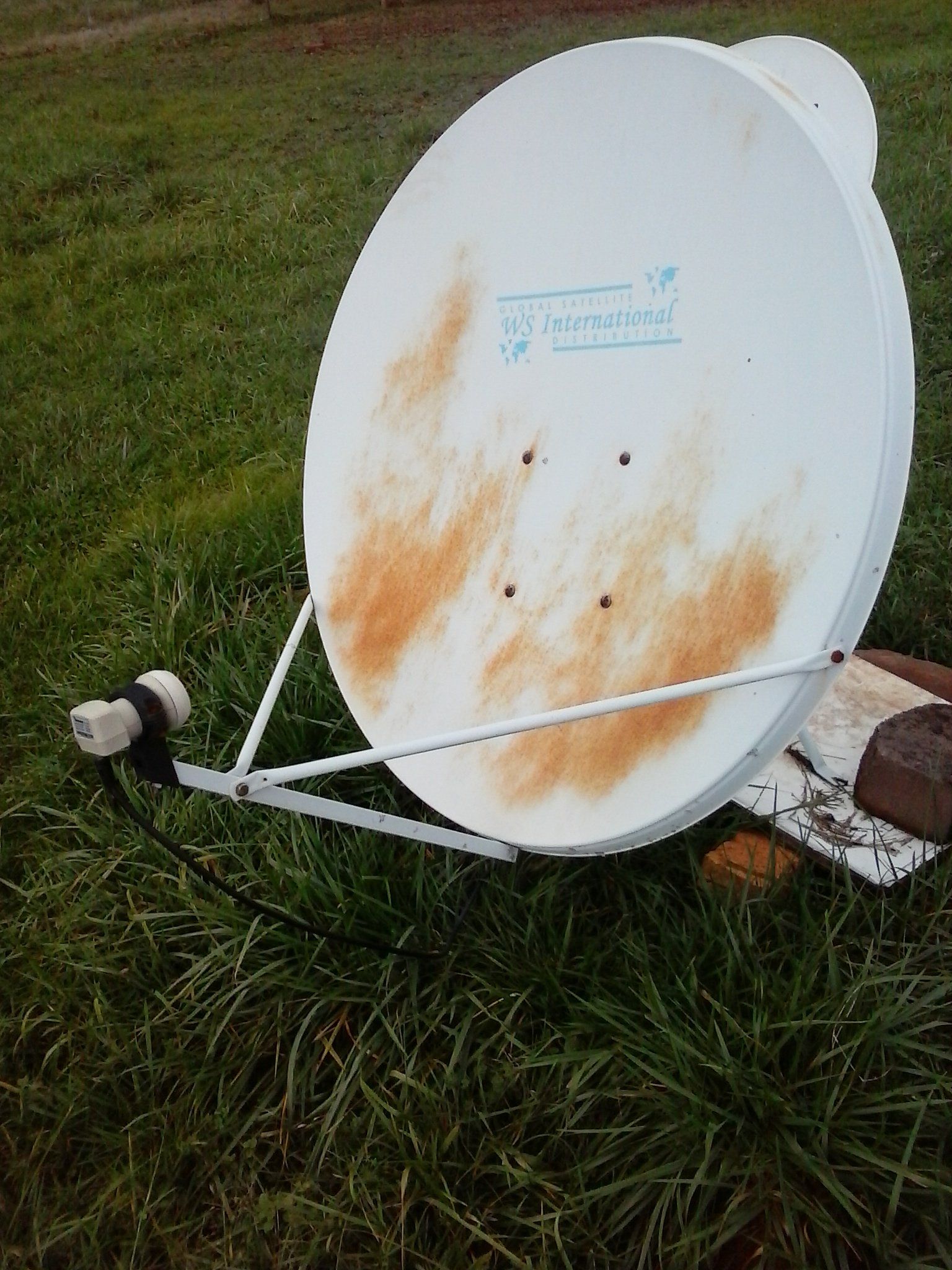

My dish is looking a little sad. Is there a special type of spray paint I should buy, or will a nice neutral colored flat/matte finish work well?
I've been satisfied with Rust-oleum products. I'd sand all the rust off, hit it with compressed air and wipe with a lint free cloth damp with denatured alcohol, then spray.
