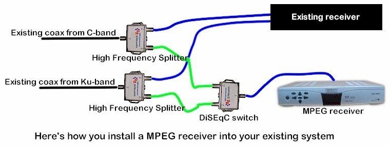

The HTS receiver can be used for motor control, and to switch H/V polarity if you have a servo-controlled feed (like a Chapparal Polarotor or Corotor). You can also receive the remaining analog channels/feeds with it.
Both of the Coolsats will receive C-band but neither will control the actuator (motor) on a BUD.
To use the equipment you have you should probably slave one of the Coolsats to the HTS and go from there. Look at the attached pic... "Existing receiver" = HTS, "MPEG Receiver" = Coolsat. You can ignore the Ku references if you are going C-band only.

Thanks for the info and diagram, I seen the name Chaparral on the LNB and it is a C band only. Maybe I might up grade to a C band/KU band LNB if the motor is in working order.
